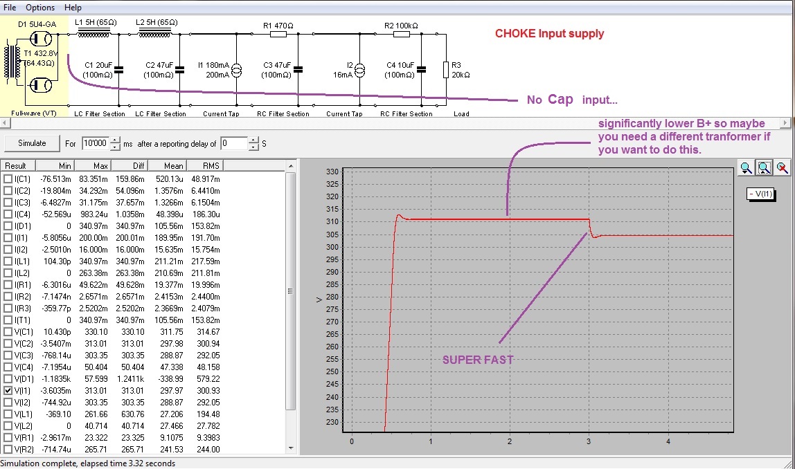

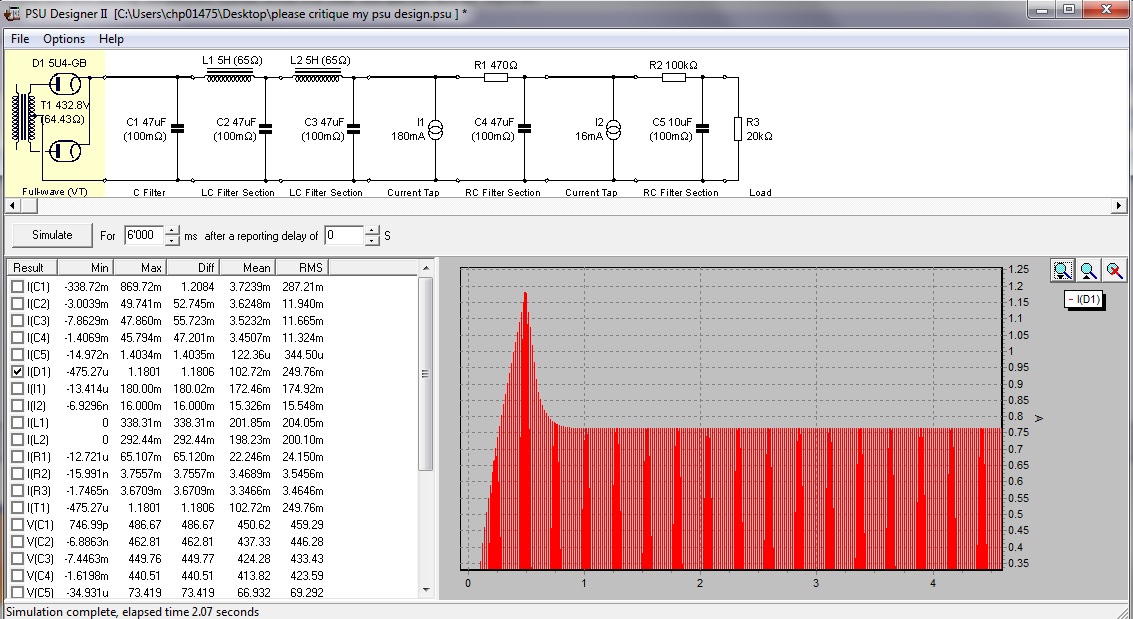

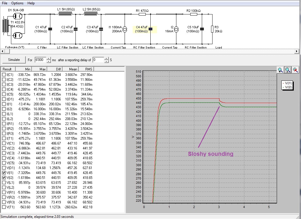

Here are some quick PSU II examples.
I basically re-created your supply as planned. Added a 100k shunt since you will want to do that in any case. You don't want those caps left holding a charge after you turn it off.
Then I created what a simple choke input supply might look like. Yes, the B+ is far lower, but then you need a different mains transformer. The sound will be MUCH better.

Seriously. been there, done that. choke input will be about 1'000x better than cap input.
I just simulated a choke input supply using Hammond 282X and get a B+ of about 412V. However I still don't like the current draw... I still see peak currents over 300mA at the rectifier. Of course with your posted cap input supply, the peak currents are much higher than even that (over 750mA). What is the Transformer rating again?

Ok, so I did a nice example of choke input for you to see why it is desirable.
Please not "sand is better" comments from the sand PSU gurus who also lurk in these waters... 😉
oops I was wrong. Its much worse than what I wrote in these screenshots. 200ms settle time for the cap input supply is more like it. That will not sound good...
Even the choke input supply is 50ms, which I still don't like. I would suggest 20ms or lower is nice to aim for here.

Starting simple would make sense if the power supply cut the mustard. It doesn't. A quick simulation in PSU-II shows that the cap input supply as suggested for this circuit results in steady peaks over 700mA. The transformer is rated for 230mA.
The steady peak current draw for choke input supply would be significantly better at just under 300mA. But its still too high.

For full wave capacitor input load: I d.c. = 1.0 x SEC I a.c.
I see in post #23 that RMS current is: I(D1)rms = 259.78m
