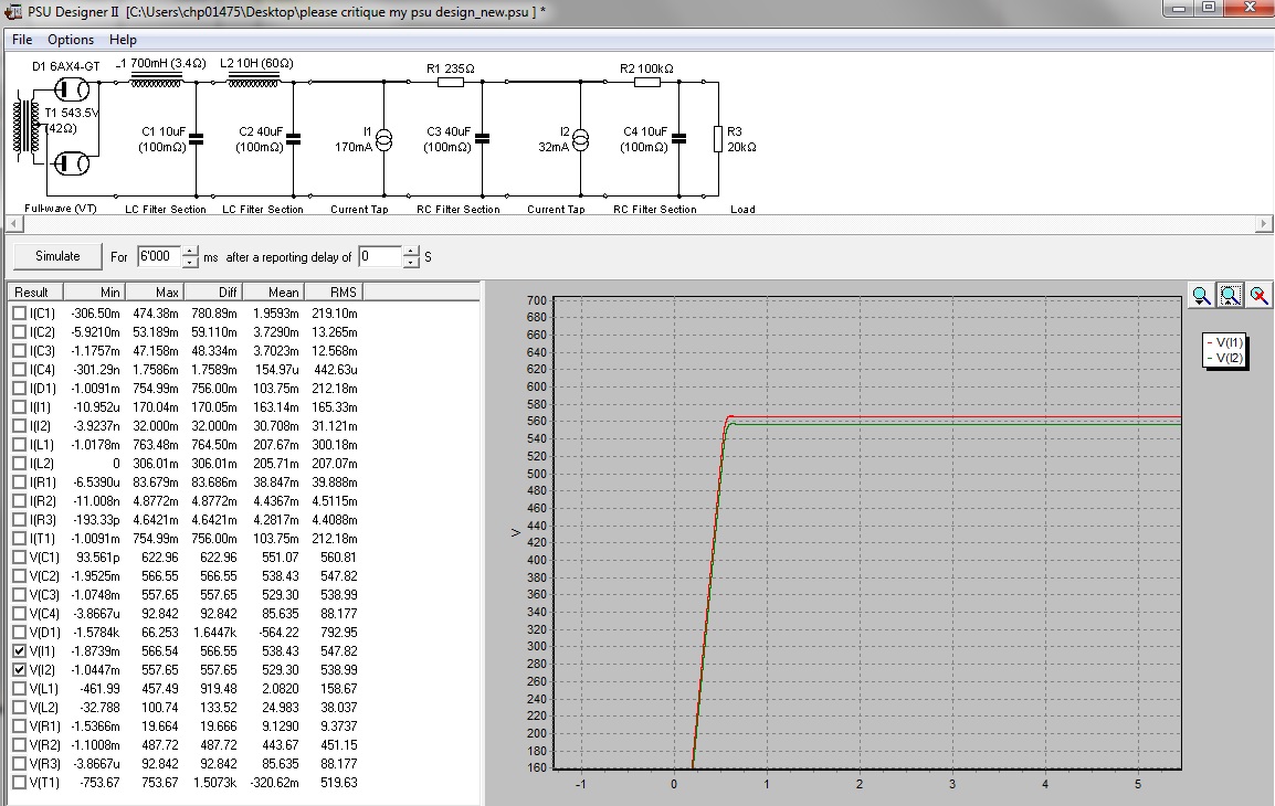

Using the stepped load in the PSU simulator is changing a DC condition.
Now monitor a class A amplifier's power supply DC current draw during normal listening conditions. It stays relatively constant, hence using a stepped load in Duncan's PSU software tells you nothing useful for a Class A amp.

Based on Soulmerchant's advice and lots of reading at VinylSavor's blog I'm pretty sold on choke input.
In searching for power transformers I failed to appreciate that my mains voltage (124-126VAC) is going to significantly alter my secondaries. I'd like to use the Lundahl 1651--it's spec'd at 500V unloaded without a CT rated from 115V on the primary. It's also generously overrated at 430mA. Given my increased mains voltage this puts me at 543.5V unloaded on the secondary. It also offers four additional 6.3V filament taps, so I'll only need to buy one additional filament transformer (two taps for the 300Bs, one for both drivers, and two for the 6AX4-GTB bridge). I'll likely have to use voltage dropping resistors on the filaments due to the increased mains, putting me at about 6.8V.
I'll use a Lundahl 1673 for the input choke (10H, 200mA recommended, saturates at 290mA), followed by maybe a cheaper Hammond choke or another Lundahl, I'm not sure yet.
Does anyone foresee a problem using this setup? My primary concern is that I'm depending on my elevated mains voltage to boost the secondary to 543.5V unloaded. Dipping any lower puts by B+ under 400 VDC and I'd rather not go that low for my 300Bs.
You can use a graetz bridge (i.e. virtual center tap using silicon diodes) and two damper diodes and two silicon diodes. I do this all the time (not because of the cost, because I am too lazy to put in so many sockets).
To simulate a graetz bridge, I use the full wave rectifier option in PSU - it measures pretty close to a "full wave" rectifier in my experience.
I like the lower input cap in your simulation. Hammond chokes can work too, but I prefer Lundahl. Thomas has his own line of mains transformers, and I find them to be excellent quality and easier to work with than Lundahl. They might even be cheaper too..
I like to use a smaller value first choke, then a not-too-big C1, then a bigger filtering choke followed by bigger C2.

But aren't we that far?? If you're simulating changes in the amount of current being drawn by the power stage, then you should be taking into account the output transformer, and its stored energy. The anode of the power tube is connected to one side of the primary of the output transformer, B+ is connected to the other side of the primary. Current drawn by the power stage is via the output transformer. The B+ supply is only part of the equation, and so simulating what will happen to the B+ supply without taking into account the output transformer and its stored energy doesn't really tell the whole story in my opinion.
Hoj
I agree with you! But look at the original poster's post and explain how he can put his the OPT into PSU-II. 😉

You're right. He can't put them into PSUDII.. And so all I'm saying is that simulating changes in current with PSUDII isn't really simulating what will happen in the amp..
