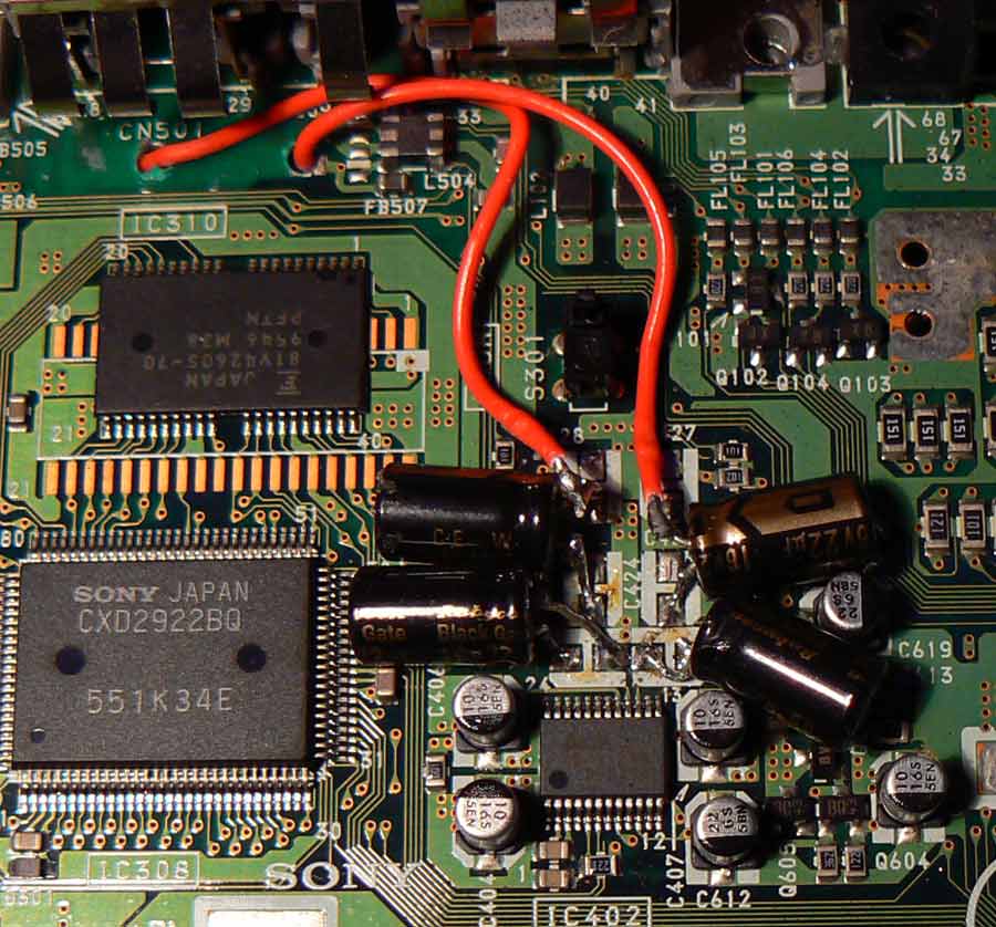

I decided to do the Mick mod. Is it possible to do it without the HP filter (3,3µF, 22kOhm) because my preamp has one?

Hi folks
operation has been a success. I did the Mick F. output mod but without the decoupling caps and Rs. Directly from 4309 to cinch.
Sound improved but now AV multi out isn't working anymore. I just removed the first two caps not the other 4.
So what, sound is good but I have to compare the next days again.
