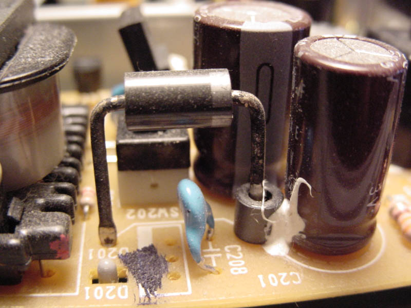

I wonder, for those who still have your original SMPS's, how prevalent a RF-suppressing ferrite bead is on the main Switching diode. I've an early (july 1995) 1001 and a late (1996) 1001, and the earlier one has a ferrite bead (and a larger PS cap) while the later one doesn't (didn't, just put one in).

Actually, I'm talking about on the high-speed switching diode.

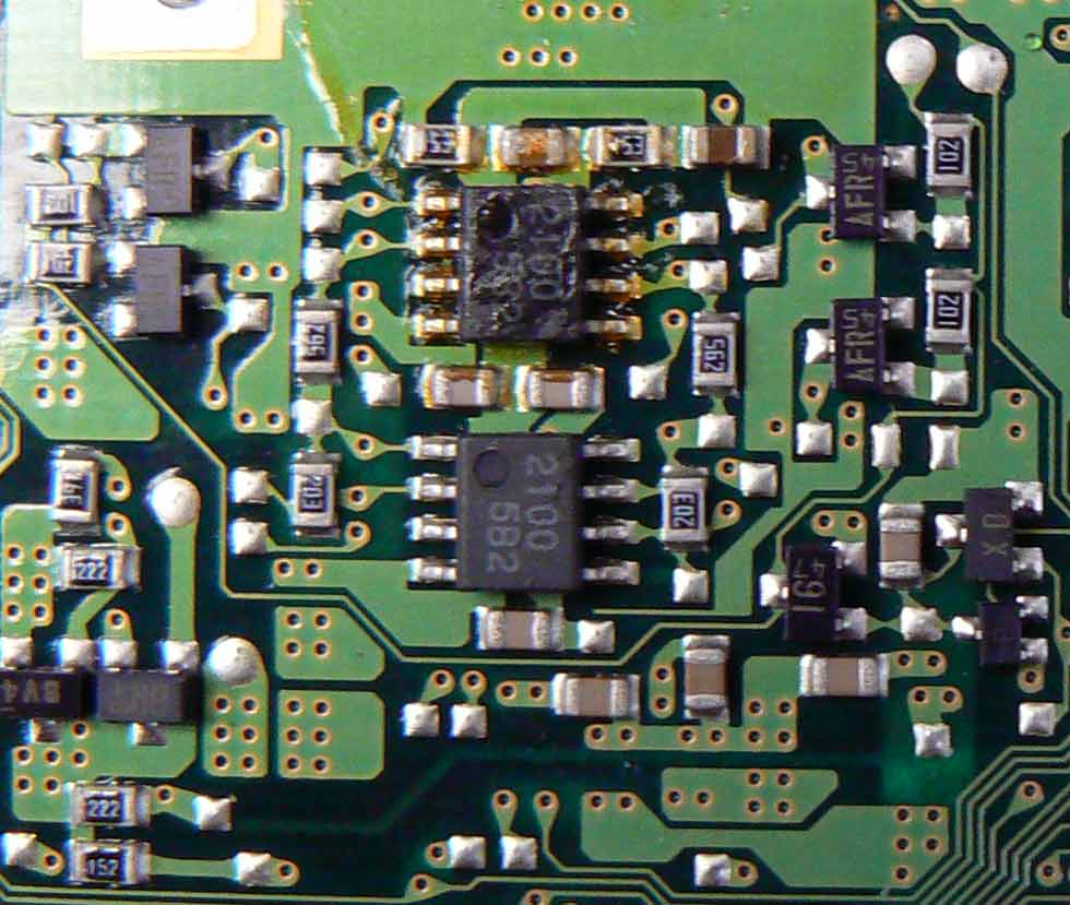

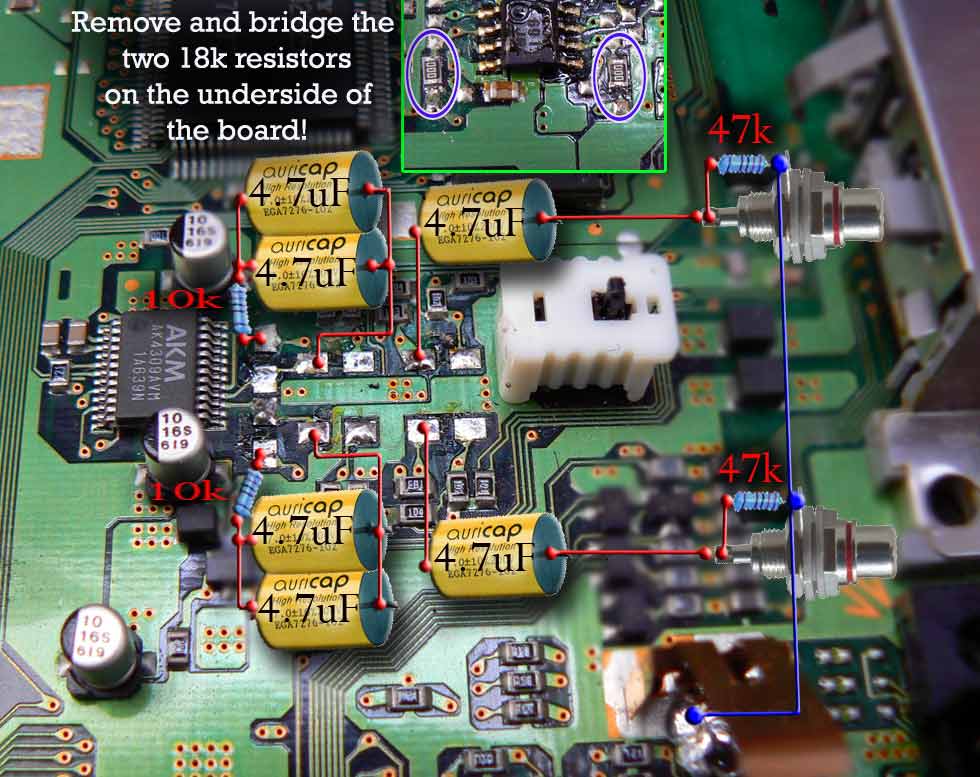

I upped the output by 80% by just changing the op-amp input resistor from 18k to 10k.
I am now trying the same thing with better caps and keeping the original op-amp. Bypassing the muting circuit though...I don't know if it was tried at the beginning of this thread?

audio1st: yes, don't waste your time trying to improve the original circuit. I wouldn't say because of it being SMD... it's just that it is too complex (long signal path, many components in between or attached to it), and the opamps are crap... so unless you take out all the other components and substitute the opamps with good ones, it won't be worth fiddling around with SMD...
Tolu, I think between the ADC and the AVout is only one opamp... but it's the same crappy model as in the RCA out... just that it's only one stage and there are, as far as I saw it, no other components in the way, that must be why it sounds better...

Like I said, I changed one resistor per channel and now have about 2V at the output. It won't be as pure as the common minimalist route, but it may have more grunt when using it with an amp with a passive-pre...

I went this way for two reasons: gives me the standard output level, and the opportunity to choose the output opamp, circuit and components I like.
Compared to the original PS (using the RCA out) I am convinced there's improvement in the sound, not related to the volume. That's pretty logical, because the signal goes through a crappy 2100 opamp and a few other components to reach the RCAs...
Comparing to the AV out, it can't bring any improvement on the sound, only in volume; as the AV is almost the same as taking the output directly from the DAC (except for two additional caps and the muting transistors). Yes, audio1st, afterall you were right, the 1002 only has the opamp in the RCA output circuit, not in the AV multiout. That's why everyone reports the sound is better from the AV out 🙂
Sure, you can definitely replace the original opamp with a opa2134 soic. Or any other good opamp which has the same pin configuration and doesn't suffer from unity gain instability or so... although you won't be using unity gain anymore... but still good to play safe lol... regarding supply voltage, as long as it is above +-2.5V it's ok for the opa2134 and many others. But in case they have the NJM2100 operating at single supply +5V (I don't think so, but it's possible), you can't just drop the opa2134 or other in and have it work... you'd have to improvise a virtual gnd and split supply of 5V/2 = 2.5... you know, with a 100k divider, two caps and all that stuff? just google for it, it's common practice. But then the problem would be, how and where to fit those components... see why I think it's not a good idea to fiddle around with the original circuit?
Also, there is another important thing here to consider... aiming for a 2V peak output with +-2.5V supplies isn't really a good idea... even if the opamp has high saturation capacities... I mean, look at the original circuit, for example... it only works with 1.34V peak signal or so, which is no problem at all with +-2.5V supplies. But rising it to 2V... I don't know... It'll probably work ok, but don't ask me about performance regarding THD and other details...🙄

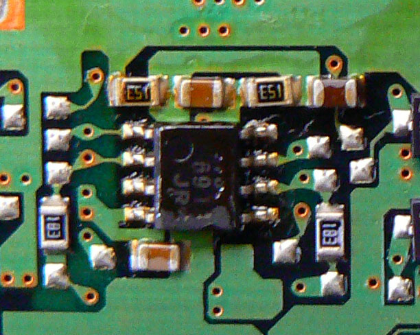

Thanks for the info "joydivision". I measured 2.5V at the pins and I guess the two 15k resistors and caps at the top of the picture are the voltage dividers. I may then try different feedback and input resistor combinations and see what happens. This is just cheap trial and error for me, if it all goes belly-up, I can always bypass the whole output stage as normal...😉

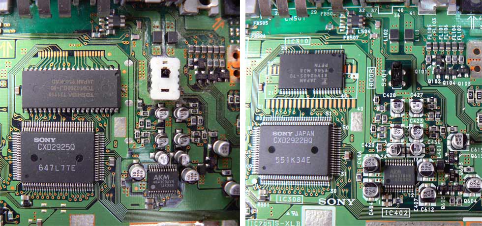

I don't know how many different versions of the 100x there are?
Here are two different versions that I have, I am playing with the left hand model at the moment but the right hand model looks better. I don't know what op-amp is used with that one. I notice the DAC's are different (4309 & 4310) with extra caps round the 4310..
