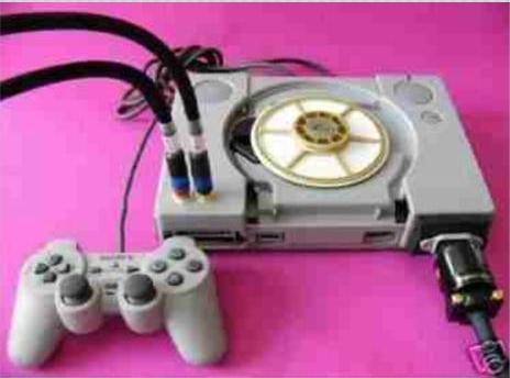

Hi
I rather like the idea of two gold
RCA's coming out above the parallel
port. I think this is a modded 5502/5522
done by Auditorium 23 in Germany some
year ago. Route the wires near to the
parallel port and use caps/resistors
and RCA's there.Could even go for
transformers if you want. there is space !

AnthonyPT said:Hi
port. http://www.auditorium23.de/
Like this one from Audio1st ?
