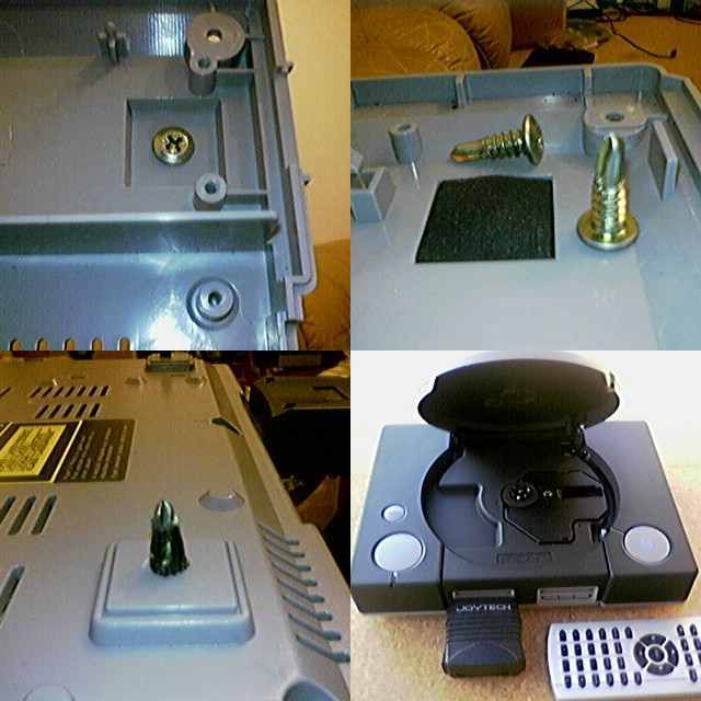

Hi
While I have a couple of 1002s
and 5502s I have only modified the
output on one 1002 with a 3.3mf bipolar
bypassed with polystyrenes. One of the 5502 unit
outputs go via a pair of Altronics transformers
600/600ohm and I do like the sound. Trannies are AUD$19 ea
and I plan to put them inside when time permits.
Maybe combine this with Mike F's 1002 output mods
sometime soon with gold contacts on the 5502s.
For me the most effective improvement has been spikey feet!
I use self tapping metal screws and then cover the tops with
felt.The unit then sits on a cork tile and under the
cork tile is a heavy Jarrah wood offcut. Under the offcut
is dimpled foam and under that another Jarrah offcut.
The sound has become more articulate and airflow improves.
I enclose some pictures and URls for Altronics Trannies.
Harza I like your reversable mod approach and maybe use
Polypropelene caps & good resistors optionally followed by
transformers in a small box on the way to your Preamp or amp.
This all using bits of the AV multicord. Perhaps later
putting in gold RCAs and blocking the AV out off all together.

Hi
Just did some more spikey feet for a friend tonight on another1002.
He has been using just dimpled foam only which
was fair but the Jarrah and other isolation
with the cork will made it much more articulate
and clean up the bass as well. I would be a bit
judicial with white grease and Mike F while I find
your tyre elegant with the cutting board those grub
screws are banned in OZ for some safety reason or
thats what a plumber told me! So Metal self tappers
with Phillips heads do well and lock down nicely.
Hot glue on top of the heads will be tried. Anyone else tried
the cheaper line tranformers? Would like to hear the
Sowter trannies such as the 9055/9762/8347.Then
it all gets a bit pricey! Have we covered balanced line
outputs for the humble 1002/5502s? My main 1002 goes to a
tube preamp with Trimax ex-ABC transformers: it sounds so good!
regards
AnthonyPT
