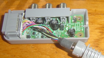

beware adaptors
The commercial Sony Adaptor for the PSone which converts the video out to two RCA ( left & right) plus composite video is not a purely straight through device. It appears to add additional components to the audio circuit. However if you make up a video out as on Micks web site (http://www.dogbreath.de ) it will be just a piece of wire

Re: beware adaptors

jives11 said:The commercial Sony Adaptor for the PSone which converts the video out to two RCA ( left & right) plus composite video is not a purely straight through device. It appears to add additional components to the audio circuit. However if you make up a video out as on Micks web site (http://www.dogbreath.de ) it will be just a piece of wire

Apologies - that looks fine to me, though worth opening up, but I guess at that price you can't go wrong. I was referring to this kind of thing
