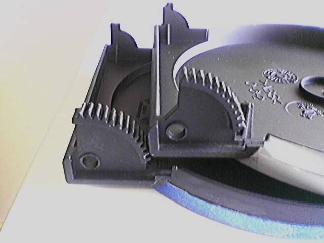

Hi
Having been painting both 1002 &
5502 PS1 models, I have found that
the 5502 lids will fit the 1002
body structures but the 1002 lids
do not fit without modification.
The picture show a 1002 lid on the bottom
and 5502 lid on top. I have found
this really nice black metallic lacquer
which looks great on the body of the
playstation. I have done some in matt
black but prefer the metallic. I am
also looking into light pipeing the
soon to be blue led for the power into
the edge of the carriage body. If it
works I will post a picture.
Regards
AnthonyPT
