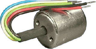

Now!.....here's the exciting part......connected to the Solens are 2 small microphone input transformers : 600ohm C.T. to 10k.
I wired the transformer by leaving the C.T. unconnected and in 600ohm input configuration.
The other end of the transformer(10k) connects to some external RCA's(one wire to the positive and the other to ground).
This has so far increased the output of the player by approximately 10db avoiding any active circuitry valve or solid state. I can detect no problems using this mod with solid state or valve amplifiers.
The transformers are available here in Australia from ALTRONICS and cost $20.65 AUS, but I have come accross the same type on the internet a while back.
