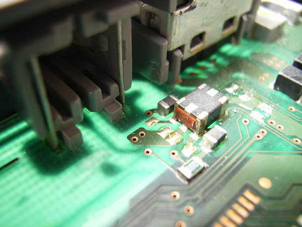

Need Help Identifying an SMD Component
I was modding the output stage of a spare Playstation One Model SCPH-1001. While I was attempting to remove a small SMD cap from the motherboard, I also accidentally damaged the larger SMD component mounted next to it.
Here is a picture of the SMD cap on the left and the larger mystery SMC component to the right. This is a photo from Mick Feuerbacher's Web site . I believe it is either an inductor or transformer; I really can't tell. It has six leads (three on one end and three on the other). All I know is that I have ground hum in both channels with this piece off the board. I might try to jumper the SMD pads and see if this will eliminate the hum.
Can anyone help me identify this SMD part? Also, I will need to know where to purchase a replacement.

Ah yes - the mysterious 1001: a playstation odyssey monolith.
This device is used when the TV connector is plugged in. It down mixes the stereo for a mono TV, and is only engaged when you use the original UHF TV connector with integral sound jack. There is some discussion of it early on in the old testament part of this thread. I would think you could remove it and jumper the relevant connections.

I usually don't read this topic anymore, but that 6-pin SMD component mixes left and right together in the L/MONO jack when nothing is connected to the right channel jack.
Thanks for the quick response guys!
It sounds as if this SMD component might not be easily accessible for a replacement. I will jumper the appropriate connections and go from there.

Might not be able to simply jump pads here
I am still trying to eliminate the hum after accidentally removing the larger SMD component that has been identified as some sort of capacitor device (3 x 15uF) used to mix down the right and left channels when the video jack is engaged (Post# 1777). So what kind of 15uF capacitor should I use to replace the connection between the "RCA negative" and ground? I would like to avoid using an SMD component, but I am not sure if a compact electrolytic will work here.
DreadPirate said:
After some poking around, found that the center cap on the larger 3x (14uF) connected the rca negative to ground and was necessary. The others traced back to the bank of capacitors, all of which I ended up removing, so they were out of circuit. All is well now. I don't think I'm ever going to bother with any mods that involve SMDs again...
It's not MONO when the video jack is connected, the PlayStation is a gaming console, and is supposed to have the TV out connected at all times.
On the RCA jacks, ground is going to ground, period. If the SMD channel mixer is removed, left signal should go to left, right should go to right, but you'll see the R jack has three pads: Ground, Signal, Switch. It detects if there's something connected to the R jack to let the SMD 6-pin switch mix the channels or not. If you get no audio output with one of the R jack pads, try the other one.
[SMD Device]mixes left and right together in the L/MONO jack when nothing is connected to the right channel jack.
