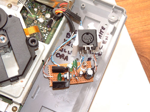

Its not the most elegant of layouts and the heatsinks still need securing to the board hence the flameproof rizla packet shim and the wobbly alignment.
This is the second stage mounted in the casing. The din plug sits under the now obsolete reset switch hole as I have a pawnshop price sticker for 10 UK pounds that had to be kept intact and the Playstation sits against a wall so no space is available behind it for wiring
Its still in lethal exposed AC wiring test mode, it will all be insulated and properly terminated before it gets boxed up. I dont want to shock myself whilst stamping out the flames.
