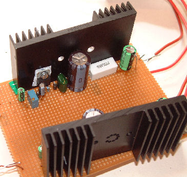

I haven't got any photos yet, it's still in "lethal exposed mains wiring beta test mode" I will take some when it's in a safer more postable state.
With hindsight the layout could have been much more compact but it's working well at the minute. The 3.6v section gets hotter than I expected, some vent holes are planned for the playstation casing above the heatsink. I can hold the sink for around 10 seconds before swearing so its not critical but the heat would be better out than in.

I'm having a spot of bother getting photos to show up on the thread but hopefully this will show the power supply.........
