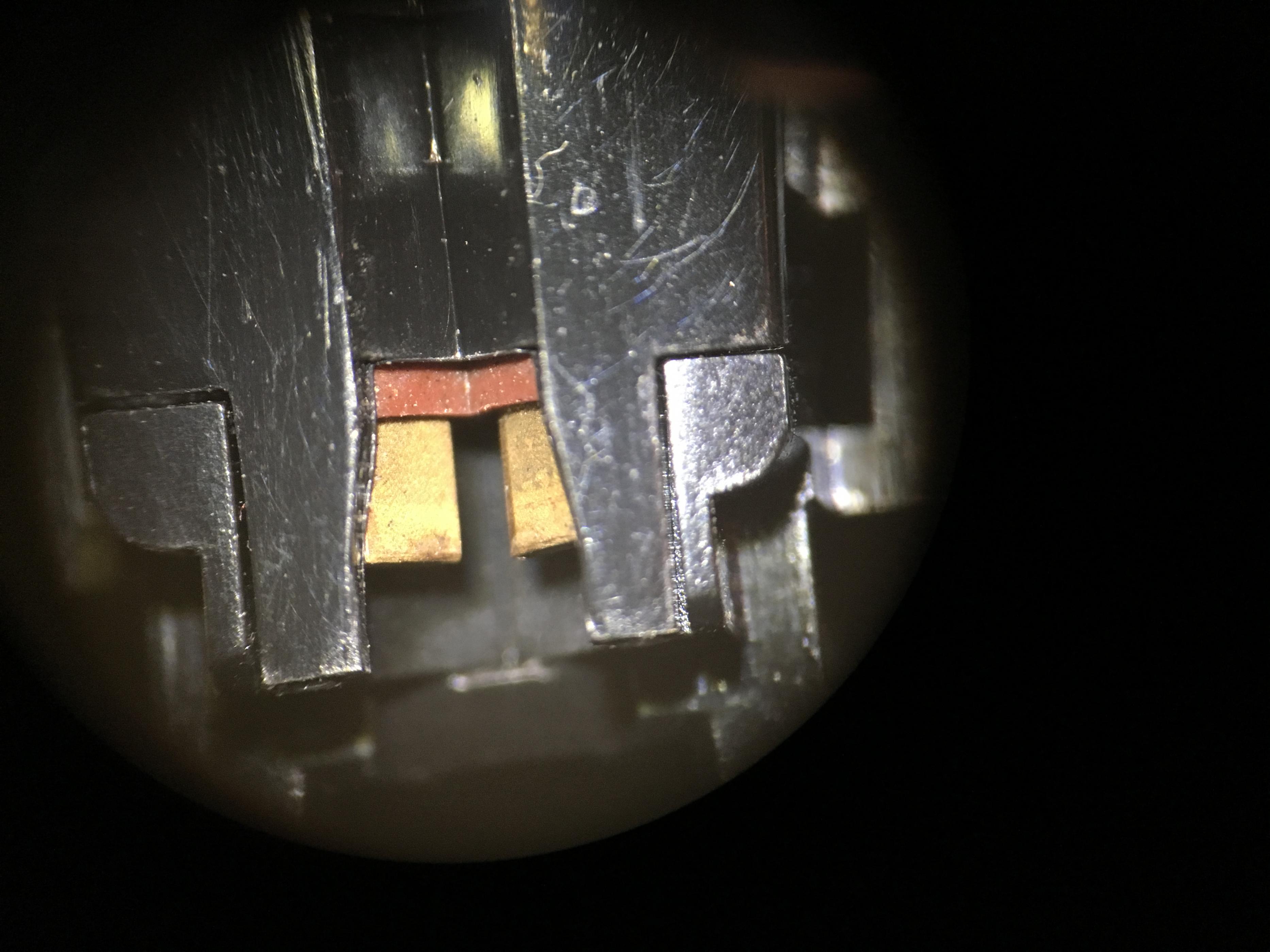

Looking at these under a scope, the only difference between the 450 c2 and 451 is how the plastic body comes forward and covers the damping blocks on the 451
At first it looks like it slightly touches them but not so. There is some space separating them.
From here, the elements look similiar to me.
That body must go and next thing to get reworked..
I will have to add the blob next session.

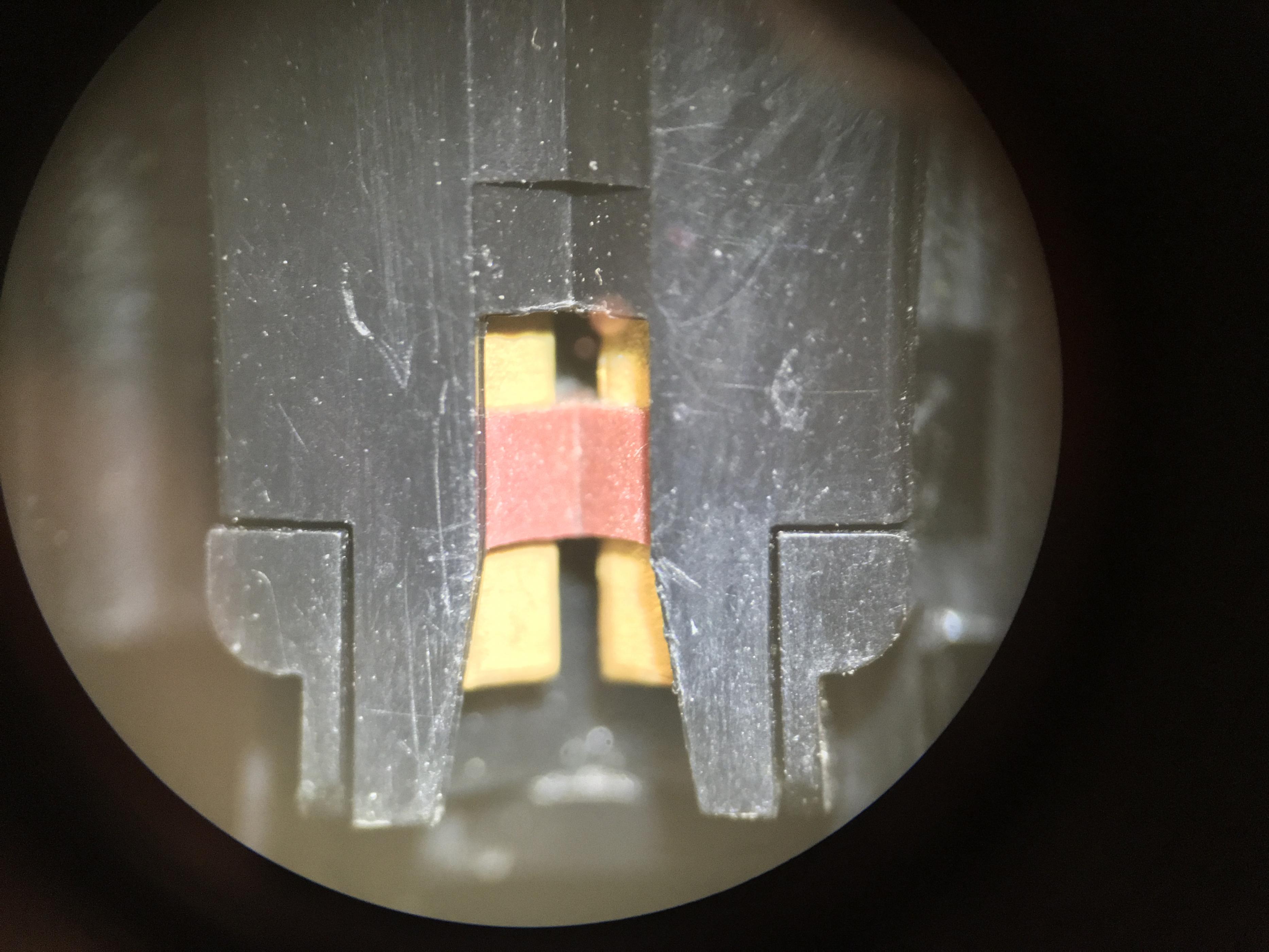

The shape of the opening is appreciably different too. I will have to take a look at mine the next time I have a good opportunity to do so.
Looking again under the scope, both measure about .0184" from edge to edge between the SG elements
Looking down on the ends, I put a square edge as close as I could get to parallel the elements and both versions are at the same angles on mine. 45/45 degrees.
If someone has a picture of Sound smiths SG with the needle removed, it would interesting to see how they capture the needle assembly in comparison and the view inside the elements
Their specs show better channel separation from the same overall design..,.

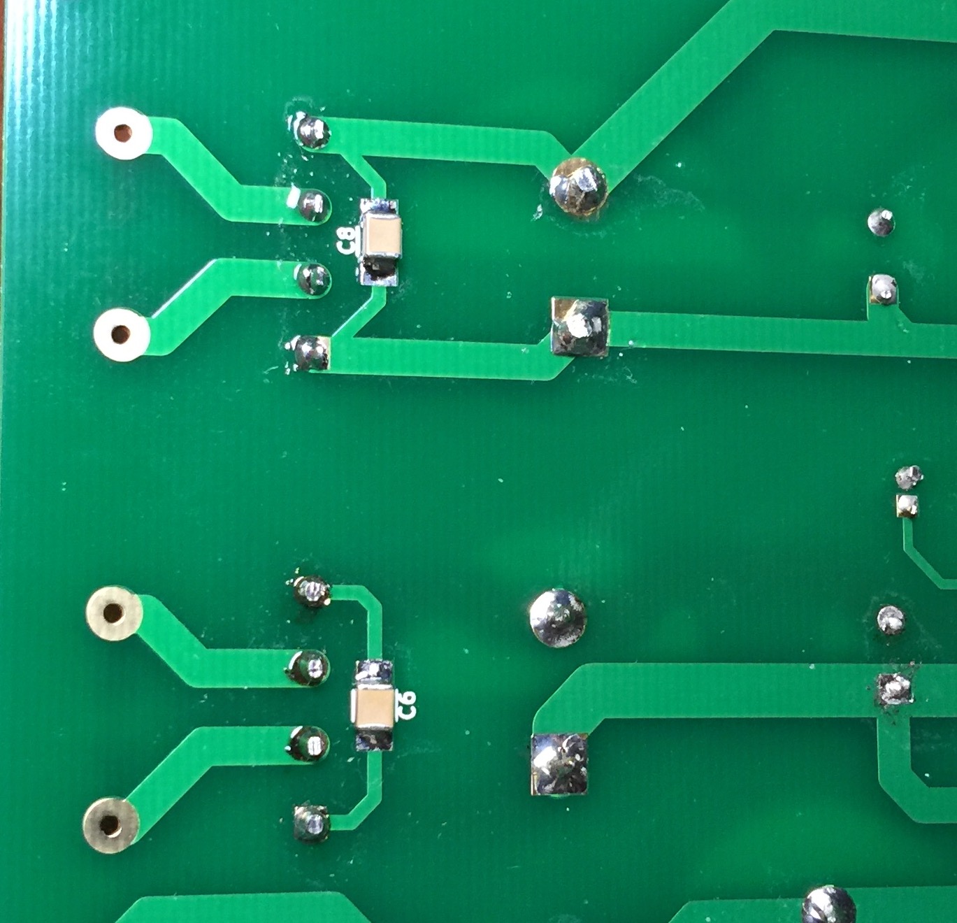

Check to make sure that no tabs are grounded on the heat sinks (but looks OK) - don't forget to remove one instance of the C8 capacitors (does not matter which one) on the filament bypass. Only one should be installed.
Edit: Double check soldering on R3 on the audio PCB on the left.
Kevin,
The C8 you are talking about is on the back of PS board? I checked everything else. They are all fine.
Thanks!
Jim
No C8 on the audio board as previously noted. Please remove one of them (not both) Only one needs to be installed per pair of boards. (47uF electrolytic on the filament circuit)

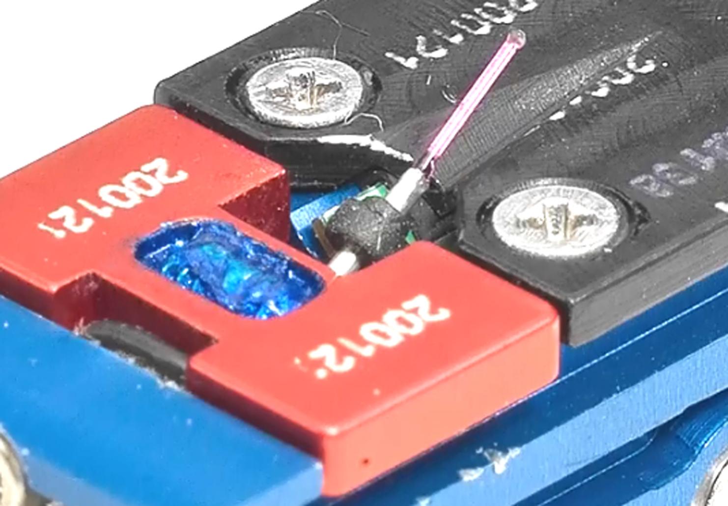

The black plate is similiar to the distance covering the damping material on the 451. Slight gap without touching
Other than the ruby cantilever , the donut and aluminum looks panasonic.
Their SG -230 system is 13k now 😡😎
A set screw pushes the needle assembly forward locking it in place.
Looks like a magnet insert ?
That rectangular area looks like a damping substance maybe ?
Need to see how the rubber end holding the cantilever is glued to its housing
The stock panasonic just sits in a glued half circle trough. No full circle capture

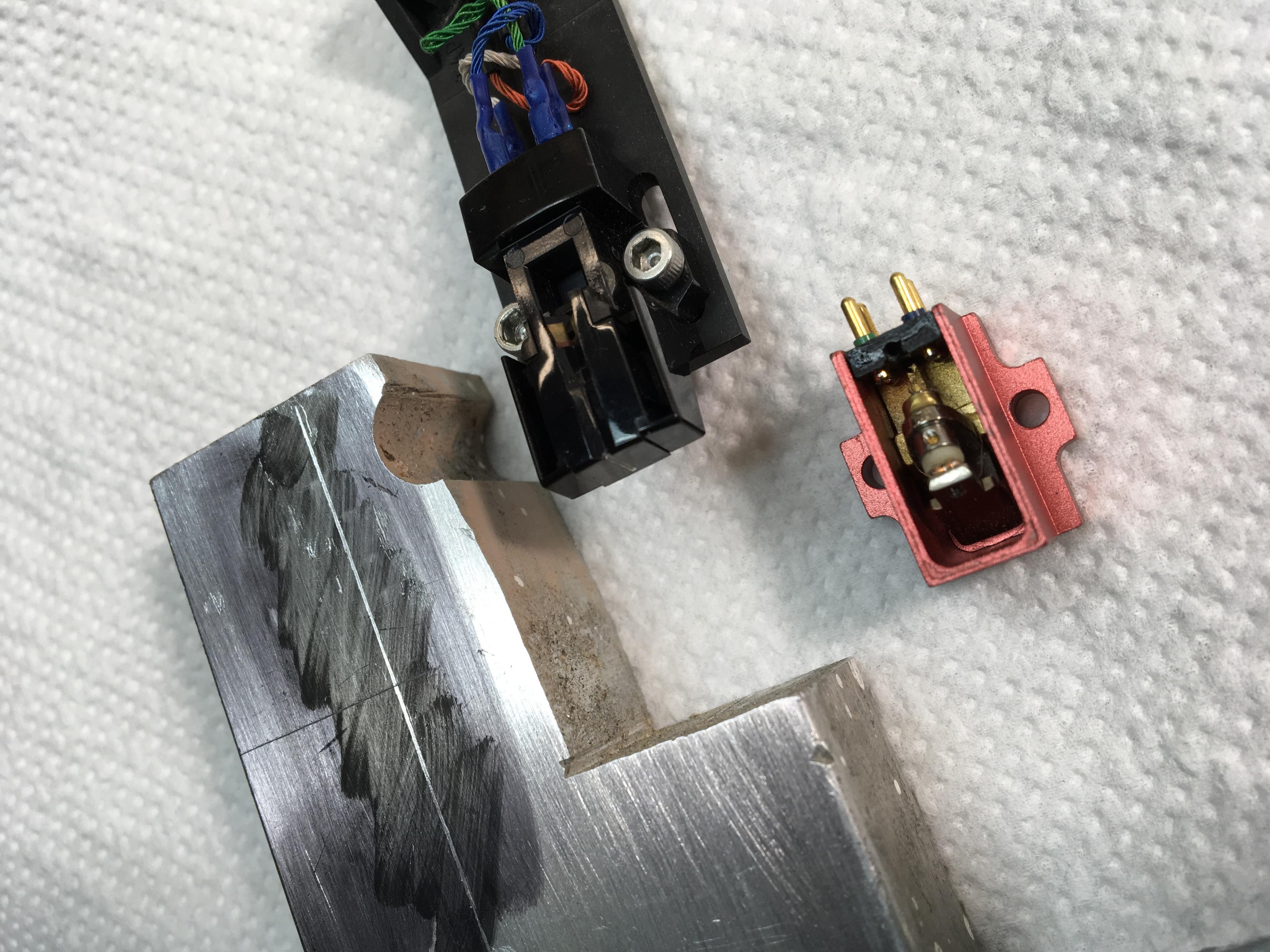

And as I mentioned before one of the strain gauges went open in one sample I have so I went ahead and disassembled it to investigate further and snapped a few photos on the way.
Impressive pics Dave !
Didn't realize this was under the element holder
Can you pull it out completely and possibly repair it or at least resolder and see what happens ? Nothing to lose at this point
If you could take another pic (if you pull it out entirely) that would be interesting to see and maybe someone will know where abouts to get a suitable replacement SG

Looks like the SG element is made from a piece of phenolic electronic base board material milled into shape with a small groove underneath the semiconductor element.
The semiconductor strain gauge resistor seems to be the small cylinder shaped part with two larger 'feet' soldered to the gold plated copper layer. The entire semiconductor part is quite big - must have been expensive. Todays semiconductor strain gauge elements are much more smaller and are extremely thin.
One potential source for modern replacement parts I identified could be Kulite, based in New Jersey. They produce semiconductor strain gauge based pressure sensors for a wide range of industries. Kulite's product portfolio lists semiconductor strain gauges of various sizes, shapes and resistance values already bonded to small stripes of FR4 electronic board material. On their website, they have a pdf brochure describing all the basics and the properties including datasheets.
