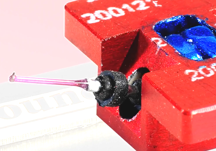

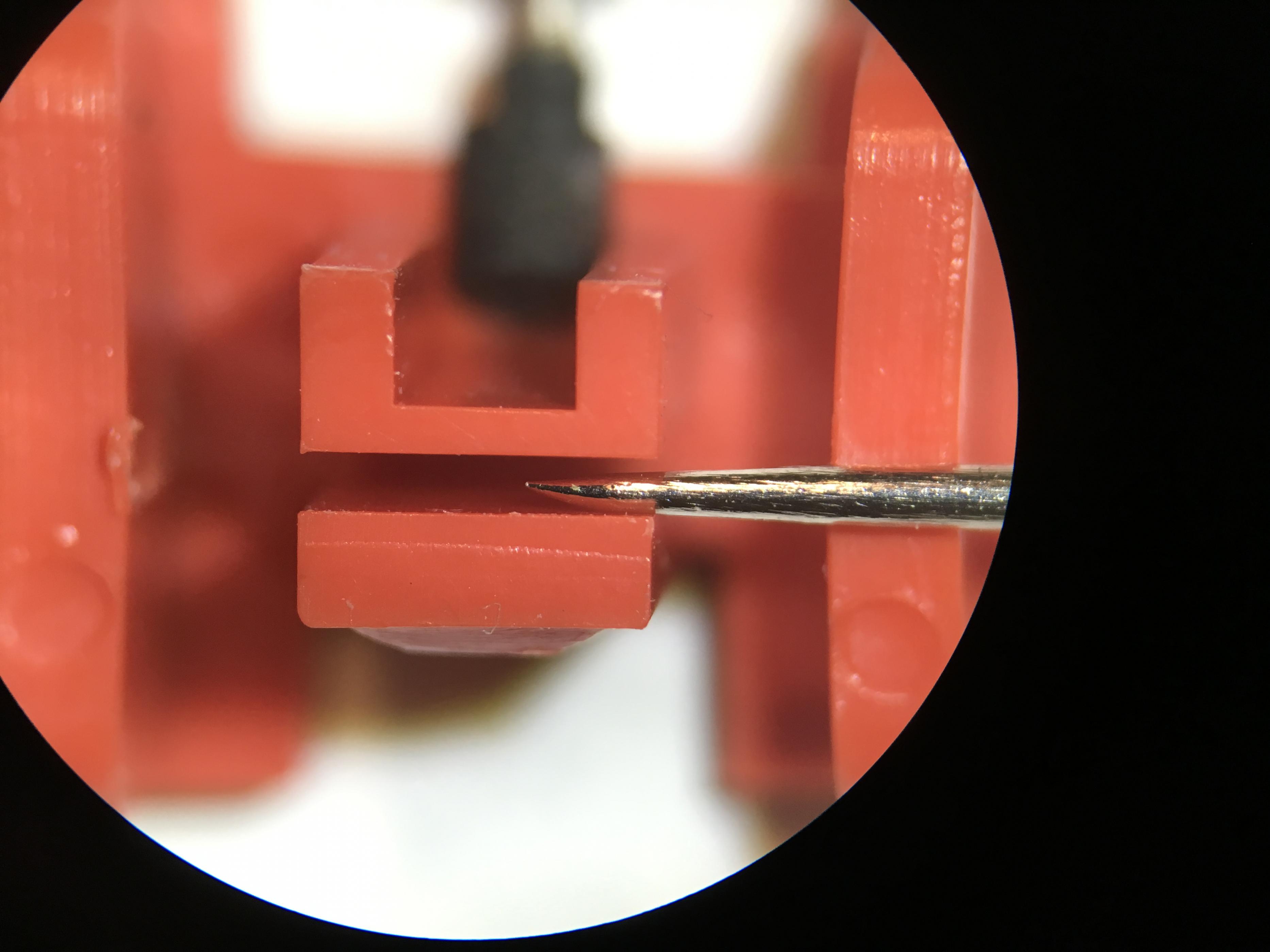

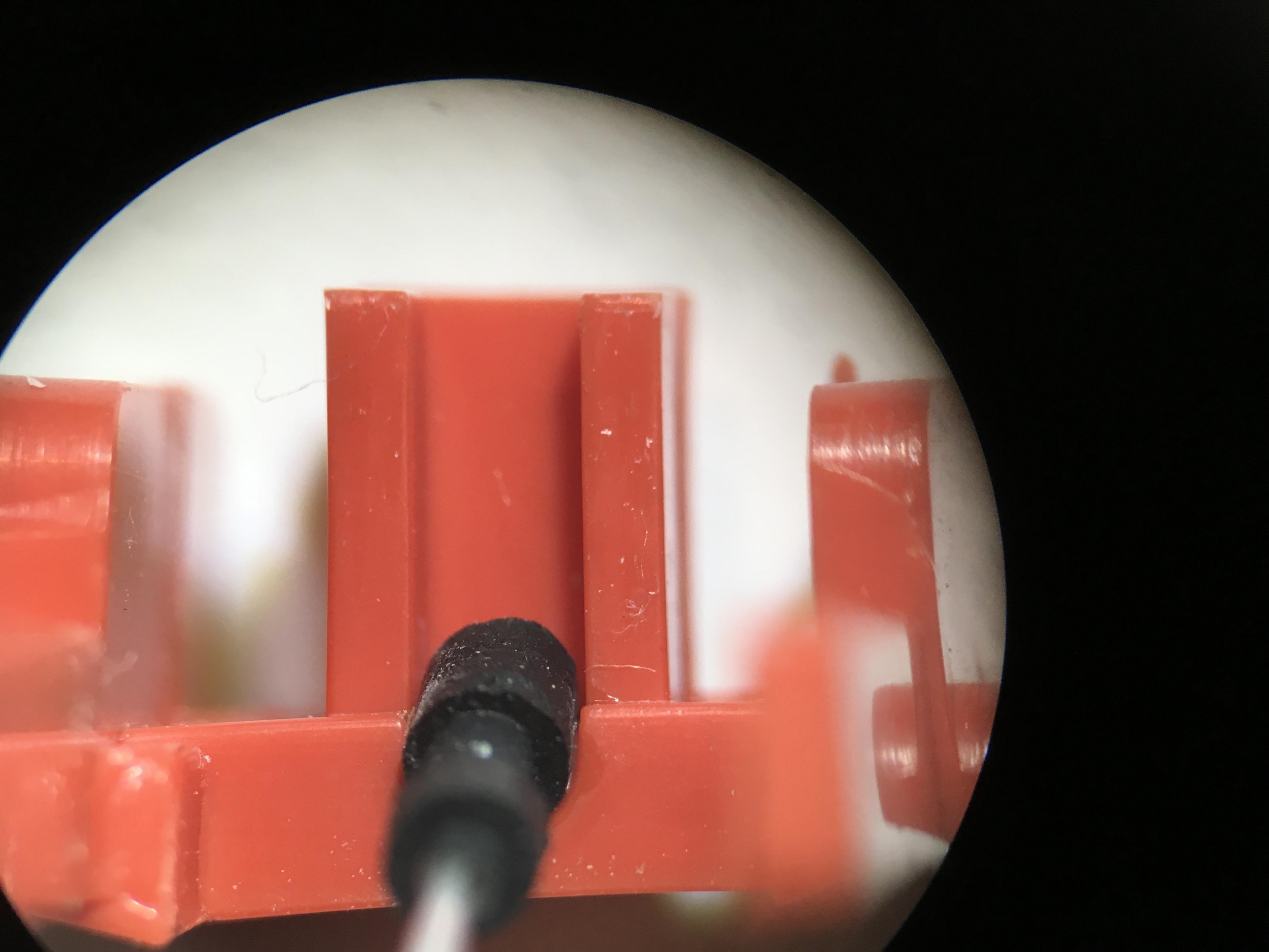

Here is resonant tip/body reduction for a stock SG cartridge.
Pull the removable stylus off and look down in the square hole of the cartridge body.
This hole is .200" deep.
The stock needle assembly reaches only .175" deep (.025" of dead space)
This is the cantilever rubber base attachment point ("U " shaped channel ) that stops short of reaching the bottom of hole when pressed in.
The needle points (photo) to a split lower piece with a tab protrusion on the bottom of the photo
This "tab" presses against the back side of the square hole making it more rigid- but -
The entire "U" channel with the vibrating cantilever is leveraged off this piece and the donut
/element as a fulcrum point between the record.
In effect this is a resonant chamber that needs filling...
Stands to reason this could be slightly filled with blutac on the bottom (.025" of dead space )
The "split " and part of the "U" channel can be also filled with the same material to stop this highly resonant area as you press the stylus assembly in and compress this foundation.
You can always remove it without penalty.
Tell me if you can hear a change by doing this easy mod.

I tried part of your suggestion which was to fill the void between the front and rear tabs in a Bliss stylus. I was afraid to fill the bottom of the cavity as it seems unlikely I could get it all back out if I didn't like the subjective result.
I expect the blue tac to harden with time. I used a very, very small flat bladed driver (1/32nd of an inch) to press a tiny amount of blue tac into the groove between the tabs. I completely filled that area and trimmed away any that oozed out the sides.
The results; It certainly doesn't hurt, subtle, I have the impression of an improvement in image stability and a further improvement in resolution. Midrange stereo separation is noticeably better, slightly more neutral/restrained tonal balance.
I applied this on the 451C which is mounted on a well damped arm wand on the Souther SLA-3. This set up overall has a fuller, bassier, less analytical sound than the 465C on the Schick, and that continues to be the case, the overall tonal balance changed very subtly in a direction I frankly prefer.
In short I would recommend doing it. Your results may vary.
