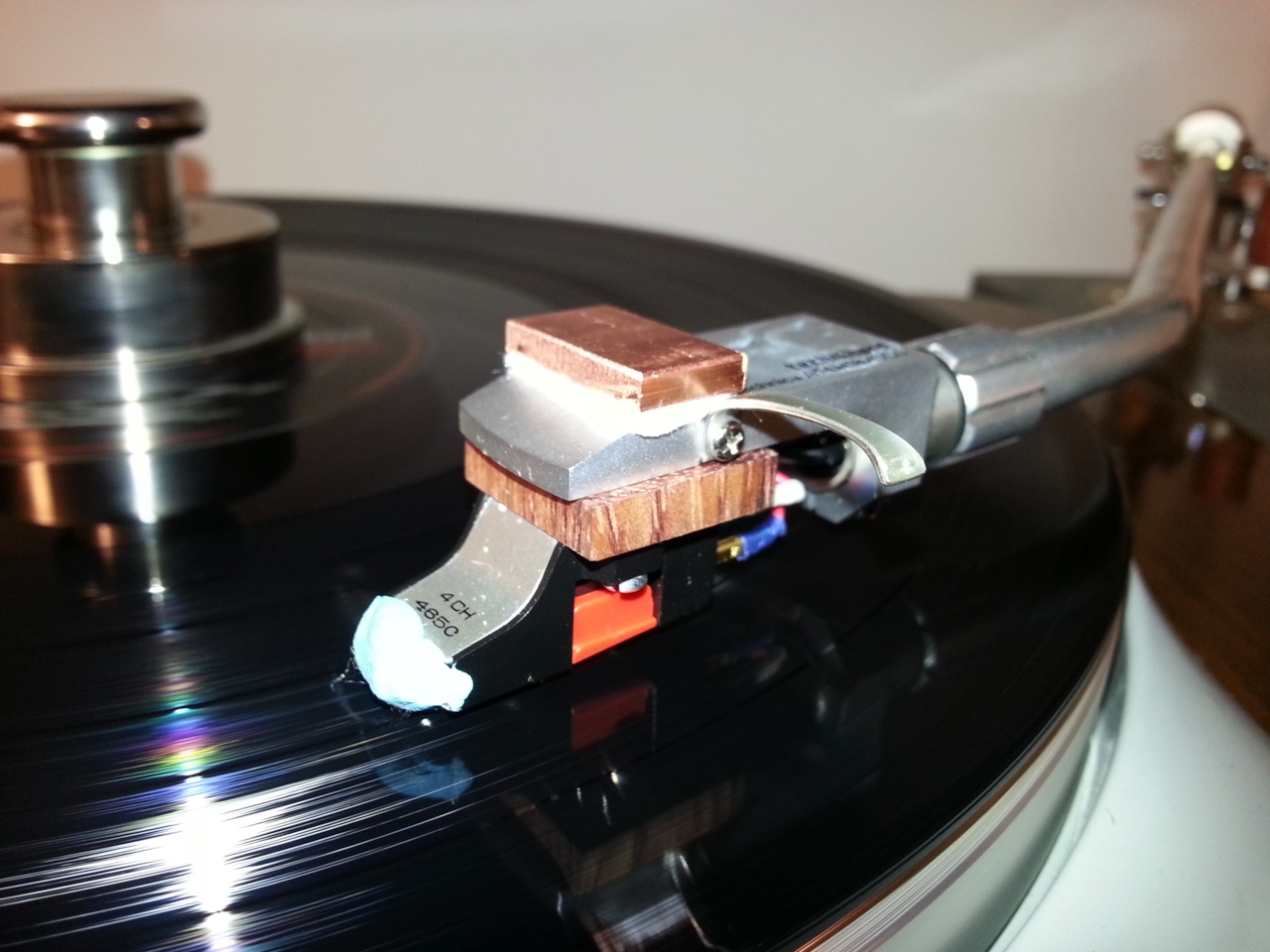

These cartridges are light, typically 3.5gms and compliance extremely low, 8 x 10-6 dynes to 10 x 10-6 dynes, and track at high tracking forces as high as 4.5gms for an EPC-460C or EPC-465C, which are rather contradictory characteristics.
The 18gm AT Technihard is the highest mass head shell I have found off the shelf, and I have several of them, making them a reasonable starting point. The Schick was really designed for SPU cartridges weighing between 28 - 30gms, and even with the AT shell 21.5gms is too light for balance.
One of the other problems with the Panasonic is that the cartridge is rather squat which means with most modern arms and shells a spacer is required to keep the lower edge of the head shell from bottoming out on the playing surface. (I also cannot adjust my arm this low)
I have fabricated an ~ 3/16" (1.6mm) spacer out of Bubinga that is placed between the cartridge and shell. This has 3 benefits; it provides some additional mass (about 1gm), is quite lossy in the HF, and provides sufficient height to allow a reasonable arm height off of the record. (Note that I may try a copper spacer at some point with some gripping stuff to decouple the spacer a bit from the shell)
I'm still quite short of optimum mass for arm balancing, and for that matter given the low compliance of the 465C used on this arm, the LF resonance. I have added approximately 6gms of copper bus bar (I tried bronze but did not like the result.) this increases total mass of the head shell to about 28.5gms. I am using a bit of the gripping stuff or alternately blu tac to hold it in place. (I think I may prefer the blu tac to the gripping stuff here)
The little blob of blu tac on the nose is perhaps the weirdest bit, but is also quite critical. The strain gauge transducers are mounted in the relatively flimsy nose, and excite the housing, and therefore each other. The blu tac damps the end of the nose and reduces microphonics, ringing and coupling between the transducers. This might be the single most effective thing I have done.

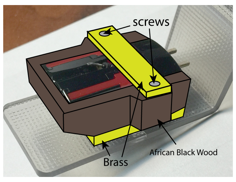

Actually, I am thinking of modifying the SG cartridge, too. Here is the plan. I will use epoxy to glue the cartridge in a wood body with solid brass as base plate because it seems to me that it is not easy to remove the motor from the plastic body. I will fill the gap between wood body and the plastic body with epoxy too.

Lower brass bar may scrape on the record surface if too thick.

Not quite sure yet what order of constrained layer damping..,.
Epoxy might prove to be too stiff, but it sure is easy to implement.
Hot glue might work well since it stays relatively soft and absorbent of resonance.
Drilling a hole in the front body and pumping some hot glue in would solve that end and of course be permanent with no further mods possible..,.
The only way to approach a rebuild would be to seperate all pieces on a table and pour a glass of wine and think it thru !

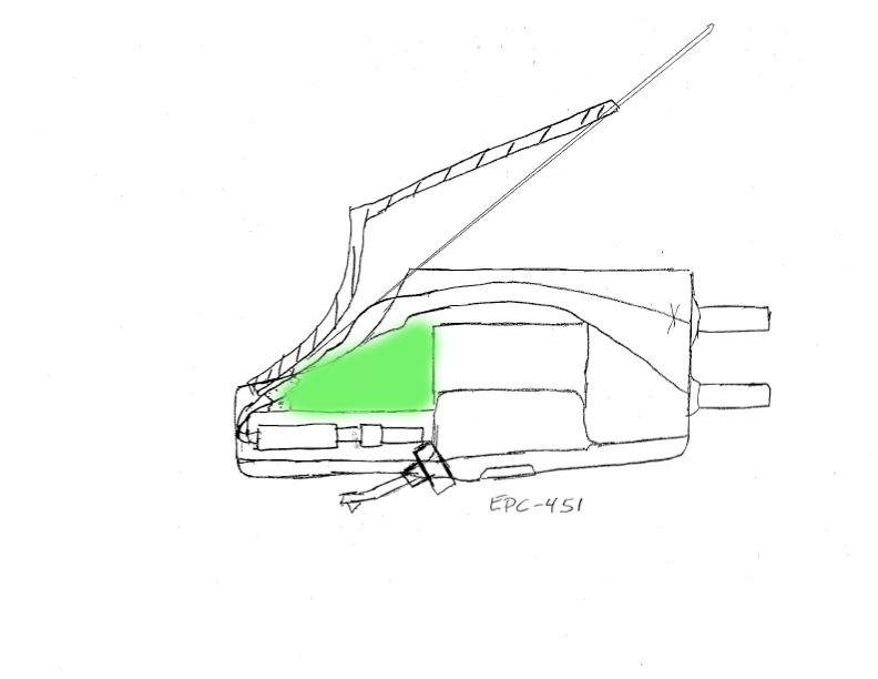

If anyone is rehousing a Panasonic strain gauge and has cad cam capability and can make drawings I have been offered what might be an opportunity to get some rather interesting cartridge bodies made. (Not sure of cost or time frame, but this is something outside of my current skill set.)

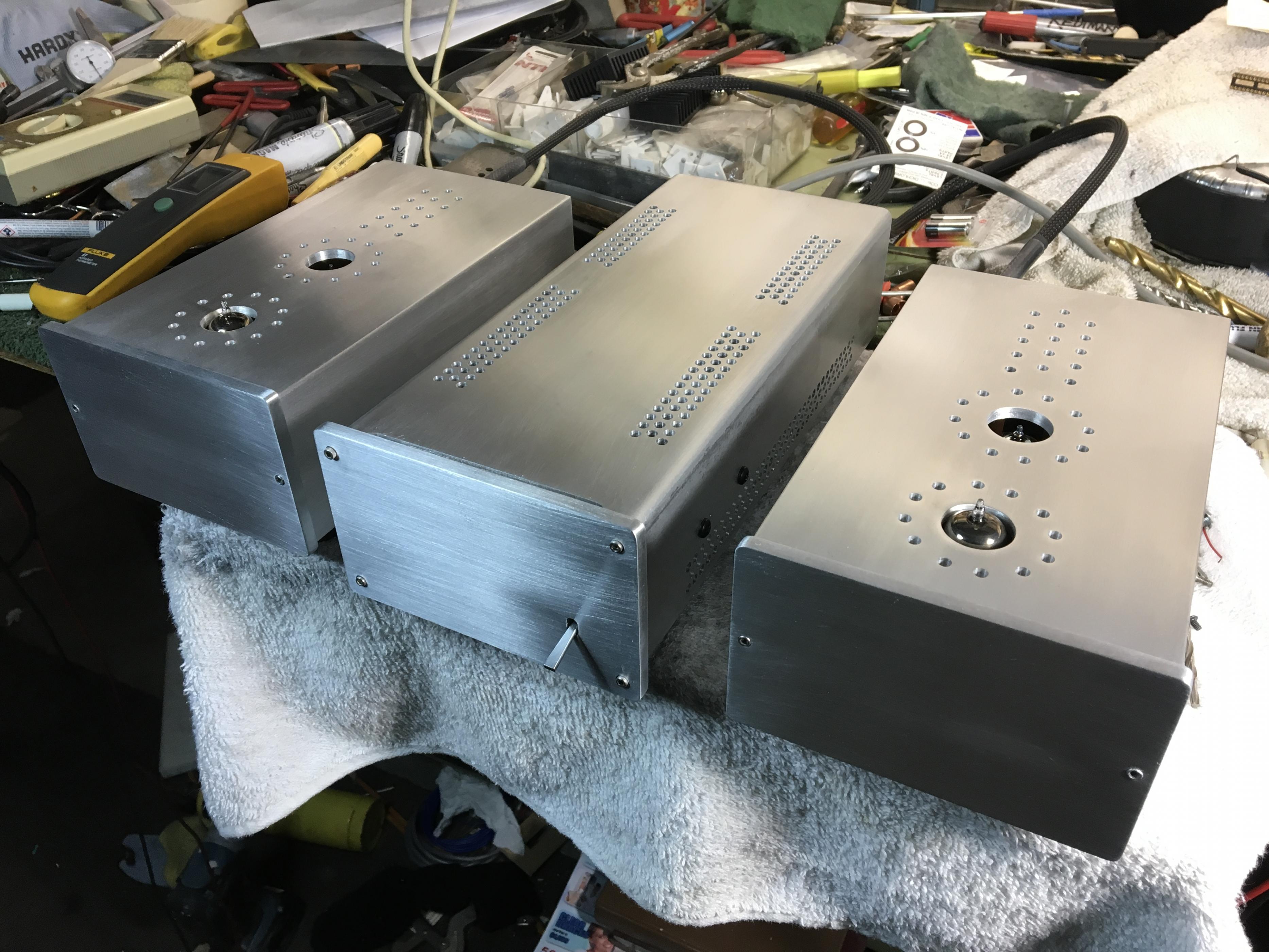

Been running up the whole enchilada for 5 hours to check if the cooling holes I added were enough since a stubborn insistence on using this type of enclosure required a lot of extra work..,.a more open bigger style enclosure is way easier
and sure many will be making it this way.
With 29 C ambient in my closed garage, and 103 F outside today ! - I redid the old single heat sink (58C without enclosure!) in the PS , with a copper sandwich on the bridge bolted to the side , and an infrared thermometer pointed on the bridge inside, its stable at 43 C and cool enough overall for a long life.
The phono boxes are running just warm to the touch and cooler than the PS enclosure overall.
I will initially be running it on a JVC QL -10 direct D just to break in the signal path and rubber suspension before transfering it to my air bearing platter/air bearing linear TA combo I built for the time being.
Will be Resurfacing the boxes and Anodizing everything when I get a handle on how to anodize myself and have already bought the sulfuric acid, plastic containers, distilled water, lead,water pump, etc. and already have numerous power supplies needed.
