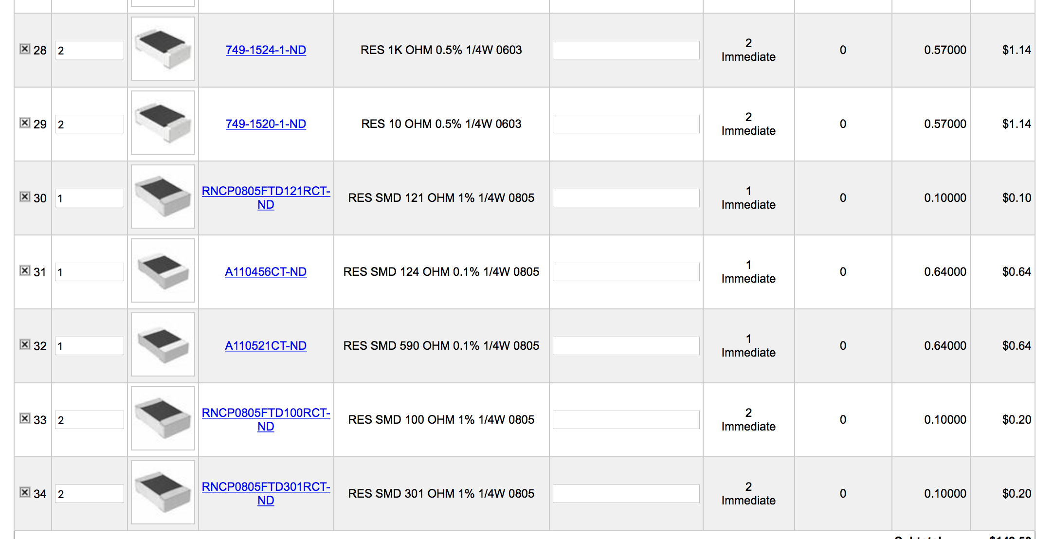

I found one with tighter tolerance. Everything else is same. However, I am bit confused. Please see the image. In your specs, these SMD are 1206 SMD. What I found are 0603, 0805. I don't know what these numbers mean. Are my selections ok?
No, you need to purchase ones in 1206 footprint, the 0603 and 0805 are smaller and won't fit the footprint. Let me look for a few minutes.
Search for "Thin film SMD resistor" on DigiKey
Then select Package / Case 1206 (3216 metric)
Tolerance 1% (and optionally 0.1%)
Stock status: check "In Stock"
Select 1 or more resistor values.
Click "Apply Filters"
Here is 10 ohm: RNCP1206FTD10R0 Stackpole Electronics Inc. | Resistors | DigiKey
Here is 100 ohm: RT1206FRE07100RL Yageo | Resistors | DigiKey
Here is 121 ohm: RNCP1206FTD121R Stackpole Electronics Inc. | Resistors | DigiKey
124 ohm OK to use thick film: RC1206FR-07124RL Yageo | Resistors | DigiKey
Here is 301 ohm: RNCP1206FTD301R Stackpole Electronics Inc. | Resistors | DigiKey
590 ohm OK to use thick film: RC1206FR-07590RL Yageo | Resistors | DigiKey
Here is 1K ohm: RNCP1206FTD1K00 Stackpole Electronics Inc. | Resistors | DigiKey

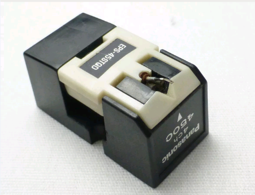

I scored a significantly challenged Panasonic EPC-450C which appears to have been abused at some point in its life. It's functional, but with the hopefully tired OEM stylus apparently had a distortion problem. There is a small crack in the back of the body that concerns me. I plan to start out with an inexpensive replacement stylus before investing in a better one. Choices of styli for the 450C are quite limited and good ones are a lot more expensive than with the 450CII - 465C. Shipped it came to $71 so if the gamble doesn't pay off I haven't lost a lot.
The EQ that will be required may be slightly different from the later ones, but that remains to be seen.
This was of interest because of the different packaging and much higher (theoretical) compliance.
The later ones I have seen to benefit from a considerable amount of mass loading. I am wondering how much of the LF rise is attributable to insufficient arm mass. Compliance is low, lower perhaps than even the DL-103, although I have not measured it.
The photograph is of the exact cartridge I purchased, but was scraped from the eBay listing. If you look very closely you can just make out the crack in back right corner of the housing. It does not go the whole way through.
It is anyone's guess as to what one of these sounds like, and if this one has internal damage I will probably never know.
I have wondered whether the compliance of the dampers and mounts has decreased significantly over the past 4.5 decades.

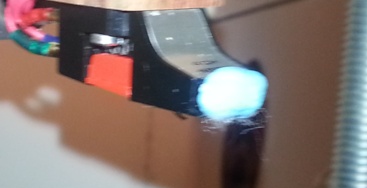

Those of you familiar with the 450CII and later series cartridges probably are aware that the strain gauges are mounted in the nose of the cartridge. It has come to my attention that touching this end of the cartridge results in noise. Damping the plastic in this area seems to improve HF smoothness and separation at least on a subjective level (of course it could be self suggestion).
I used about .2 gms of blue tak stuck right on the front edge of the nose, doesn't look particularly great, but I think it does something positive.
Can anyone corroborate this?
Here is a shot of what I call "the blob" - it is aesthetically unappealing but it does seem to have an audible effect.
I realized since I installed this cartridge on this arm that the nose of the cartridge is quite microphonic, more so than most of the rest of the cartridge body. This observation arose because unlike the Souther the cartridge is easily accessible for touching.
