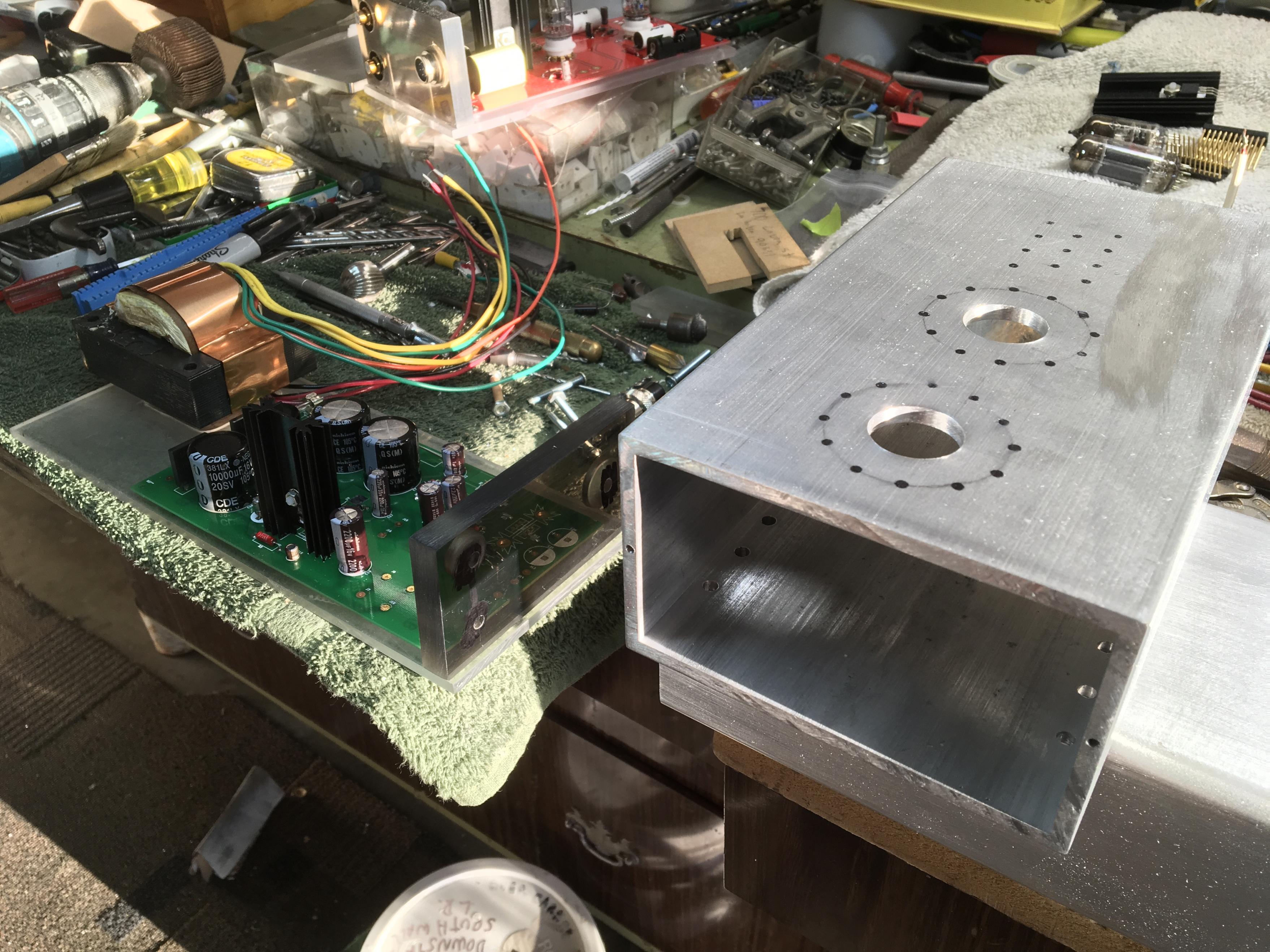

When I power it up, I will double check the heat before I put a clearcoat over everything.
There is a double row of holes on the bottom to Venturi the heat out BTW. I can add more holes if necessary. Where the plexiglass base narrows is where the holes are drilled in the bottom of each enclosure as shown.
The Trans needs its bell housing covers removed just to slide inside without cutting away
the bottom area.
The pcbs are isolated from the cases that will go to the ground pin along with the cables foil shield. It will single end connect at the earth side
Fun project overall.

Are you using conformal coat? How much capacitance does it contribute? The only area that is critical is around the EQ section which I would recommend you not coat, plus you may want to make changes later on if I come up with a better EQ down the road.
A couple of slots above the heat sinks should provide good convection over the sinks based on what you describe.

I am not anodizing (best of course) just using an Aluminprep mild acid and lite Alodine for corrosion and then outside coating of clear.
I was a licensed Airframe & Powerplant FAA mechanic many many moons ago and worked on small business jets and now retired, and used to mess with alum. all the time way back in the day.
So there is no issue on grounding or getting thru to the raw material.

Ah, I think I misread or misinterpreted what you wrote, I thought you were talking about coating the PCB not the aluminum. 😀
It looks great. And I see you have made provisions for additional ventilation as suggested.
Based on looking at this I have decided to put my breadboard unit in three boxes as you are doing. (I did this in the original Muscovite as well so there is precedent)
I see you got the end bells off the transformer OK, are you going to mount it on standoffs? I would make them three of them non-conductive with insulated washers on both sides and a sleeve of some sort inside in order to minimize currents through the core and chassis unless it is mounted on plexiglas in which case do ground the core at one point in addition to the electrostatic shield.
In long term use you will want to clamp the core (bolts and washers) regardless of how you mount it in order to prevent the laminations from loosening up and buzzing. The one running in my supply is extremely quiet and not audible from even a foot or so away in normal use.
The PSU and transformer also dissipate some power with the filament regulator (about 5W typical) and rectifier (probably 5W!) being the most. Again something north of 15W total depending on line voltage..
The mosfets are dissipating at most 2W and likely a bit less between them at typical line voltages.

Yes, the trans is just sitting there for now , I will stand off the trans and bolt the cores together. Didn,t think about grounding on one of the bolts and good info.
