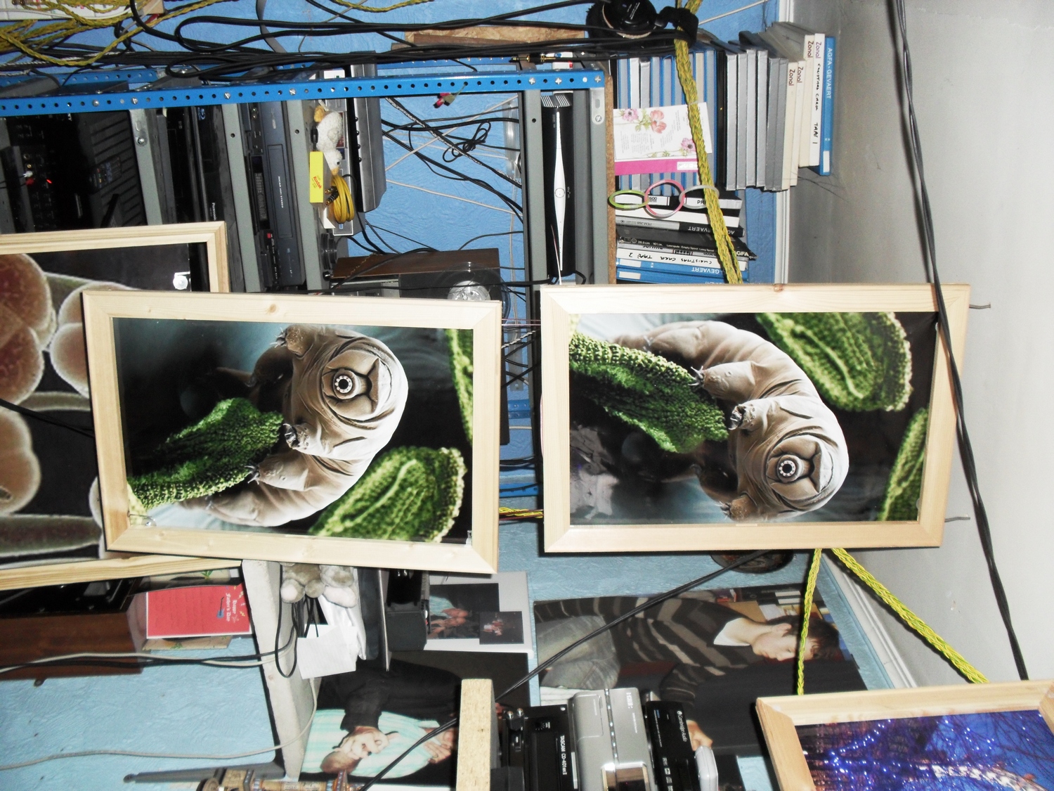

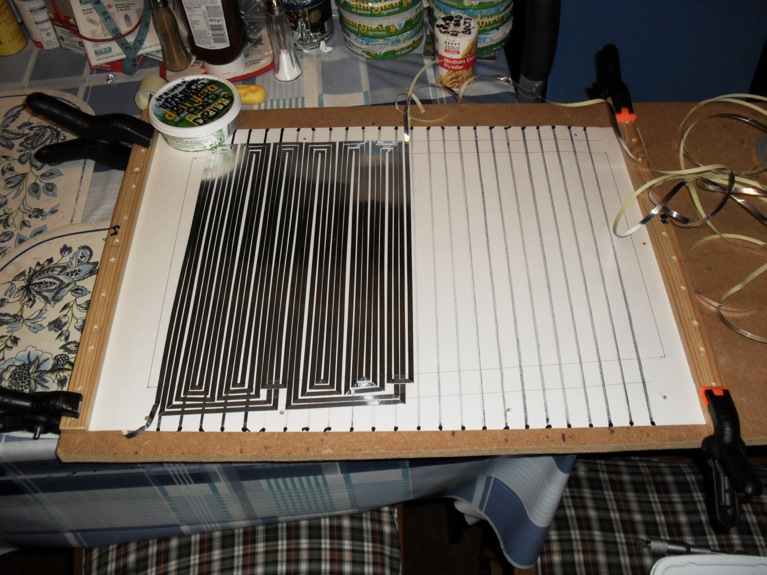

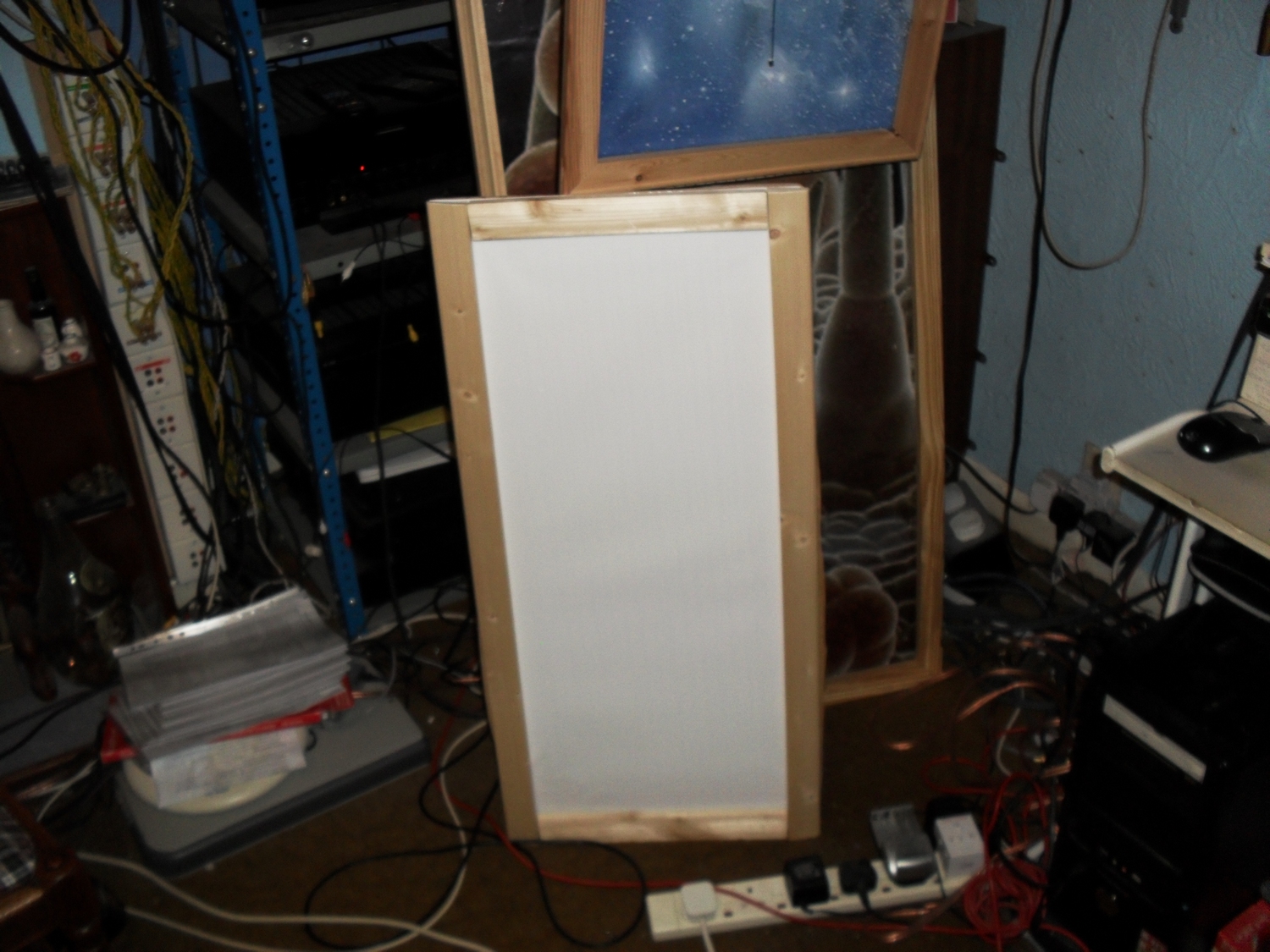

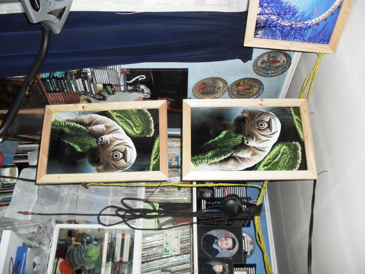

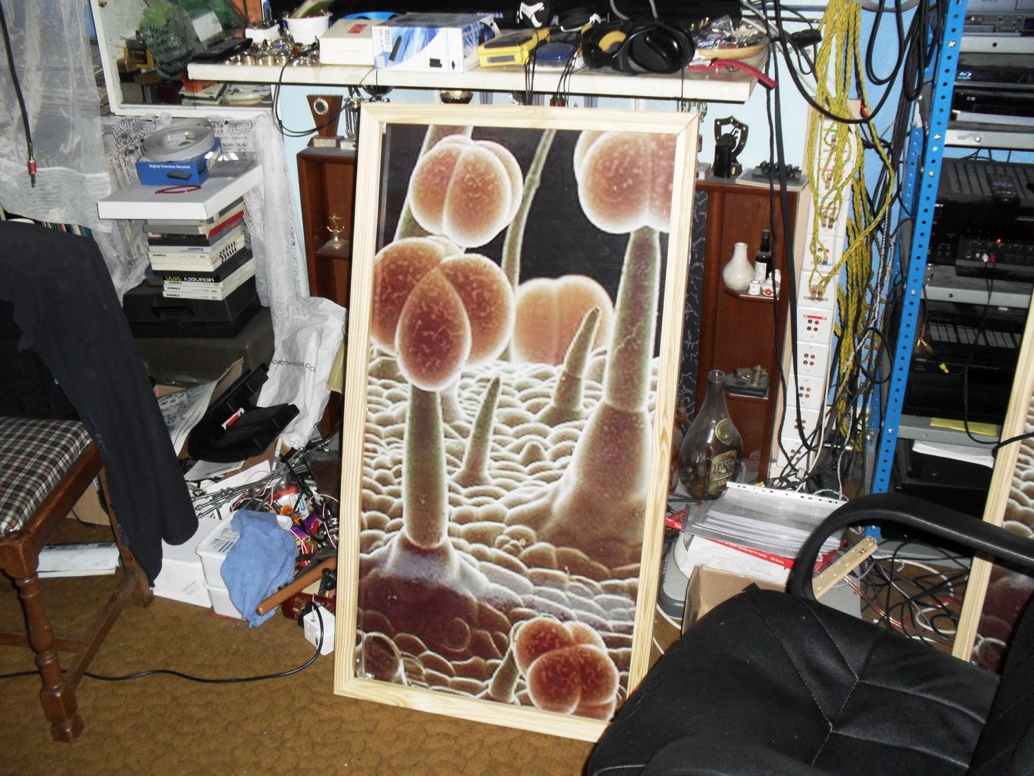

I use photo paper now much easier to mount and tension said diaphragm. Using double sided tape, although you have to be very careful to line up the diaphragm correctly. Been rebuilding all my old designs about 30 up to now, a few more left to do, and 2 pairs of headphone designs!
I'm using 20 um at the moment, I am not sure but that is thinner I think. So up to you how thick you use. I am quite happy with 20 um. I don't like it too thin as it is too noisy as I found out when I used the mylar! That is why I stopped using it.
latest planar designs using pics!
Just as good and easier to build, I also use my version of the epsilon layout, using 3, 5, and 6 mm wide tape depending on the width of your magnets. I have got 18,22, and 25 width wide magnets so use different tape widths to fit, using my version of the epsilon layout. Have nearly finished my rebuilds . Will only use ferrites on the smaller 60 x 40 cm versions the 4' x 2' ones are too heavy for my age (77). Will use neos on this size.

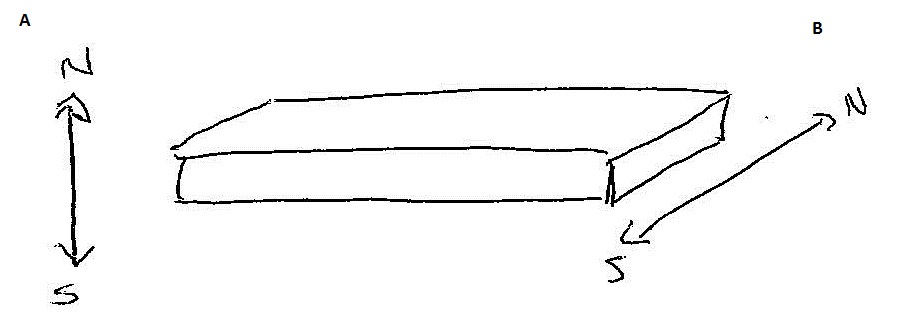

One additional question
Thank you for the info on the paper. I think traditional speakers sound better with paper cone. Somehow I expect the same here.
I confess I remain confused about the magnet field orientation. See my sketch below. I found a local source of 25x8x3mm neos. But they have orientation as in A below. If I understand the ones you use they would be oriented like B. Mine have north all across the big flat side that is 25x8 and south is on the bottom. Which way should it be? Sorry to be slow on this.

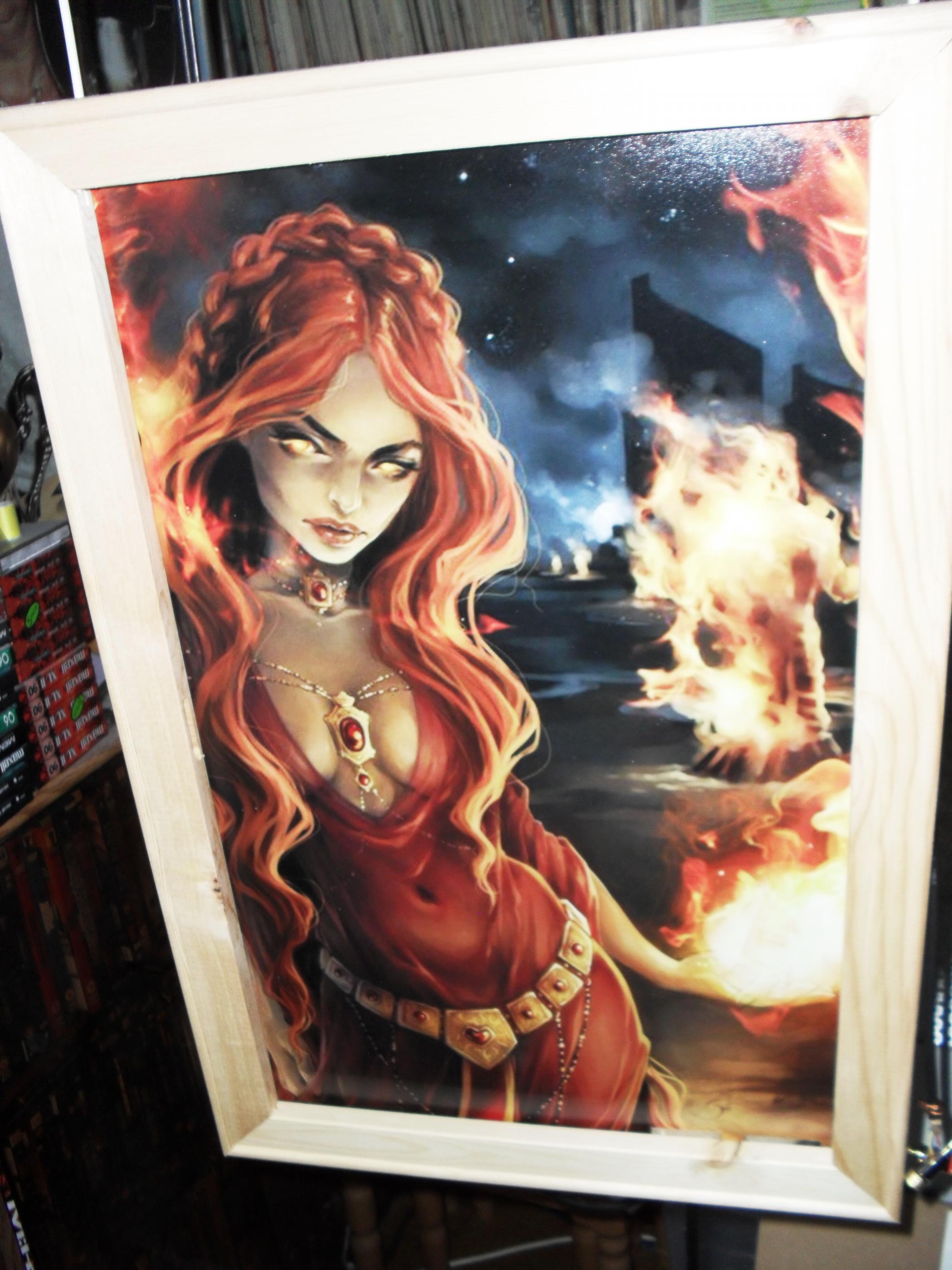

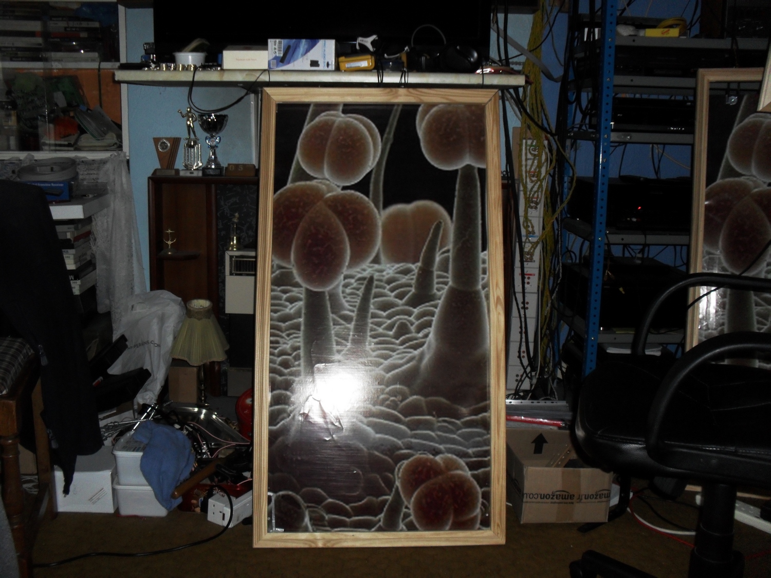

full range planar 24 x 16 inches
