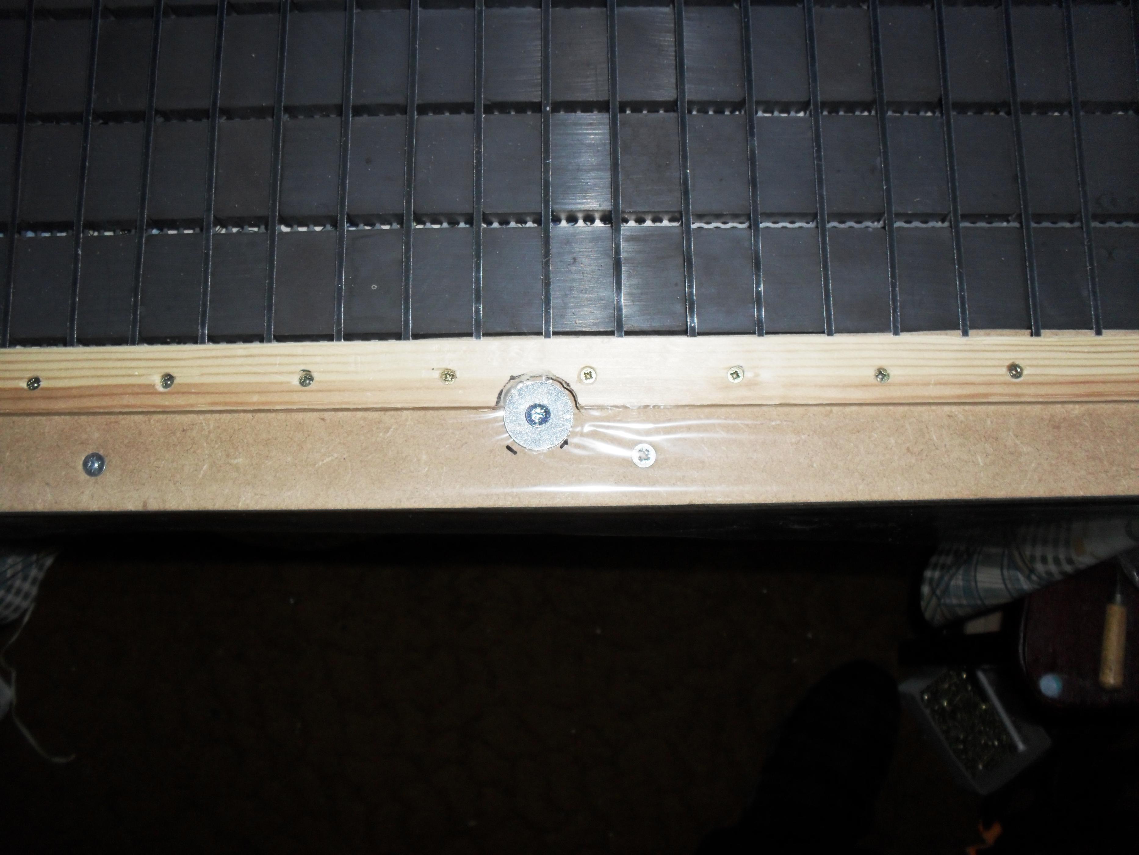

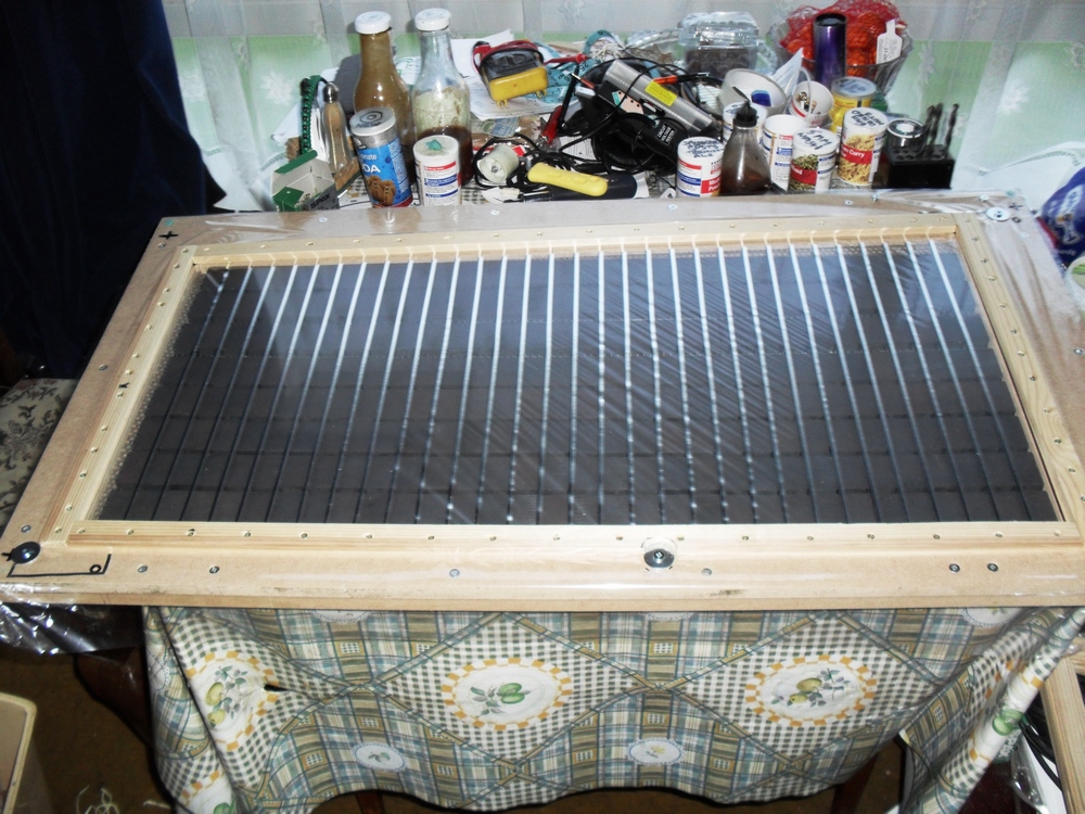

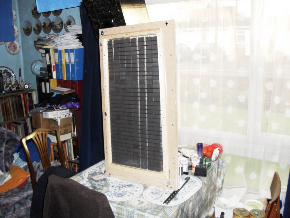

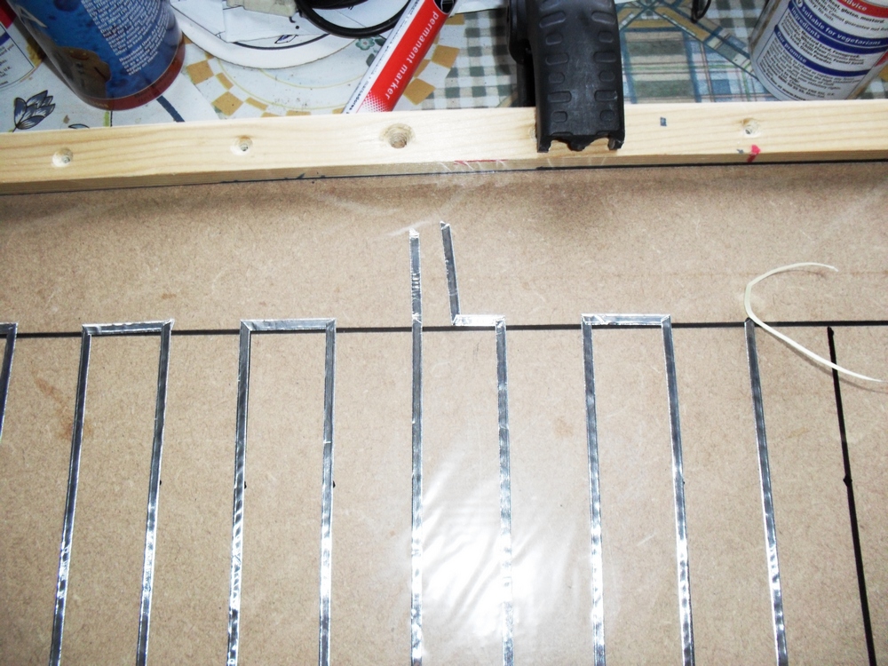

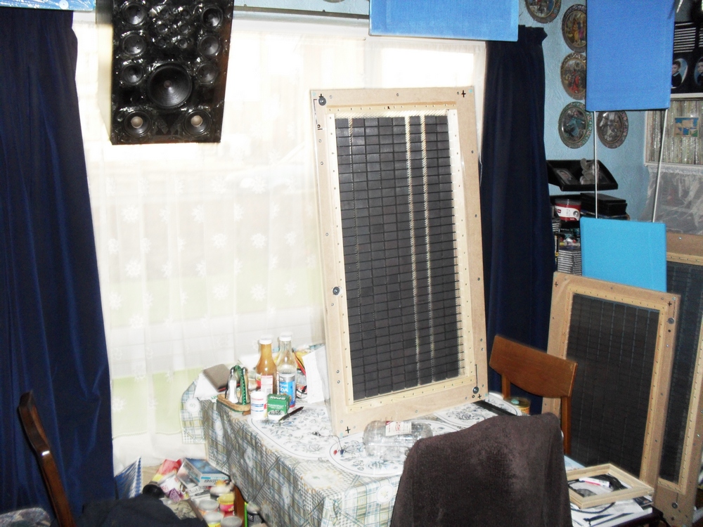

REPAIR TO BROKEN 3 MM TAPE ON DIAPHRAGM
First picture shows where I broke the tape, and I have put tape for penny washer. 2nd pic shows penny washer in position with wood surround for holding diaphragm in tight and correct position. 3rd pic shows diaphragm fixed. 4th pic shows other penny washer for connection of the back resistor. You can see the other penny washer for other back connection top right.5th pic shows it standing up on feet, although not quite finished. Final imp is 4.2 and 6.4 ohms for my ONKYO Amp. 6th pic another view on the dining table. Rebuilt these speakers from poor push pull design using 4.5 mm wide tape and 100 um polyester diaphragm material. A big improvement all round.
