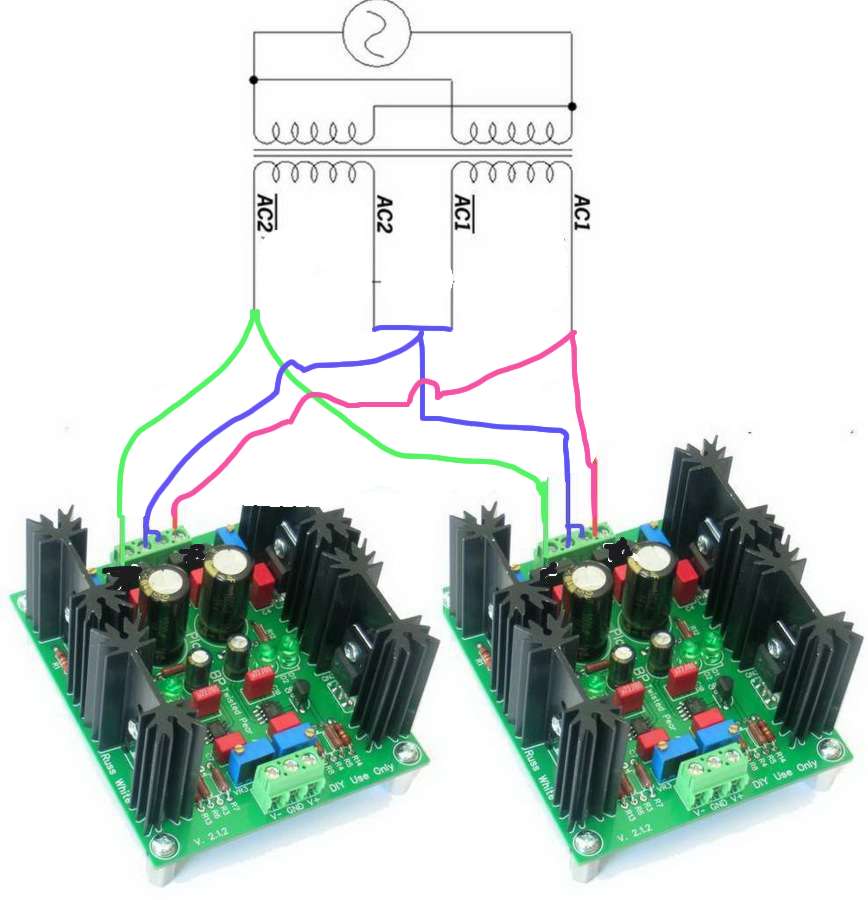

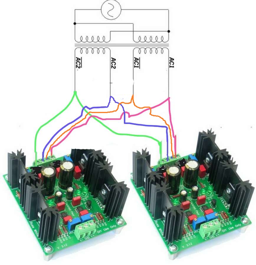

Which is the better way with one transformer?
I would use the first, although you cannot wire it the way you have it.
You could do the second option, but I think it's probably a waste of time, but don't let me stop you. 🙂
