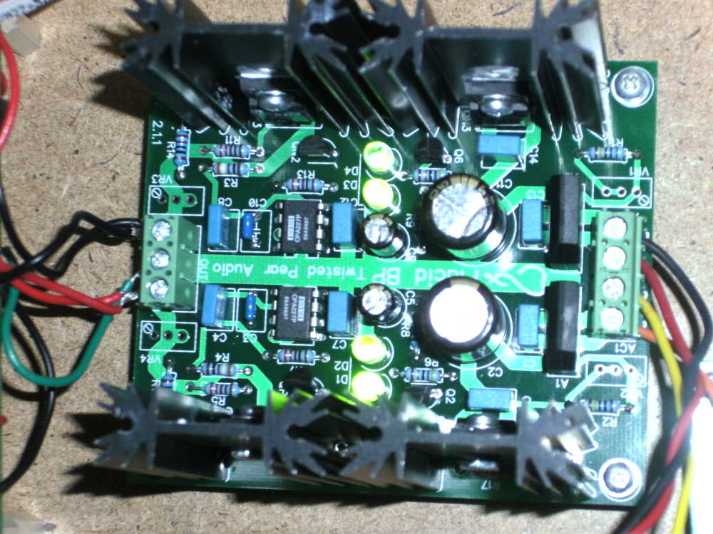

Measure between tp_out+ and tp_shunt+
Do the same between tp_out- and tp_shunt-
Post the result.
Post the result.
Thank avr300, with 10VAC input I measured gnd - tp_out += 12.9vdc, gnd - tp_shunt+= 12.9vdc, tp_out- and tp_shunt- is the same . No current load on R2A and R2B.
I am try to change the current load by VR1A, but VDC of TP_VIN = TP_CCS+ , no current load on R1A .

Great thank avr300, the problem was solved by my friend, the cause by VR2A, but I don't know why the line negative fail, same .
About the case vol dc down 15 VDC to 1 VDC by I mistake GND with - when connect to Legato.
Now, my board work well .
