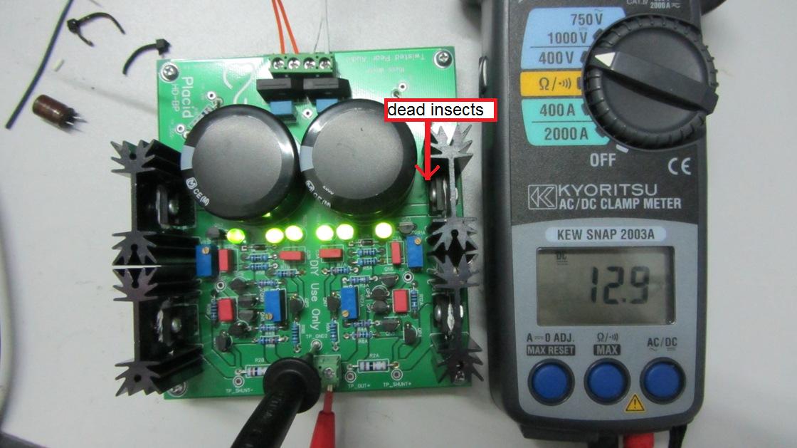

My Placid HD BP is fail , The VDC at rectifier = output but it drop to + - 1 VDC when it connect to Legato . I see a dead insects on QN1 transistor. Now , I measured on Placid HD BP , VDC of TP_VIN = TP_CCS and TP_OUT = TP_SHUNT, no current load on R1 and R2, all heatsink no warm ( cool ) . What wrong with it ? .
Thank you .
