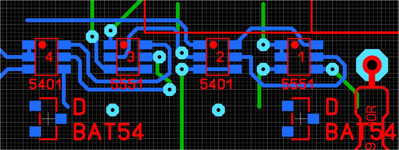

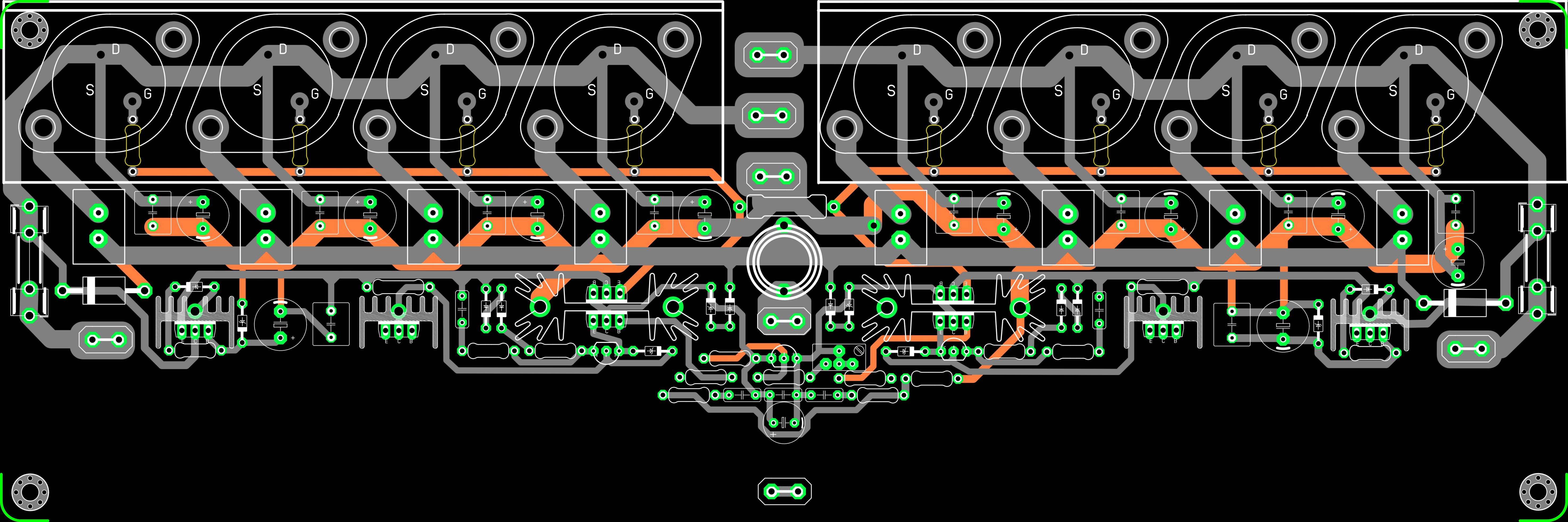

A plan yes. A date to test may be looking too far ahead. This is one of those projects that is not guaranteed to work.I would recommend backing up a bit from the PCB. Some may wish to go straight to the PCB stage in order to advance. However, I place some importance on understanding the behavior of what has been formulated. In this case the input stage is slightly different and getting a grasp of how it works thermally is going to feed into future work.
With that in mind, I would initially bread board with discrete non-matched transistors which was my initial suggestion. The purpose of this would be to determine where the design concept breaks and how closely a match of transistors is required. The power devices do not need to be included as feedback can taken from the driver stages and a lower voltage version can built for concept test as well.
Of course you can opt for the PCB and see what gives. Since a lot of work is falling on your shoulders, you can direct others to give you what you need.
Give me a schematic and parts list of the testing bread board that you want to test. Also a testing setup and such. I have a scope and other test equipment. Or I can build it send it out. What suits you. Thanks

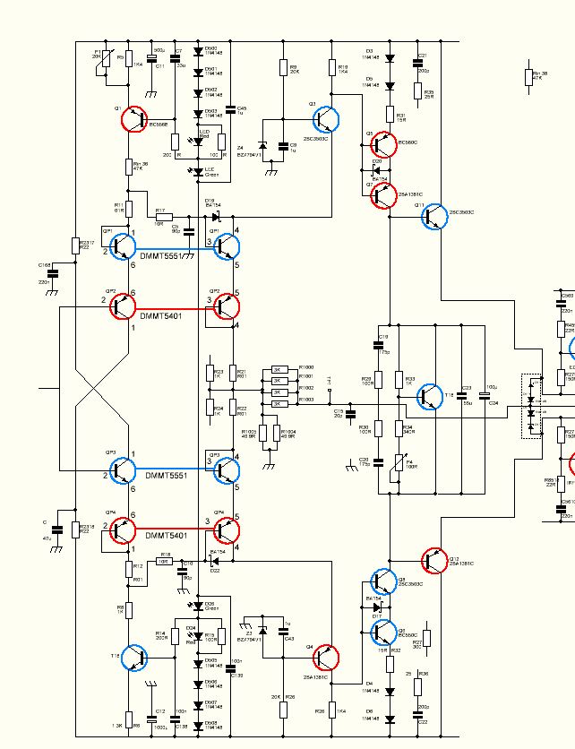

I have lost track of the last version proposed for a build. Could you post this so that we start from a known point and the test version can be extracted from that.
This one of the last schematics that I have.
Tournesol said,in the first post of the thread that the last version was the one in post #428I have lost track of the last version proposed for a build. Could you post this so that we start from a known point and the test version can be extracted from that.
Pizzicato #428
Toiurnesol said, in the first post of the thread that the definitive version was in post #428.I have lost track of the last version proposed for a build. Could you post this so that we start from a known point and the test version can be extracted from that.
Pizzicato #428
