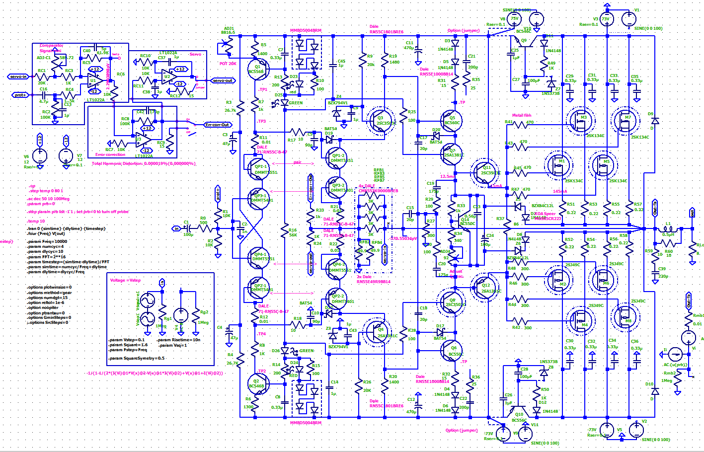

Need a 75V regulated supply for the front end. (<100mA)
Great care has been took on important details, like rail sticking, ability to afford huge clipping with no time limitation. (despite the protection will not allow-it). This comes at the price of a little reduced performance in distortion. But they still look good enough ;-)
0.000001% à 1W 8Ohms 1000Hz
0.000009% @100W
0.000013% à250W

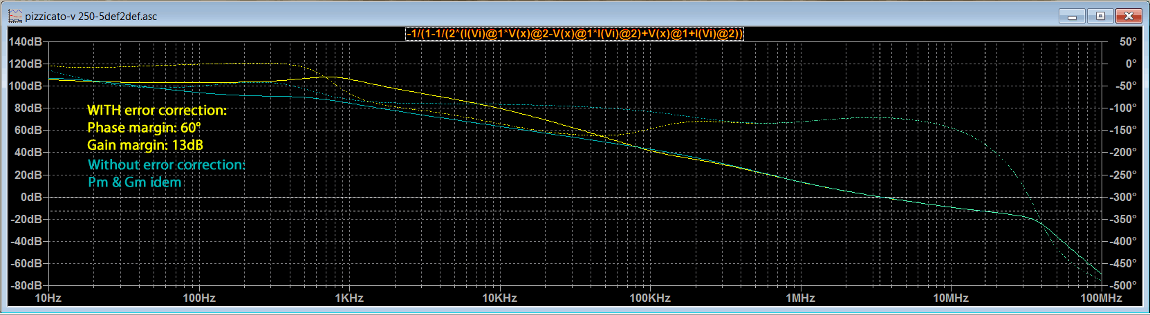

>100dB loop gain.
Of course, they will, for sure, be not so impressive in real world, but I'm confident they will be lot, lot under any audibility threshold.
Great care has been took on the VAS tempco as well. Current is very stable all over the temperatures), decreasing with temp everywhere else.
Of course, it is just simulations and we will see how this amp will behave and sound on the bench, but I'm pretty confident that it will require only little adjustements.
This was part of the game, to explore if it is possible to design an amp only with a simulator and have-it working on the Bench. The opposite of my usual way.

Some explanations of our final choices.

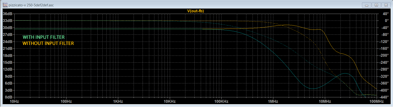

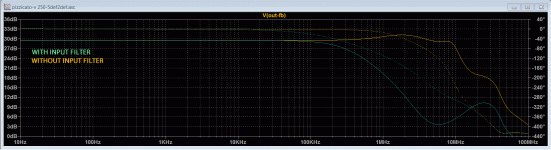

The strange arrangement of the input stage was motivated by the need of VBE match of the input active devices.
We have chosen (brilliant spladski's idea) to use CIs (pairs of matched transistors).
Using one of them in the first stage of the input stage as an active device, and the other as a diode in the second stage (and the contrary). This avoid any need to match them on the bench (they are VBE matched in the CI), and let them closely coupled on temperature changes. The first and second stages of the input part compensate each other.
This was needed by our desire to set a maximal gain in the input stage (No degeneration).
And by the fact that all the quiescent currents of the amp are set by the CSS of the first stage.
As the power dissipation of those pairs was not high enough, a cascode was finally needed (Again a spladski's idea), that brings some benefits on the HF response and distortion as well.
The strange arrangement on the current sources was my effort to get a tempco that pre-compensate as well as possible the VAS tempco. The result is quite flat in VAS simulations: we will see if it matches in real life, but there is enough room in the schematic to allow some tweaks IRL without any expected need to modify the printed board if any need.
The Schottky diodes around some transistors are used to clamp them in case of hard clipping and avoid rail sticking, all along with the choices of the base voltages of the input and VAS Cascodes to limit the max currents.
The diodes that protect output devices from dangerous gate/sources voltages was moved to the VAS stage, to protect the driver transistor for excess of current if it happens. Idea from Bob Cordell, suggestion of some members. Thanks to them.
Reverse diodes (thanks Dimitri) in the output stage to protect the power devices from any accident due to inductive loads.
Stabilized PSU for Input and VAS stage were chosen for two reasons. First, there is a 5V losse in the MOSFETS. Second, CFA input stages don't offer a so good ripple rejection than Long Tailed pairs at low frequencies. This will address the two issues.
Care has been taken to don't drive them too close to their saturation point if the 5V difference is respected. But this is not critical.
Last, we use a output stage inclusive compensation schematic. The benefit, compared to the classical miller cap is a noticeable improvement in distortion.

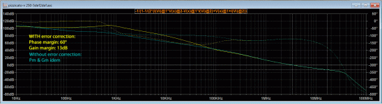

The Integrated circuits in the schematic are used for several purposes. Optional error correction, that add some 10dB more feedback to the amp, DC servo used in an original way, and, while we are here, protection.
The theory of operation is simple: we subtract the original signal from the output one, keeping (in theory ;-) only the differences (distortion and DC shifts).
For the DC servo, this will reduce sonic signature (if any) of the integrated circuits, because the musical signal has been removed before DC compensation is applied.
I think it will be the same with error correction. Not to forget that, once the original signal is removed by the comparator of the (fast) input stage of the first IC, the signal levels in the integrated circuits are highly reduced, as well as the distortions that comes with-it.
Too the phase response of the error correction was set in a way that allows the same amp to work both with error correction and without, keeping phase and gain margins at HF unchanged. Trying to get-it effective enough in the all audible frequency range. We will see on the bench if this can be improved at 20KHz without compromising stability.

As you can see, thanks to some very good suggestions, the final design respect totally the initial intentions, respecting the base schematic, and, as far I can imagine, all the points that needed to be addressed (obvious to me since the beginning)...had been addressed ... in a elegant way ?
I still need suggestions on some points, and returns of experiences, like ... base stoppers in Cascodes ?
I'm very curious to build and listen to this amp, that is the opposite of everything in which I believed since now. I am sure i will learn a lot of things and, may-be, have to reconsider many of my believes. Strangely, at the end, this amp smell good to me ;-)
