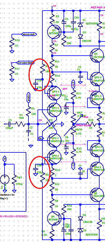

Krisfr, may-be it should be a good idea add those two resistances and two caps to the input stage ? The purpose is to reduce the collector voltage (power dissipation) of the first emitter follower.
A good practice should be to set the R values to match the collector voltages to the ones of the collectors of second stage amplifier transistors, when it is set with the casode.
If the cascode do not provide obvious benefits on AC results, it helps to give more latitude (power margins) on input stages currents, hence more choices of input transistors.

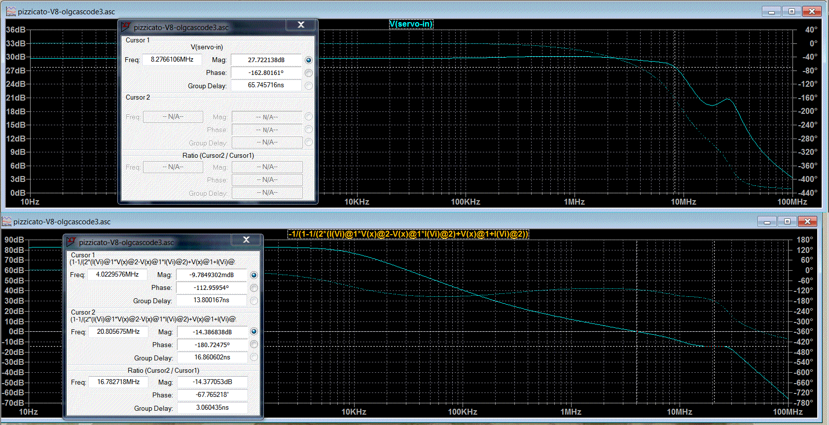

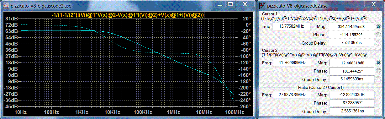

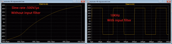

I wanted to try the Dadod OITPC compensation. The occasion to set a more traditional version of this amp for a CFA: IE extended flat OLG up to 10KHz.
Here the results.
For OITPC, as I had not found a clear explanation of how to make calculations, I did-it by trying and groping.
it uses, apart the compensation, exactly the same schematic, only some resistances and caps values changed.

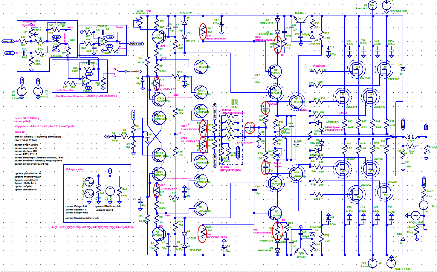

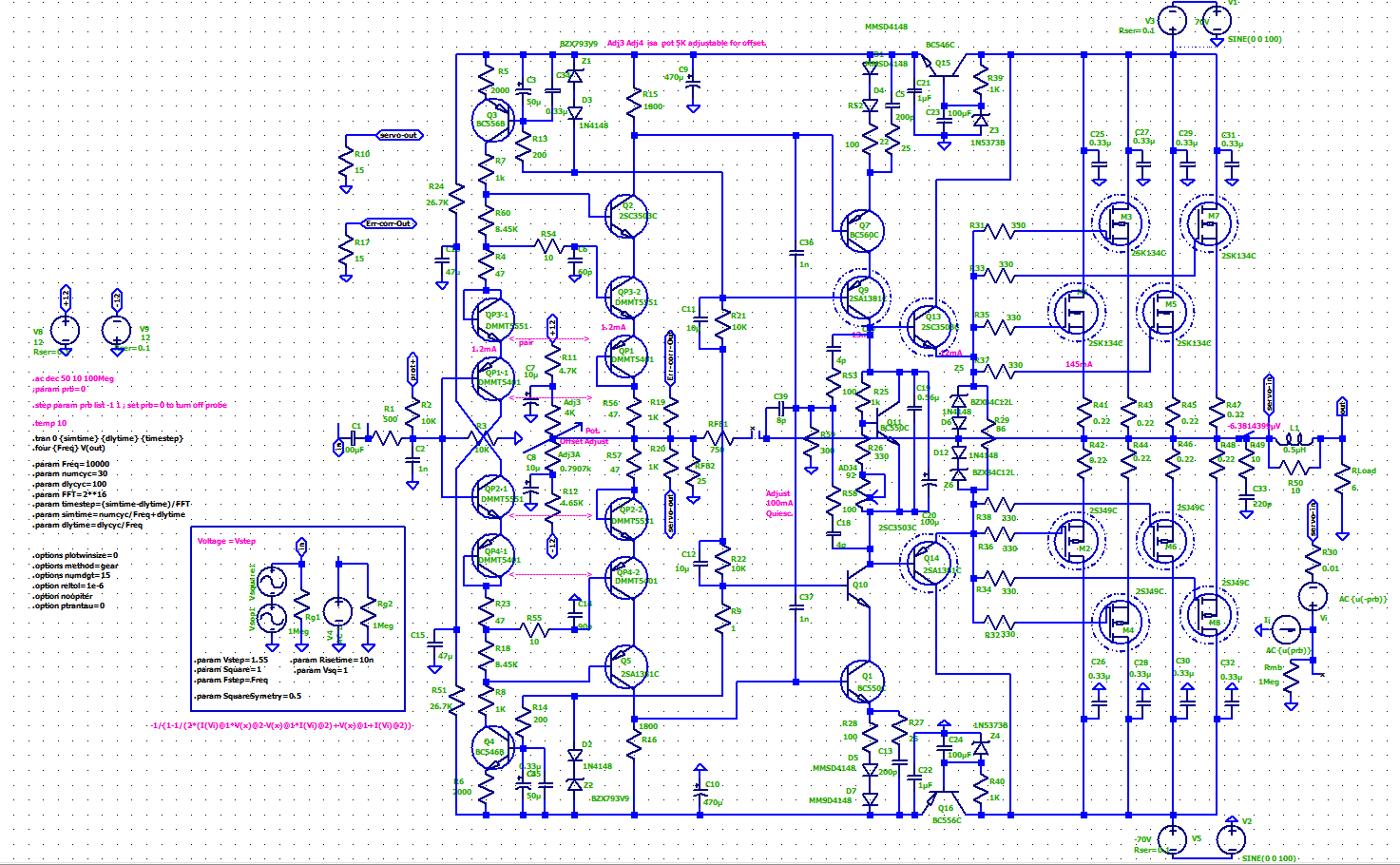

Krisfr, you can use this schematic for the paths as it is populated with all the options. Distortion is without "Error correction" (Amp alone).

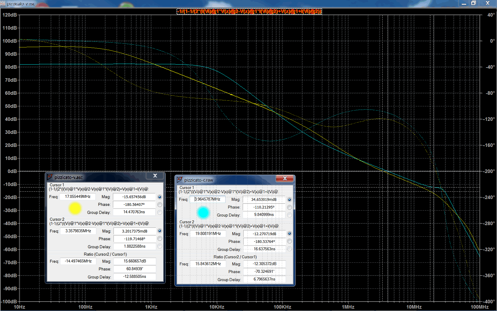

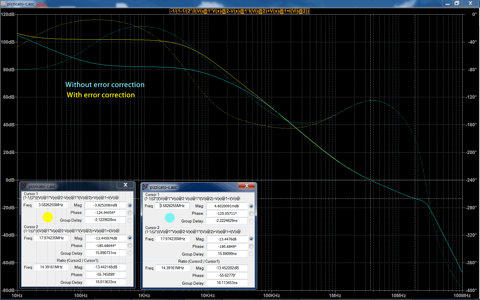

The two versions comparison.
The V one, VFA like (blue), offer more gain at low frequencies (Less distortion up to iKhz, more damping factor ). The C version, traditional CFA like) a flat open loop gain up to 10 KHz, faster slew rate. The two versions will use the same printed board, sharing most of the components.
Just a little change of 8 resistances values and 3caps. I suggest them to be in through holes for an easier swap.
As previously said, the purpose is to can figure out what matters more and how each version will impact listening results. And if the 10dB distortion reduction provided by the optional error correction will modify-it. Simulated results promize both versions to be in the top league. I will publish soon the two sim files, after everything deeply verified.

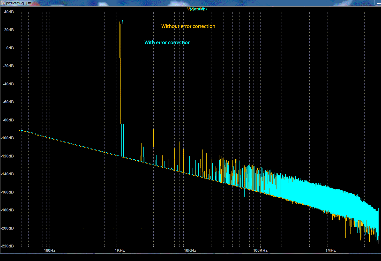

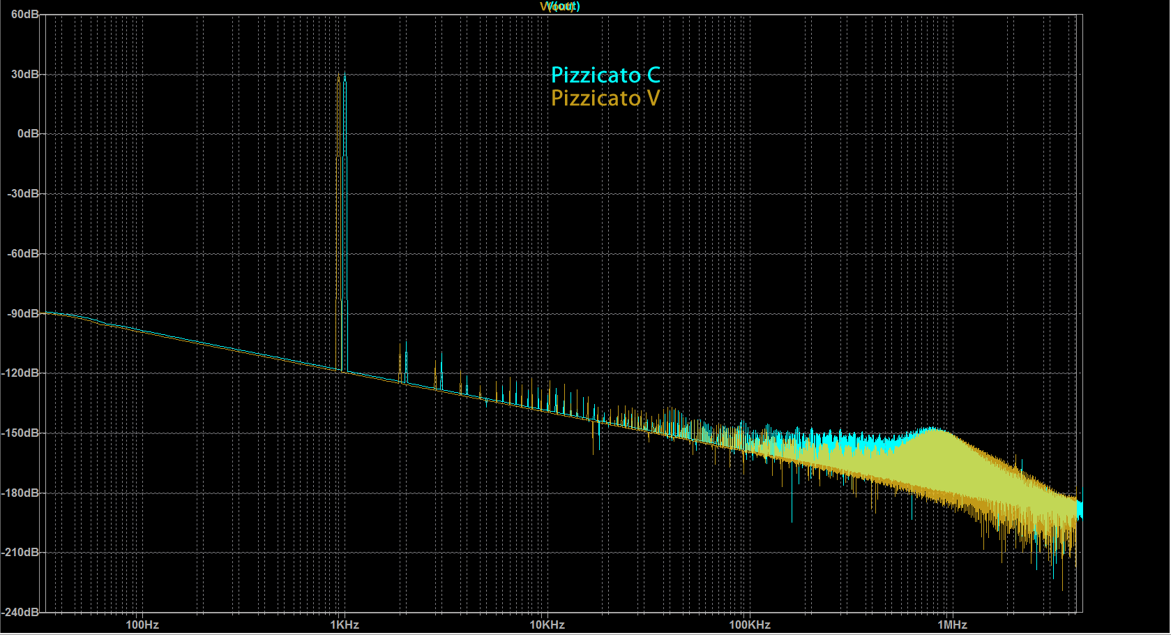

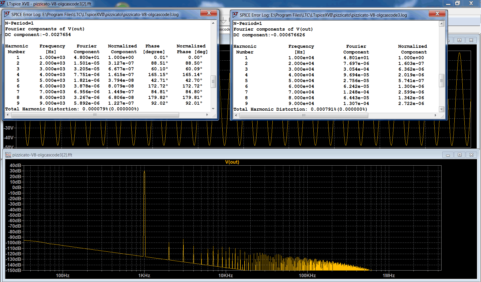

Comparison of HD with error correction.
Mistake with the colors, I inverted the colors with the previous image.
I apologize.

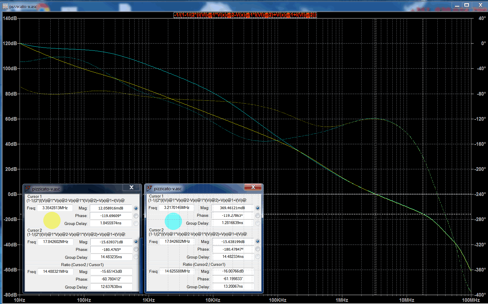

The last version V (Vfa like)
10Khz, 100V P.P.:
Without error correction: Total Harmonic Distortion: 0.000695%(0.000697%)
With the error correction: Total Harmonic Distortion: 0.000323%(0.000305%)

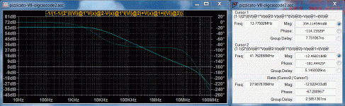

See (attached) the loop gain curves of the two options, with and without EC.

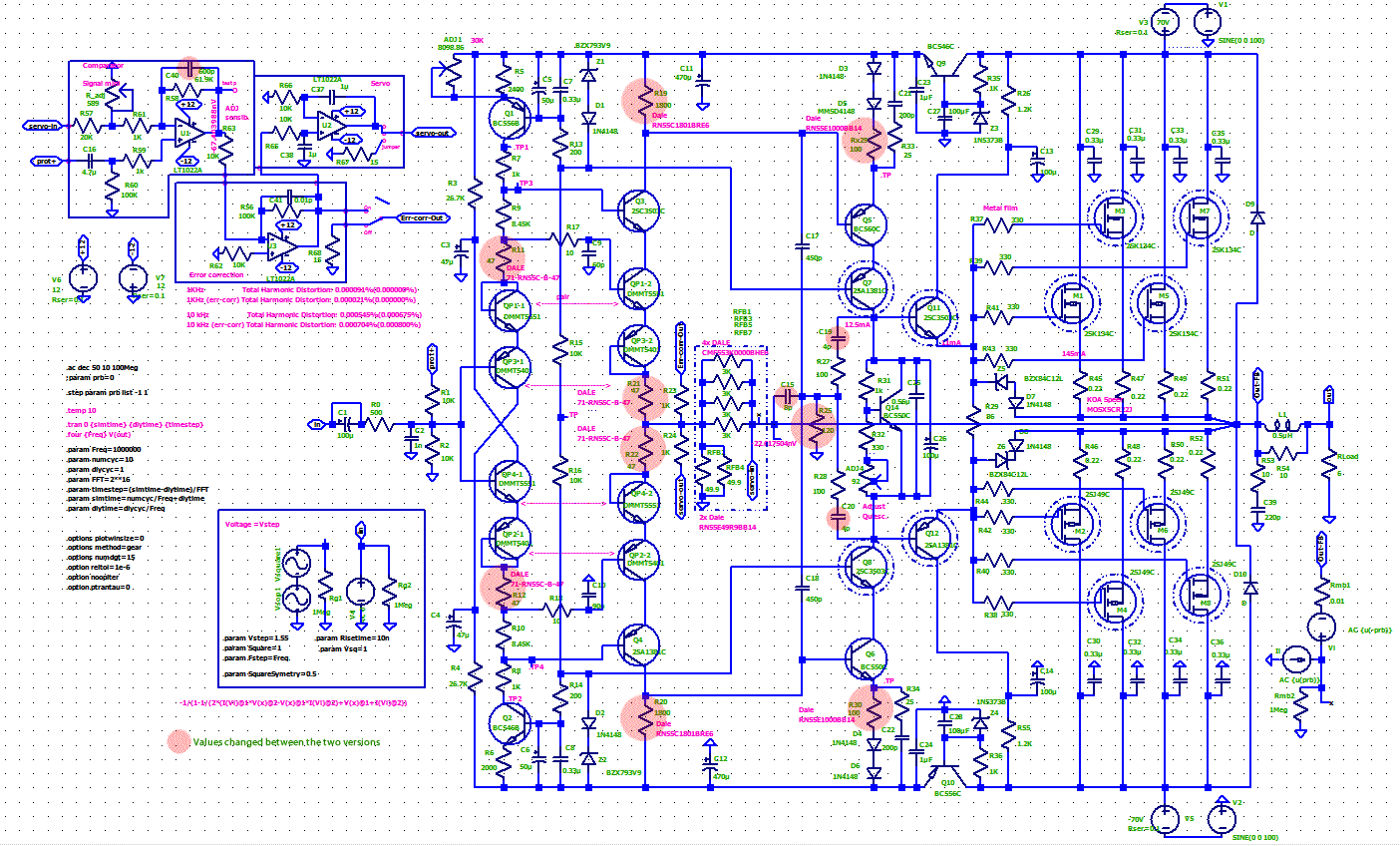

Krisfr, you can use this one as definitive for your printed board in progress 🙂.
The schematic is not going to change any more. In red, the values that gonna be different between the two versions.

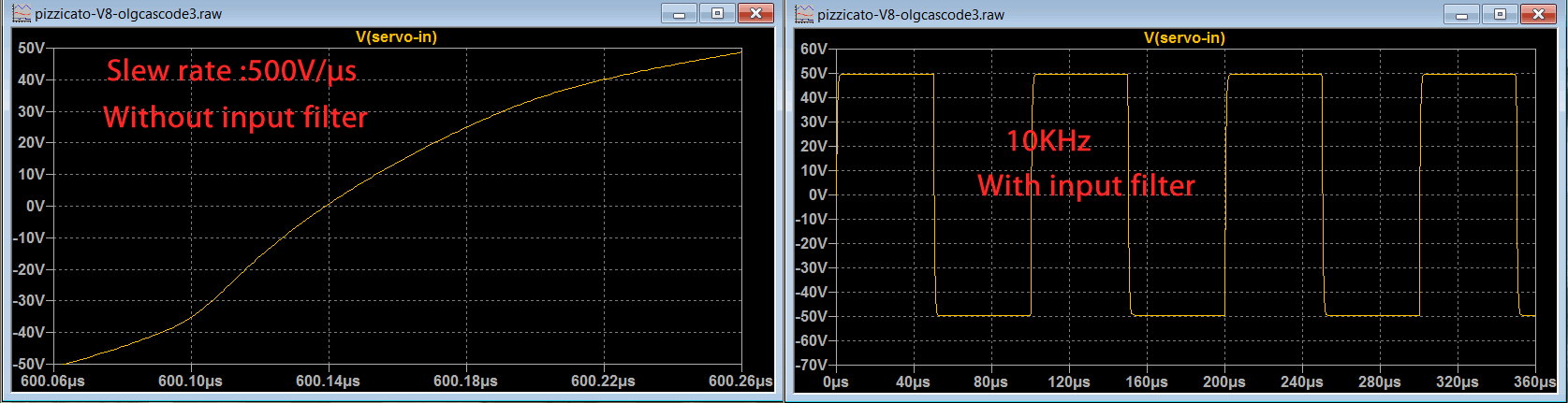

And, to conclude, the C version (CFA-like).
Pros: Flat OLG up to 10 KHz, very high slew rate.
Con: Increased distortion in low frequencies, little less damping factor.
That's all, folks.
