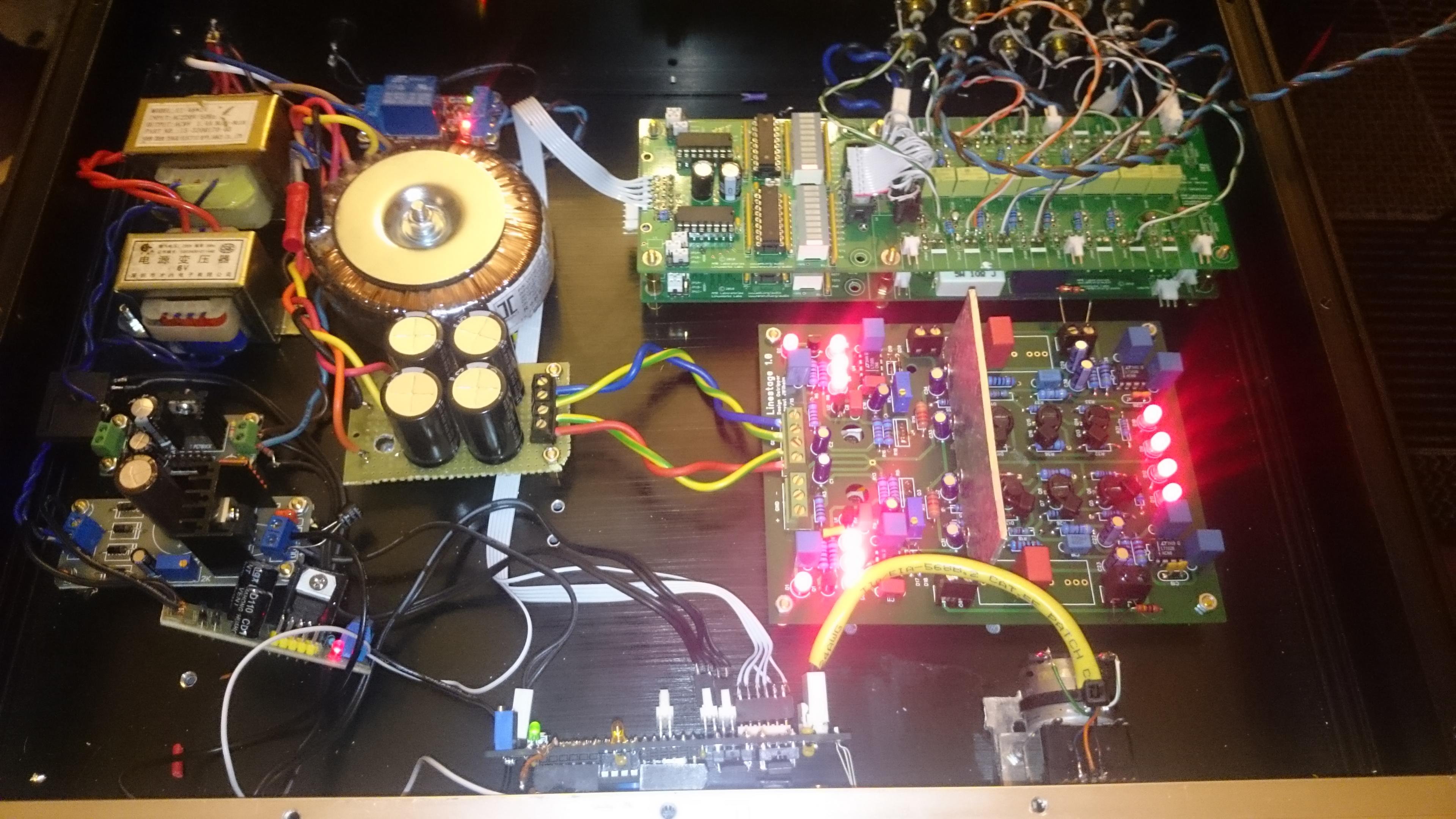

Just finished the linestage. I noticed that the heat sink on q9-10 17 and 18 gets very warm (to hot to touch) within 1 minute with power on.
Are my heatsink too small or is there something wrong?
I guess i should find some way to lead the heat to the chassis, I have no ventilation inside the case so I guess I will be in trouble when I put the lid on even with lower bias.
Will it affect the performance if I mount the transistors on the baseplate next to the board and connect them with wire?
