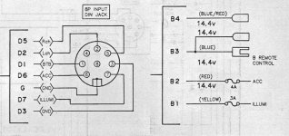

...I have find a electrical scheme and a short manual for my gm...
and I have read previous post but I don't understand how I can modify my gm120 for use it in a moderm car hifi... I know that someone have do this!!

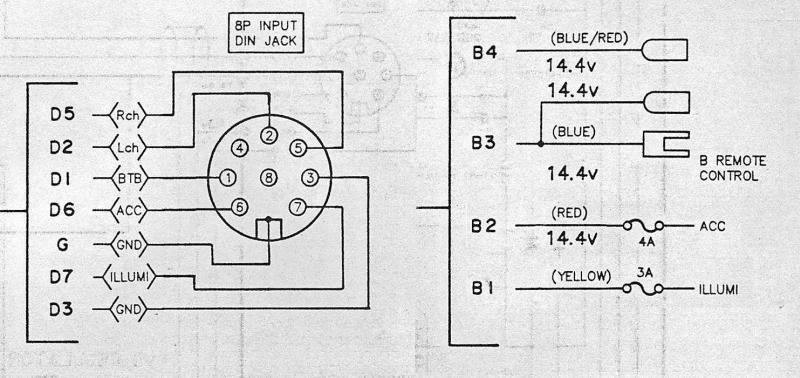

I've scanned the manual, but the schematic and overlay pages were each spread over two pages (overlapping). I'd like to combine them back to a single sheet. I don't have access to an 11x17 scanner to do them together.
Can someone suggest software that's good for stitching two scans together? I tried an opensource program that was intended for stitching together panoramic photos. It merged the two scans together OK at the edge, but the overall shape of the schematic ended up distorted.
