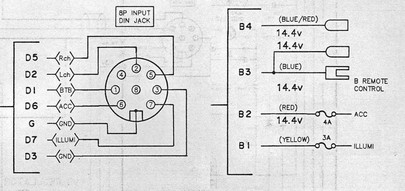

Any luck on finding out how to wire the GM 120 to a newer head unit?
I have the same question. I know it's a vintage amp, which is exactly why I want to use it in my vintage Supra. But I want to cheat a little and use a newer head unit. (In addition to the power wire, ground wire, and speaker outs), The amp originally used an 8-pin plug to attach only to vintage Pioneer head units for its input signal. I went ahead and cut and disected the cord trying to figure out how to connect it to a newer head unit. Inside the outer wire braiding (similar to co-ax), I found 3 wires: a red 18awg single conductor, an orange 18awg single conductor, and a grey multi conductor. The grey multi-conductor contains two smaller wires (red and white) surrounded by wire braiding (again like what you find in cable TV coax).
Anybody know, or even care to take a guess, (or can tell me how to test to find out), which wire does what.
The problem with using a new head unit is that the input sensitivity is only 70mv (70mv will drive it to full power).

I'm knew to electronics, so i still dont understand how to connect my GM 120 to a new head unit. It seems like I'd have to connect it w RCA connections. I have a Pioneer DEH-X55HD head unit, just curious if it would be compatible w the GM 120 amps. If so, could someone tell me how to make this happen. Thanks!!!
One problem with the GM120 is that it is turned on by sensing the load of the head unit switching on.
I would advise leaving the GM120 in the museum and just picking up a newer amp that performs better and has better protection. $44 got me a 4 channel American-made RF 4-channel amp at a local pawn shop, but I've passed up $5 amps at yard sales. Check out collector auto parts swap meets as well; sometimes there's guys from wrecking yards with all kinds of gear salvaged from scrapped cars.
