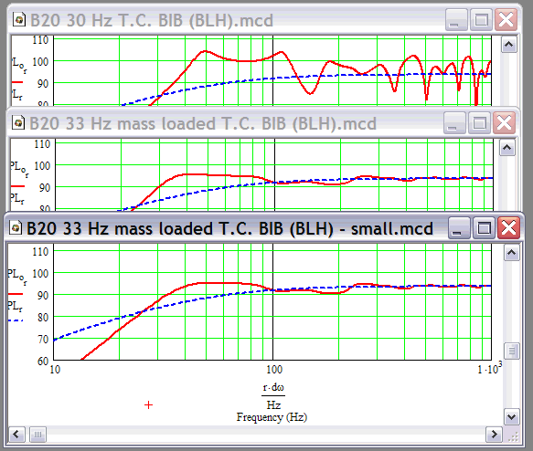

Well, I don't know if it's a good idea or not, but I know if you use the calculator it's a ~24 ft^3 cab regardless of path-length (height), so you won't be wishing for more acoustic gain. 😉 Shrinking it to ~12 ft^3 will require either floor loading or a large vent cutout. Ditto a ~6.8 ft^3 vented variant which is about the smallest BIB that will have probably enough acoustic gain to not need any BSC.
Anyway, the bottom two sims use a 3/4" baffle thickness vent in a blocked off terminus (Sm):
GM
planet10 said:
I'm no BIB expert but that doesn't sound like all that great an idea... Scott, GM?
GM
