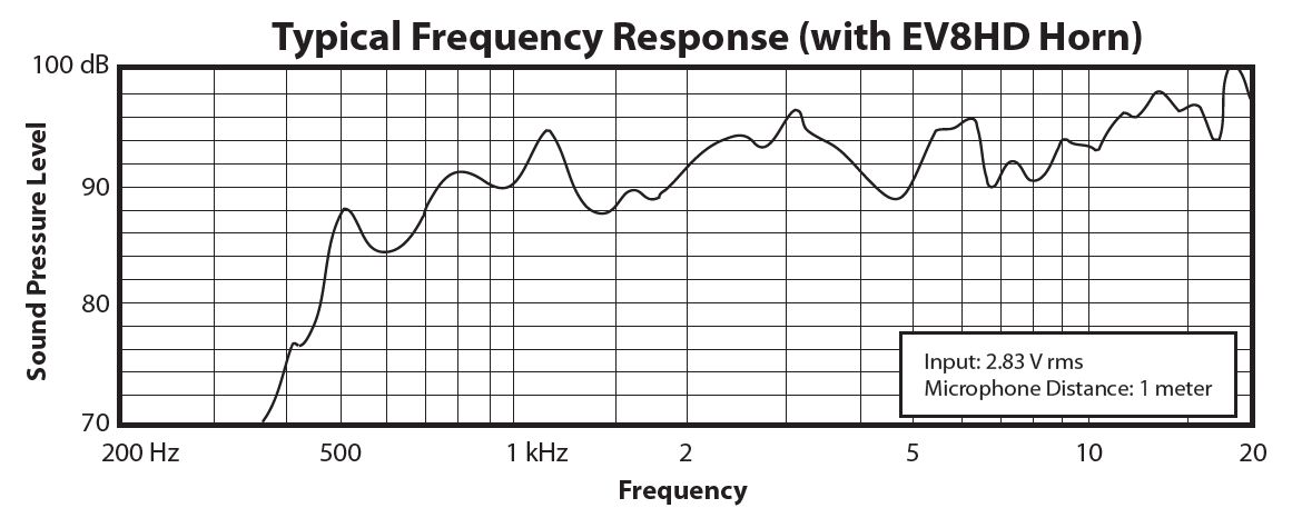

The beauty of using active crossovers is that the speakers can be coupled directly to the output of an amplifier, if the amplifier input is tailored to the driver response. The KSN-1188 go down to 500 Hz, but looking at the graph response I would not push them below 2 KHz.
