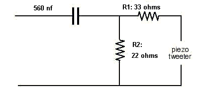

What driver?
That Motorola?
Have you tried a very low value cap, like 470~560nf?
1uf already sounds bad. They are very sensitive in the midband.
Also, the value of the resistors (mainly the parallel one) is critical, to attenuate the tweeter to the level of your mid/woofer.
You spend some time to tune it by ear, but it pays.

What driver?
That Motorola?

Well, the initial schematic that I saw somewhere on the net had a higher value cap, don't remember what exactly...
These values I posted are exactly what I have, after listening tests and tuning.
Hell, I also don't remember how many years it was... 6...7?
Anyway, those Motorola drivers cost me at the time 25 Euros each. That I remember.
For this kind of money and the end result, there's anything that beats this.
Of course there is.
Exactly.😀

I match them with a pair of cheap fullranges.
And the amp is a cheap Harman-Kardon HK-620.
This is my forth system, it's on the basement. Not used very often.
Btw my tweeters are on independent rectangular little wood boxes.
With any speaker I have tried (including those cheap FRs) it transfigurates them completely to another level.
It's just a question of matching the crossover.
I've even tested them with my Epos speakers (instead of the Epos tweeters) and the results are very very good.
