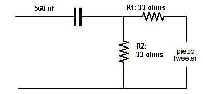

I use Motorola rectangular piezos on my forth😀 system, on the basement.
They sound like a million dollars, but some years ago I've spent a lot of time testing components and tuning a crossover for them.
Without a crossover or with "standard" values for a crossover they sound horrible.
They have a very fast (oh so fast...) and detailed sound, it really reminds a live performance, the real thing.
They have to be crossed over quite high to sing like this, and attenuated to match your mid/woofer.
Only this way they produce gorgeous midband and treble.
I would have to open the speaker to see the component values I used, but in my head, from what I can remember, it's something like this:

Carlos,
That's the one I was talking about in post #5
Those actually sound OK. It's the one that I used with a coil in series along with a pair of 12" woofs in a cheap and dirty 2 way. Surrey speakers if you will. (local humour)

Anyway, if someone has Motorola piezos, give a try to this crossover, even without making a speaker.
Try it, listen and say what you think.

Yo Carlos.....
.. where did you get that circuit from I wonder ;-)
notice you have raised the parallel resistor from 22ohms to 33ohms, but the cap value is very odd...??
do you mean 5.6uF ?? (=5600nF)
do you reckon it smooths things out even better than the 22ohm, 3.9 or 4.7uF combination.
Also you should note that the 33ohm in series with the tweeter will need to be adjusted depending on the sensitivity of the main driver.

I found this circuit some time ago, don't remember where... I saved the page on my HDD.
That page had a table for the cap to be used depending of the cut frequency you whant to use.
The table was all in the uF range, and the resistors were 22 ohms.
I used it as a starting point, but everything sounded bad, and I ended up with these values.
No mistake, it's 560nf.
You can use values above to match it with your drivers.
Test this with 560, 680, 820nf.
Don't use much higher values than this, because with these drivers midband will jump on you in a way that's not pretty.😀
I think that these small values work better with this tweeter because it seams to be much more sensitive in the midband than in the treble.

Hi Carlos..
That circuit diagram is from my old web site, as is the scan of the specs etc.. 😀
That's why I was so interested in the changes.. I'll have to try then sometime, see what happens.
