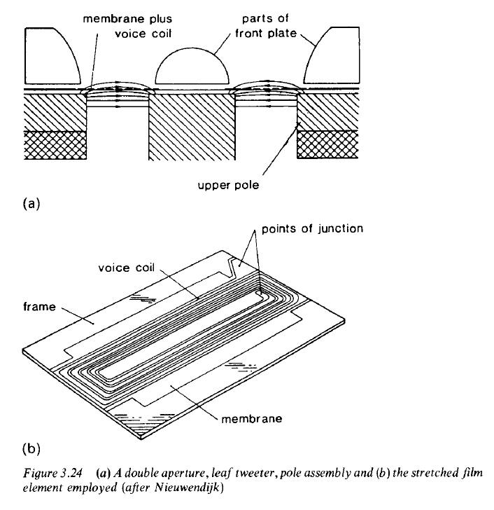

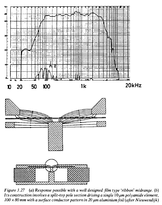

...I remember seeing the Nieuwendijk tweeter in an earlier edition of Martin Colloms' "High Performance Loudspeakers" book. I think it had a central magnet but I'm having a hard time tracking down the figure I can remember.
Was it one of these?

kind of weird, response down to 100hz. with a foil of 80x100. not that much. overal it is identical to any other planar if i look at the coil.
The coil is same as others BUT the overall diaphragm is VERY different.
If you scale that thing up you will see that the diaphragm is WAY big, like 8-10 inches wide, but small area driven. Then its critical to notice that the iron pole parts are flat solid surfaces very close to undriven area of diaphragm. This method damps the undriven diaphragm areas well AND allows a very low resonant frequency at the driven area.
I believe the large undriven and well damped area is kindof a lossy place for vibs to dissipate rather than reflect back to driven area from frame.
Ive made protos like this ( but using typical planer magnet configurations) and the response is very smooth into lower frequecys where a small diaphragm goes crazy
