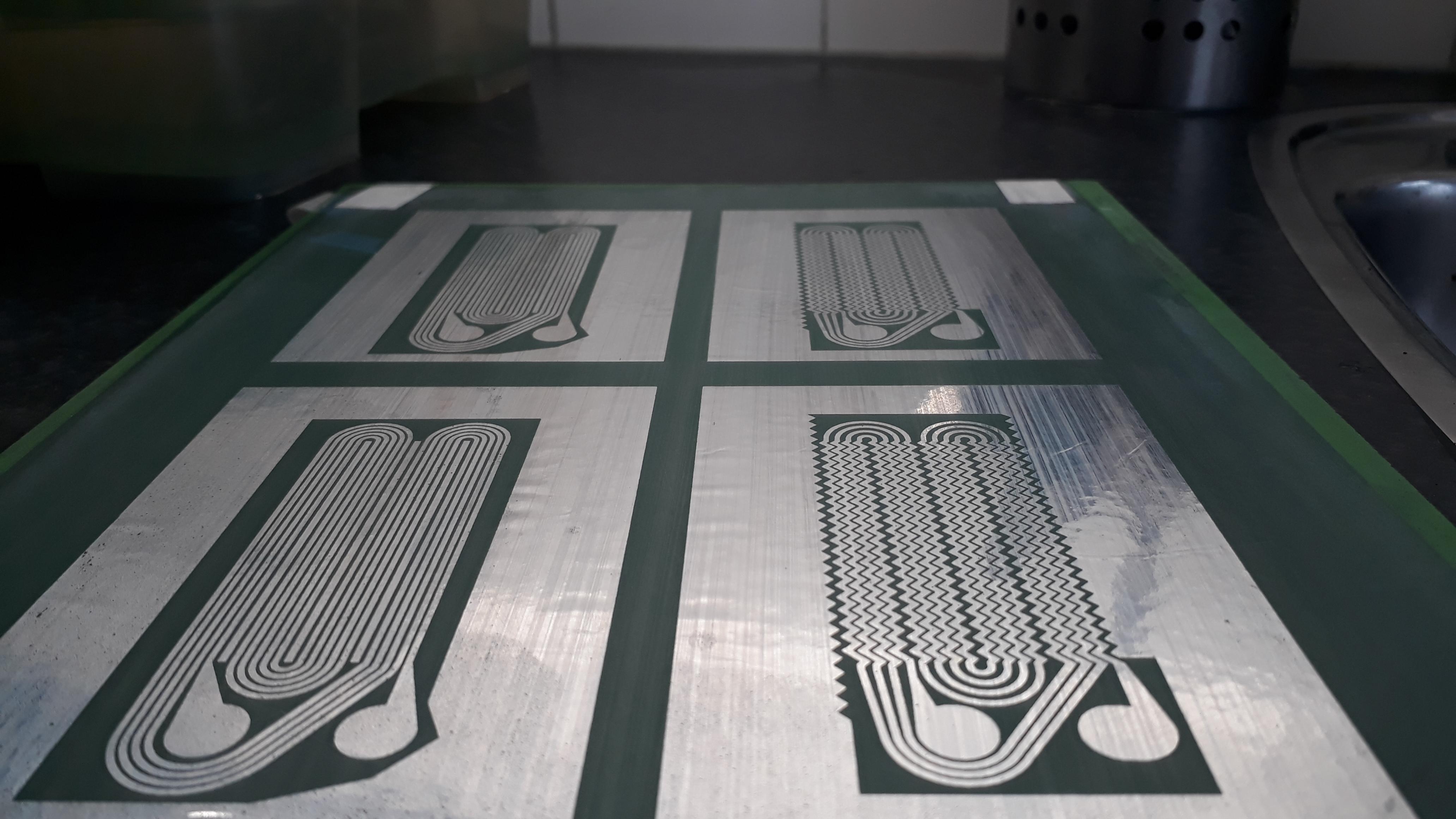

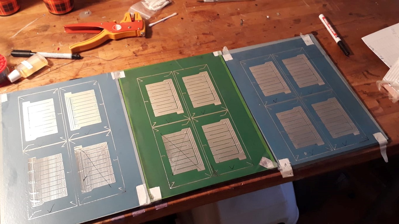

I use the printer everyone should have if you do anything with this kind of stuff. a Xerox Solid ink printer. it prints wax, that functions as etch resist. only good for prototyping i think, since it sometimes it is a bit inconsistent . might be the age of my printer. but sometimes adhesion to alu is less then ideal and create pinpoint holes. overall i can make consistent foils but i have to match them, say 3 out of 4 an then maybe one sometimes even 2 i have to scrap. i bought it for flexible PCB used in the Rubanoide voice coil. it works better on the copper then alu.
I just made these i had a weird idea of using wrinkling traces Really no idea where that came from ;) but i dont know if it even brings anything but , you need to try if you want to know in this case.
You can see on the left there are some defects in the outer ring, not a problem, but adhesion to the alu remains hard, i try to clean it as good as possible. but stil. any one has an idea ? i used alcohol,thinner, and amonia. but it remains hit an miss. i also scuffed it a bit. but seems still complete random :)
with bigger coils i can path some defects with a sharpie, but with this small stuff and trace distance of 0.3 is tricky to patch up, usually ends in redoing it

WrineX
I am really interested if you hear or measure any difference with the zig zag
is the "wax" an ink? or is there a special cartridge for that?
also what foil/backing/adhesive types and thickness are you using

Thanks lowmass ill try that , i first thought about maybe pre etch ? with a light acid ?
The wax is the ink it self it comes in way overpriced blocks :) as usual :)
well results in a push pull magnet system
I tried one panel heatgunned. and yes!! they stretch really nicely ! except where the arcs are to go down again , but there is not need to put heat there or make sure the arcs are on the frame and not on the foil.

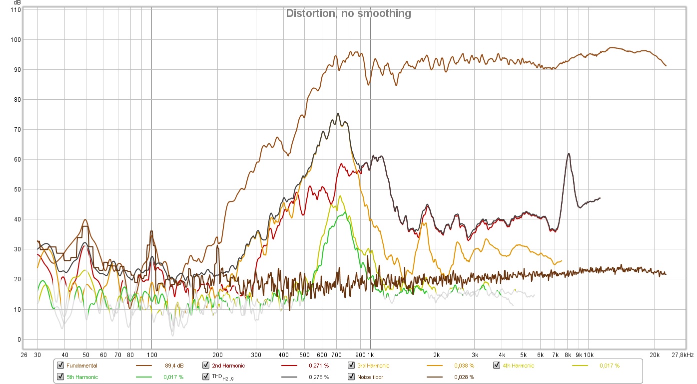

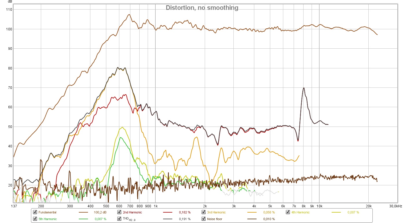

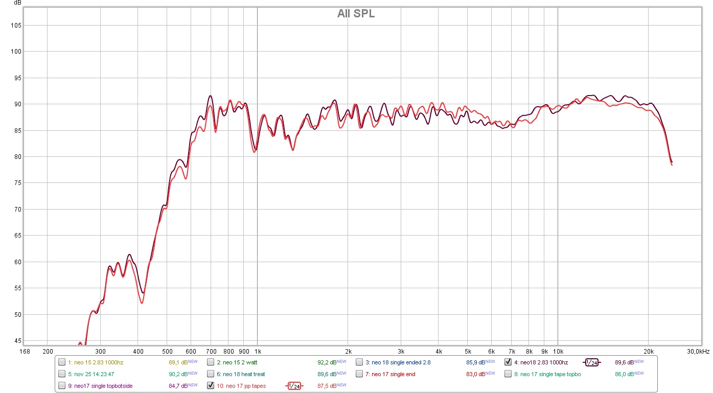

One thing to notice is the wiggled version has a DC impedance of 5.1 and the straight 6.8, while they measure as loud at same voltage. the straight one is a bit more efficient if same wattage was used.
Measured in room @ 1 meter no baffle
PIC 1 on freq response of both. dark red is wiggle red is straight
PIC 2 distortion measured a 2.83 volt @1 meter in room without a baffle Wiggle
PIC 3 Straight has lower distortion then the wiggle. but its not major. the weird peak at 8.6K i need to find still. as seen in previous pic i left soem undriven alumnium there. might need to replace that with driven alu to make that undriven area as small as possible

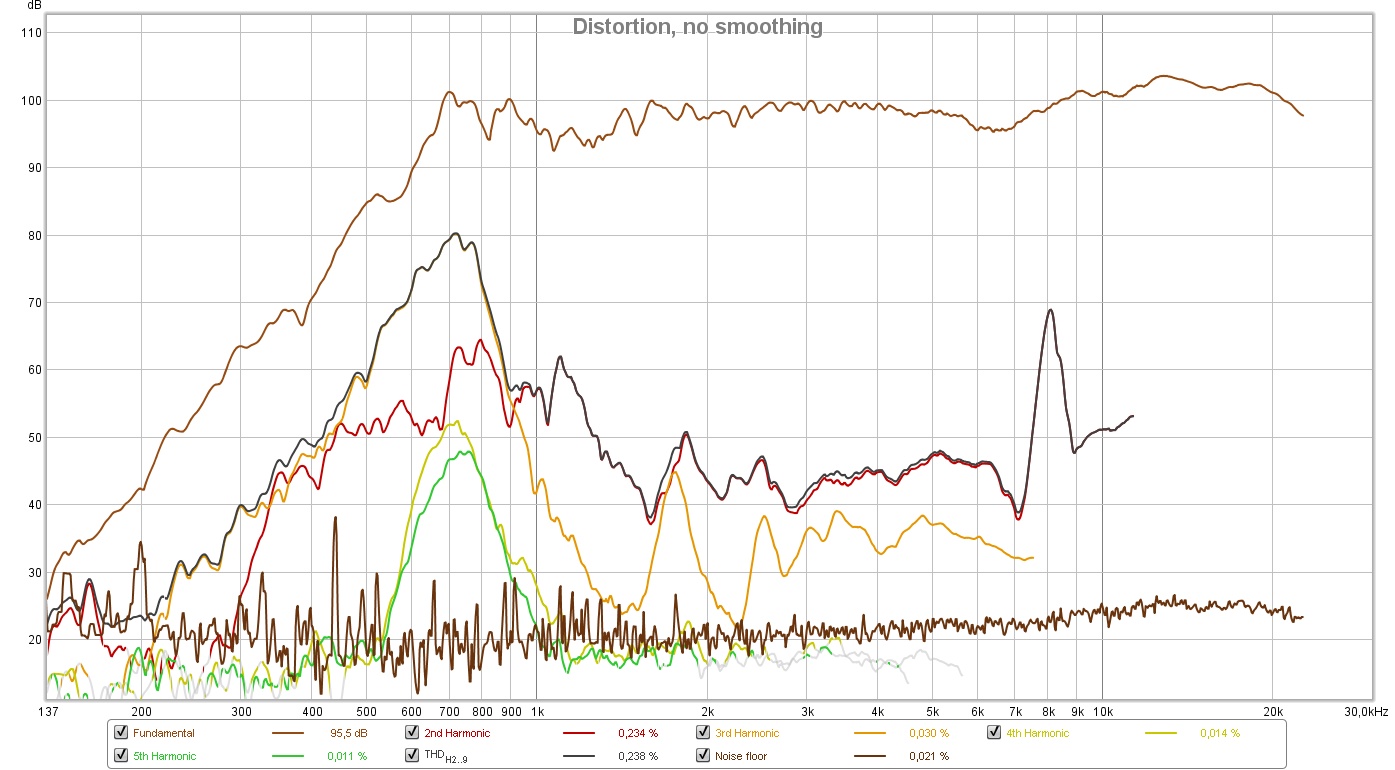

Hmm maybe that peak is where the zig zag magic is? Might have to do a few samples to be sure
the insane peak is on the non zigzag. i am not to worried about it i can get rid of it. but it is also clear it is less in the zigzag. just overal distortion is slightly higher in the zigzag, and ouput although lower impedance is the same. hmm might be able to cramp in another zigzag winding.. :) maybe that solves some. i think the rest of the distortion is most likely top and botton and sides. so the actually NOT driiven area near the edge of the spacers
yes I understood the peak is in the straight trace version, was saying maybe zig zag solves it?
I would expect zig zag to be just a bit less sensitivity because as you mention the alignment with magnet flux not as good as straight. That said , non symmetry is a way to smooth things out sometimes
BTW I find it best to do distortion measurements at a bit higher volumes. Around 95 db at 1 meter or even higher. Seems sometimes things are hidden at lower volumes
Looks terible :) but actually not that bad.. near resonance not nice of course and the peak..... well that peak has to go

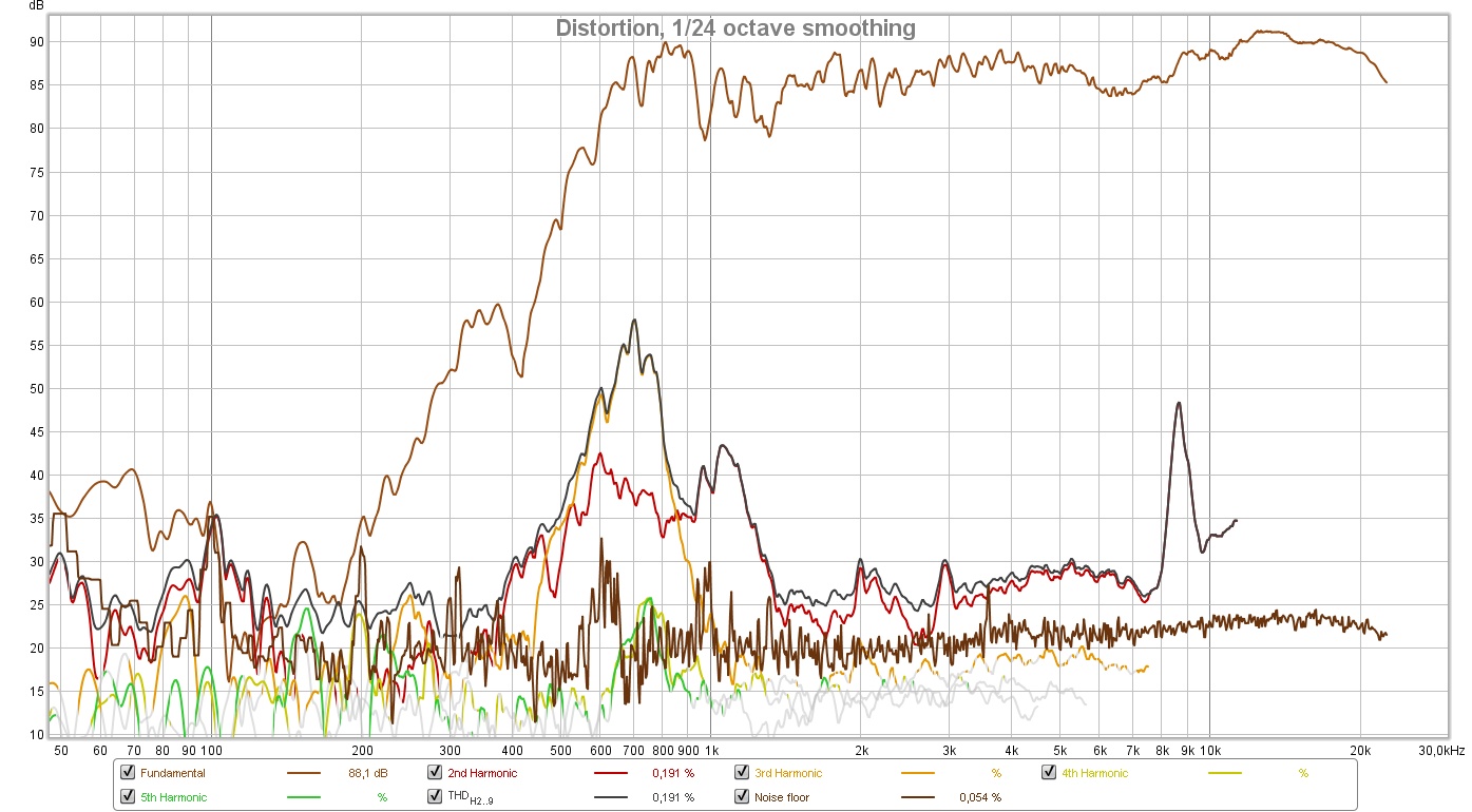

i wonder how much room becomes a thing here. ill move it 50 cm and need to substract 6 db lets see

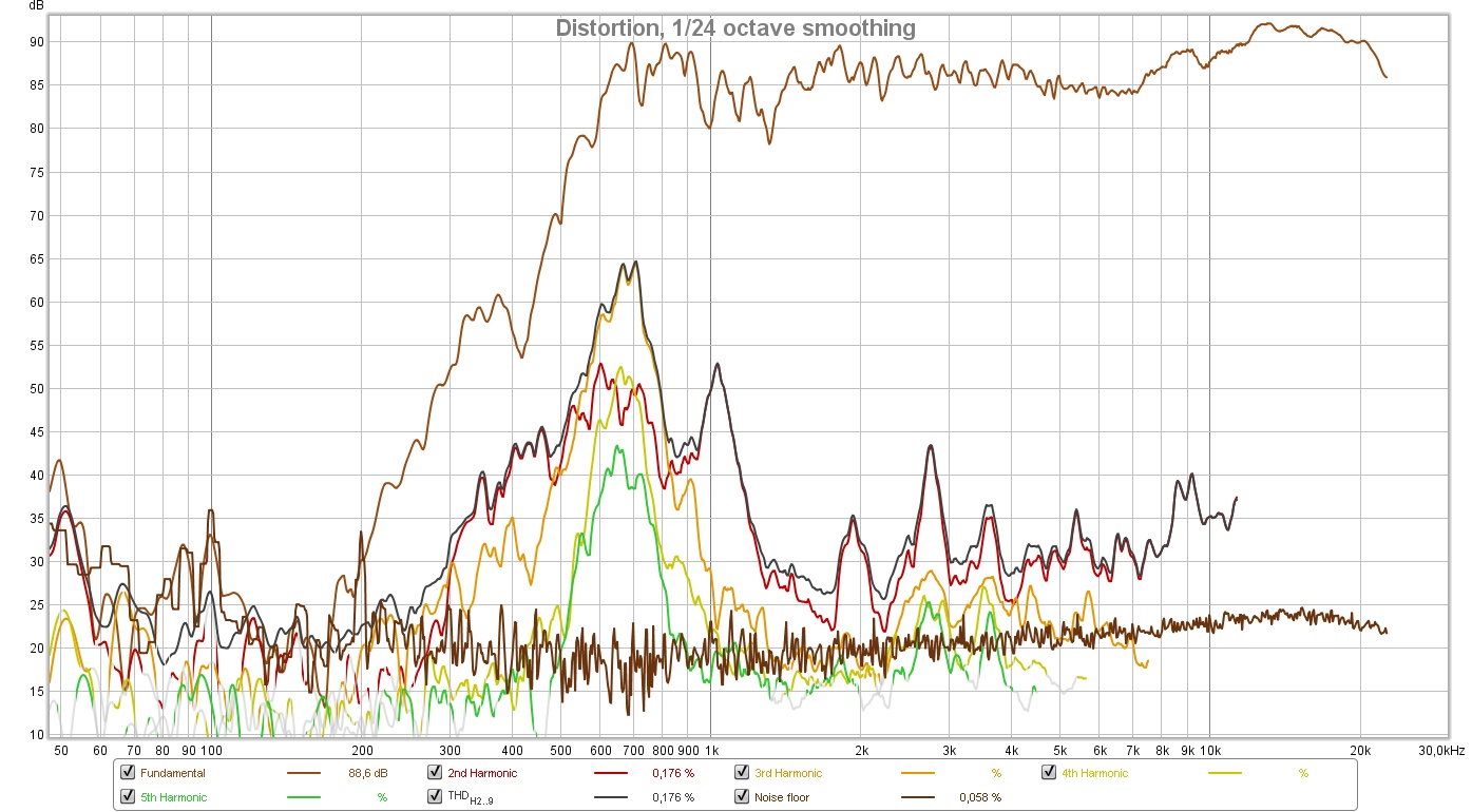

here is the same at 50 cm pic one
and at 50 cm with horn pic 2
weird output goes up and flattens with horn, but distortion rises as well. mainly second order 3th remains the same. maybe because i got a open back on the horn ?

weird output goes up and flattens with horn, but distortion rises as well. mainly second order 3th remains the same. maybe because i got a open back on the horn ?[/QUOTE]
if you bring horn volume down to same level as no horn the distortion will be lower
also if you tame the resonance a bit with some felt or screen restriction on backside of driver you may see a big reduction in distortion
really nice response with horn ! have you done any off axis response curves with horn? I would like to see what directivity looks like
