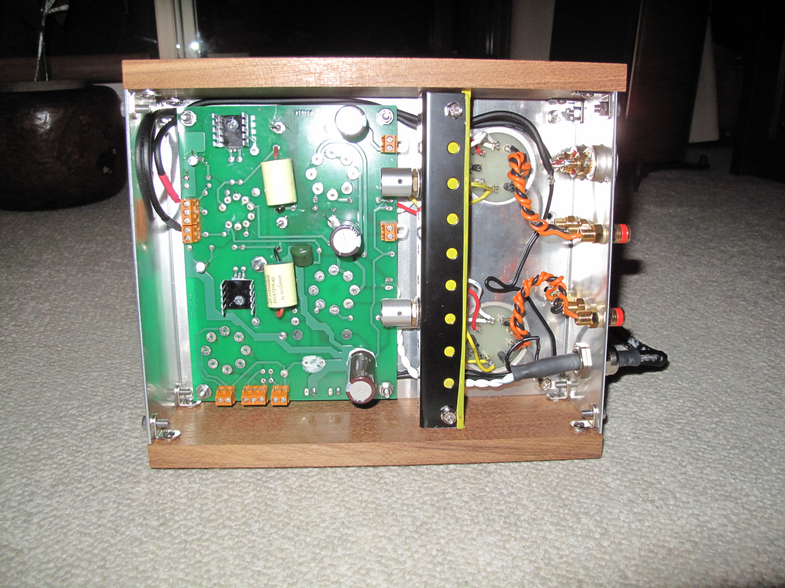

Beautiful work! Looks like you are very meticulous and creative. You are making me jealous by saying you like it better than the Simple SE. 😛
Pictures were taken with a Canon G10.

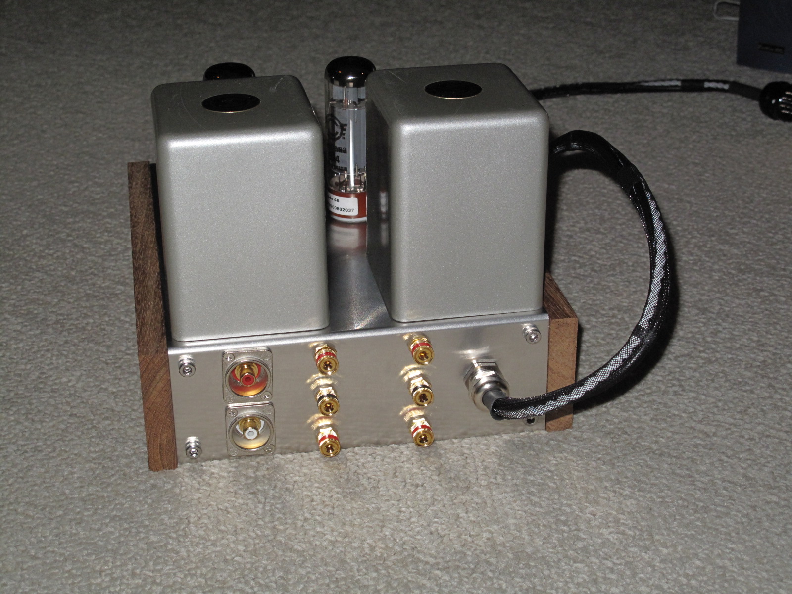

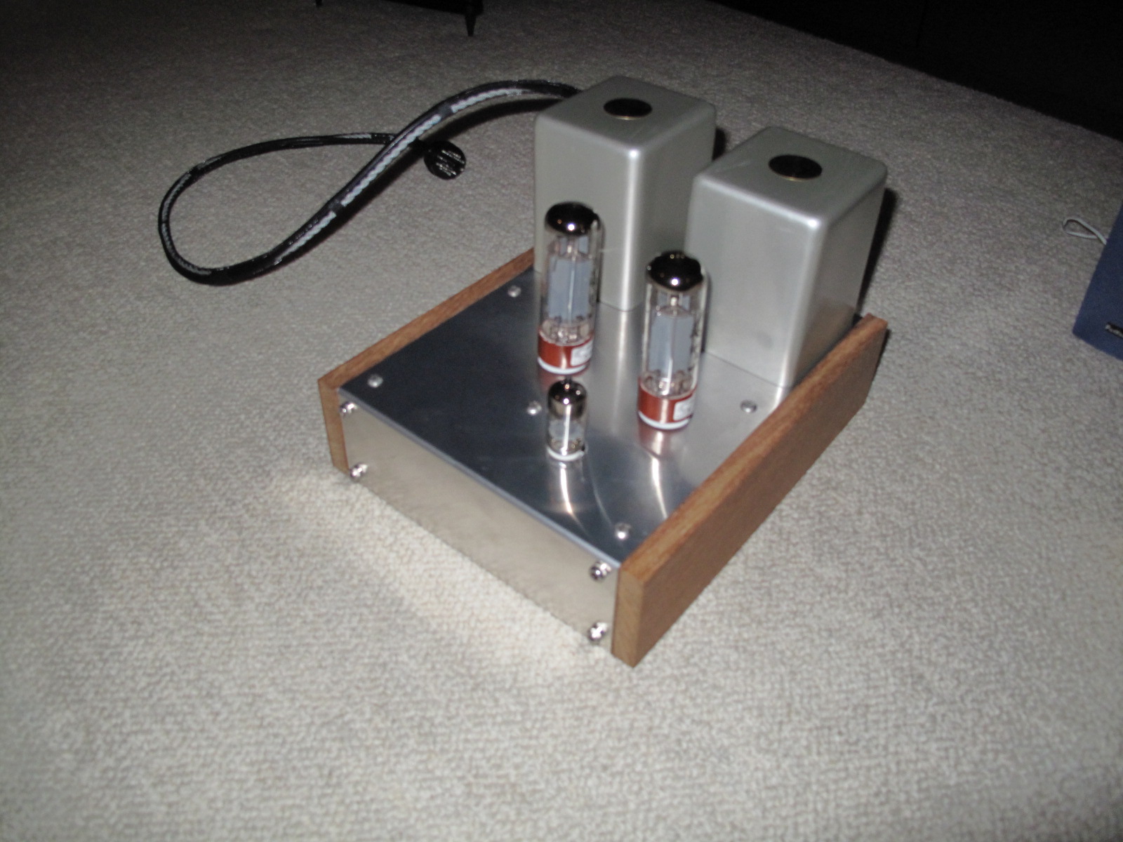

For the umbelical, in the amp the cable has no connector, goes directly in the chassis. The cable is done with two coaxials (for B+ and B-) normal cable for grounging (shielding are connected only on PSU side) and shielded twisted pair for the AC6.3.
On the side of the PSU, I did not decide yet, as you can see the psu is still in progress. Now I connect wires one by one, I almost destroyed everything with a stupid mistake.
The idea is to try the Salas HV shunt regulator, once the PCBs are ready.
I have some connectors that look like valve sockets, I think I am going to use that.

Ahh very nice. In my opinion, ditch the EL34s and use some KT88s. I like the Penta labs KT88s. They have a much fuller sound with a deeper soundstage. Interesting use of a "universal" power supply. 🙂
The idea of the "universal" power supply came by chance. I live in Japan, but I will move in few years back to Europe, so I did not want to buy a bunch of 100 V power transformers, and here is very difficult to find multi voltage transformers.
The Tubelab SE uses the 5UGB as rectifier, that gives me 380 V B+. The SimpleSE uses the 5AR4 that gives me between 410 and 420 V depending on the tubes.
The PS has good components, the first cap is a 22uF Solen fastcap and the second a 200uF Film Mylar. In between a 10H 81DCR choke. I had to add the B- part to support the tubelabSE.
At the moment the B- circuit, is manually disconnected when I use the SimpleSE, I am not sure if this is really necessary. Any input ? I would love to solder it.
I am curious to see the impact of the PS on the sonic, so next I want to assemble the worst possible PS, using a 2$ bridge and cheap caps to see it my non-gifted hears can hear the difference. Next I would like to try various filters and regulators.

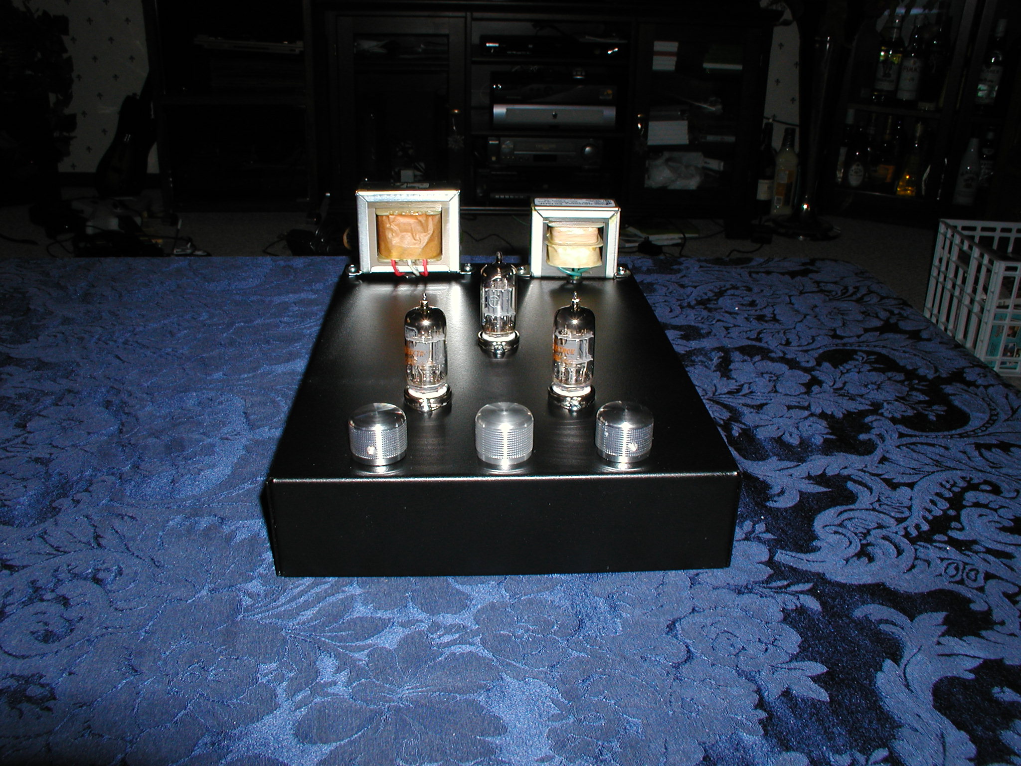

Here is a picture of the P2P preamp to go with my P2P S.E. amp. This preamp has a volume control as well as a Treble and Bass control. It is the perfect addition to the amp. I got the schematic off the net a while back. All the caps are Russian NOS PIO.

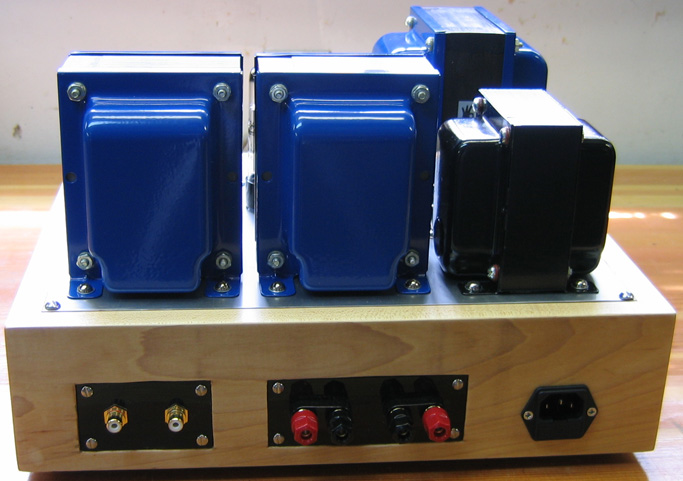

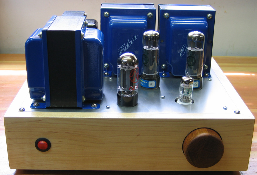

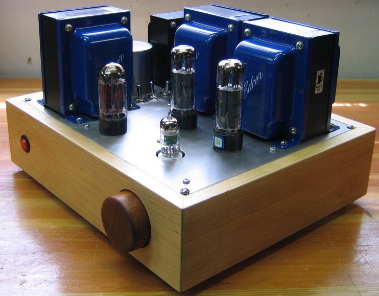

My SimpleSE
My first tube amp, and though it cost more than anticipated -- what diy project doesn't -- I think it's worth every $.01. Beautiful sound, makes my full range Fostex sing 😀
Pretty standard build, Edcor XPWR035, XPSE25-8-5K, Hammond 193J, 70uF motor run cap, .22uf Auricaps, EH-EL34, JJ-GZ34, Jan-Philips 12AT7WC.
Very nice indeed!My first tube amp, and though it cost more than anticipated -- what diy project doesn't -- I think it's worth every $.01. Beautiful sound, makes my full range Fostex sing 😀
Which speakers are you using?
