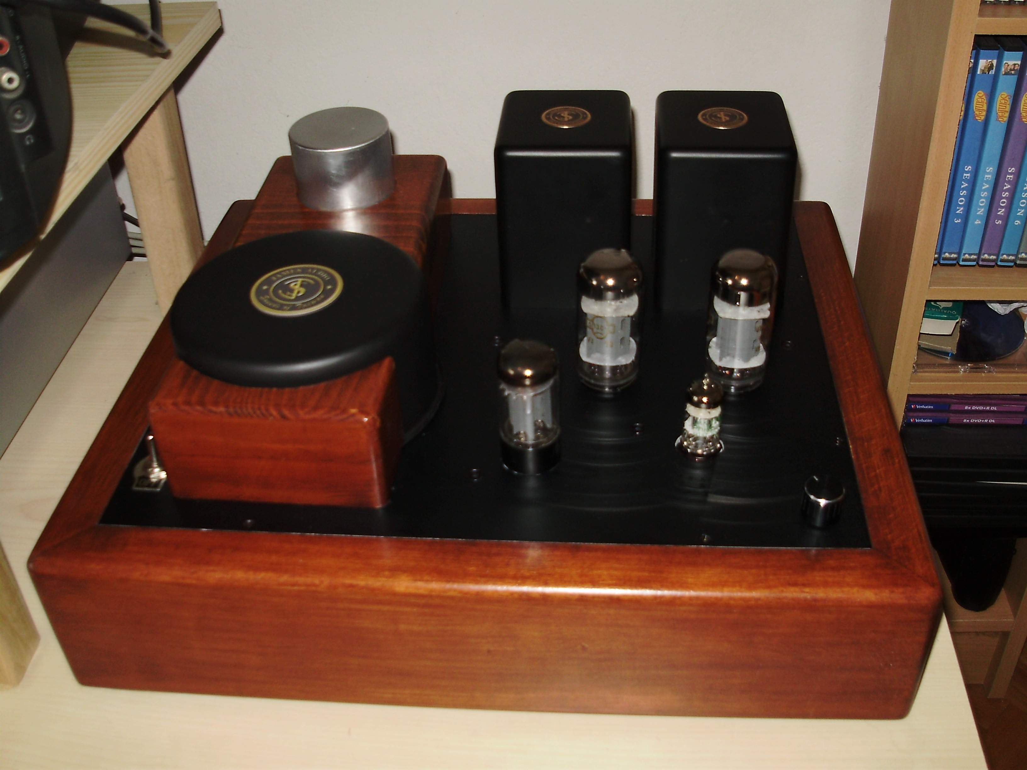

Well this thing is about 99.99% done. Still have to toss on the knobs, trim some of the shafts and add a few bolts. I took these pictures while testing it so nothing too exciting I still need to switch out these tubes and toss in my nice ones. It is sounding pretty good so far 🙂 It is nice to finally have a working amp again. You can't really see it in the picture but the sides are walnut and there are adjustable bias switches behind the large capacitors. UL/Triode and feedback switches are on the back panel.

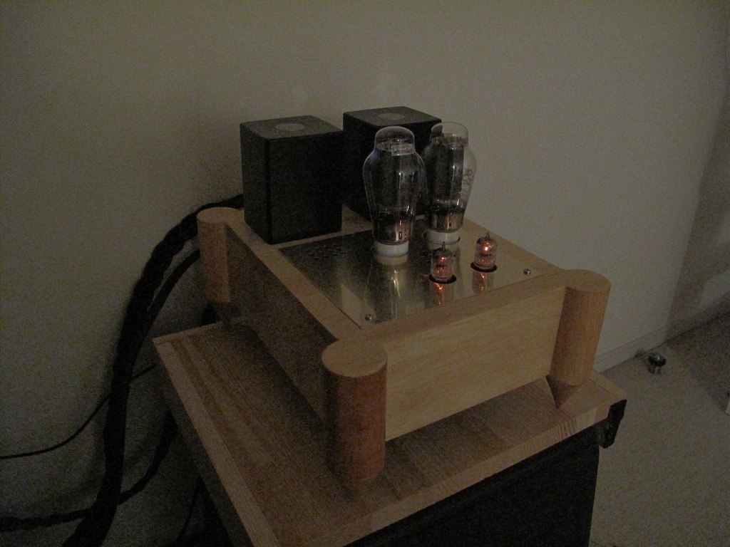

Here's my latest build:
Prior to completion, to show Connectors.
With my other amp
Made this one Triode only since I preferred triode by a wide margin on the last build.
With my other amp
Very Cool... Spalted Maple is my guess.
I might remove the CFB and UL switches on my amp. I have some Mundorf hook up wire (99% silver, 1% gold) I might use to rewire the OPTs too...
Actually spalted maple and the frame is walnut. Spalted maple is very hard to get and expensive! It's even harder to work with according to my buddy Cal who made the box.
Edit: posted right after Dave. Good guess! I am noticing deeper sound field without all the CFB UL wiring switches etc. I am also very pleased with the sonics the Silver/copper I have been using.
Posted 1 min earlier than you 😀

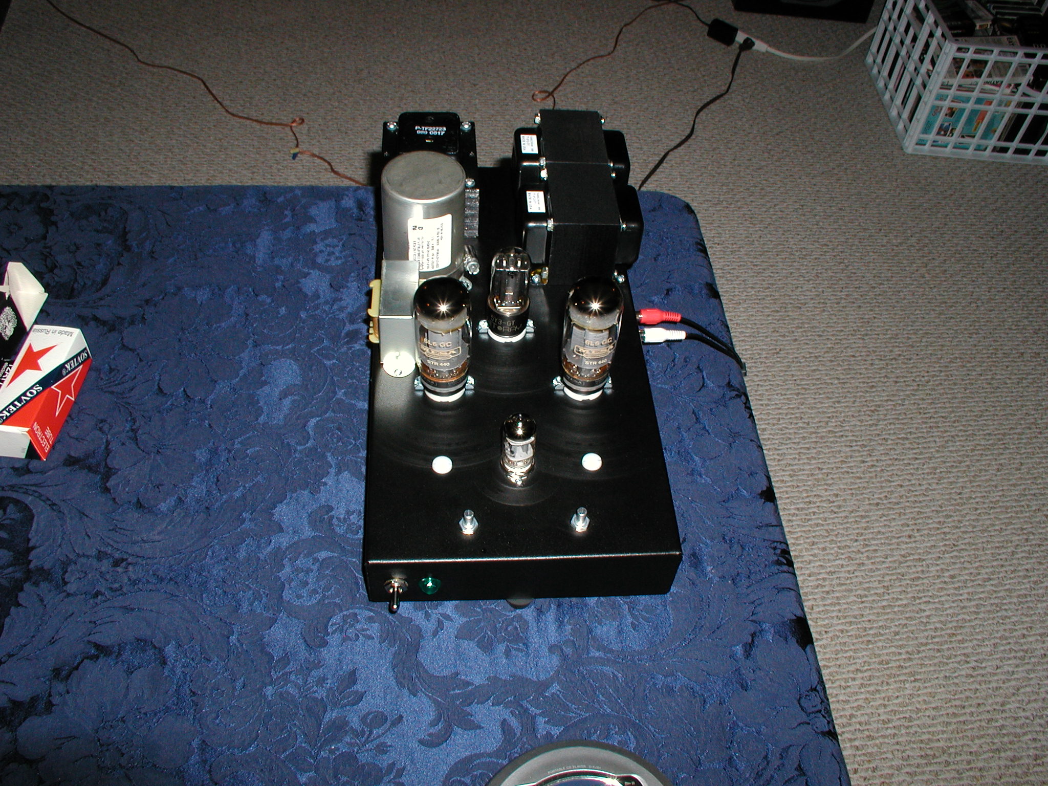

Well here it is the Point to Point Simple SE. I finished this little amp in about four days, I worked on it in the evenings.
I used transendar output tansformers. For the B+ I used two 10H 90ma chokes in parallel and a 100uf motor run cap and a 33uf electrolytic for the first cap. The amp is very quiet, you can't hear any hum or noise between songs. It sounds as good as the other amp I have on here.
I can change the B+ by changing the rectifier tube, the 5y3 will give me 360v and the 5AR4 will give me about 430v.
This was a fun project and easier than I thought.

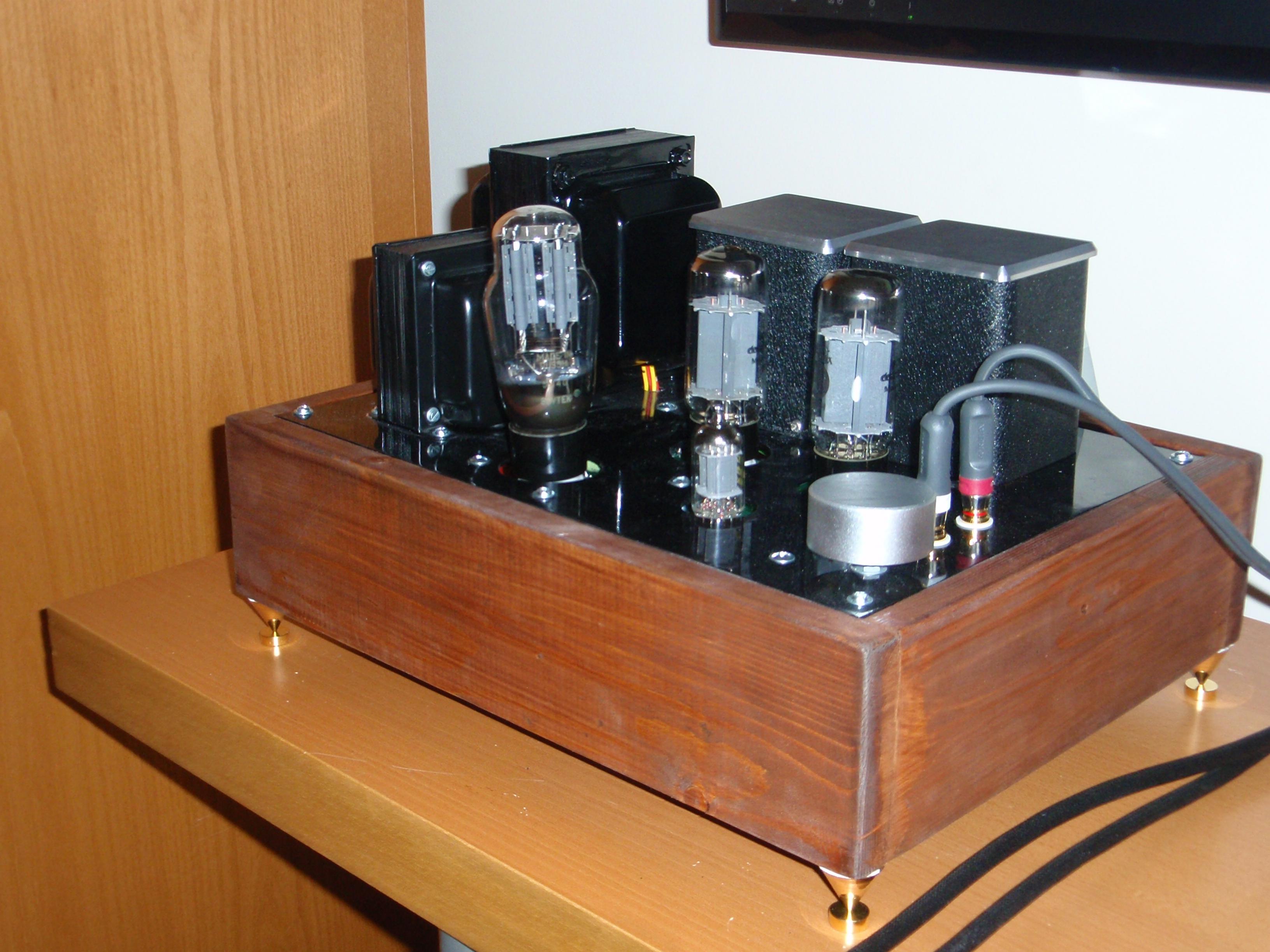

Questions.Here's my 6A3-SE.

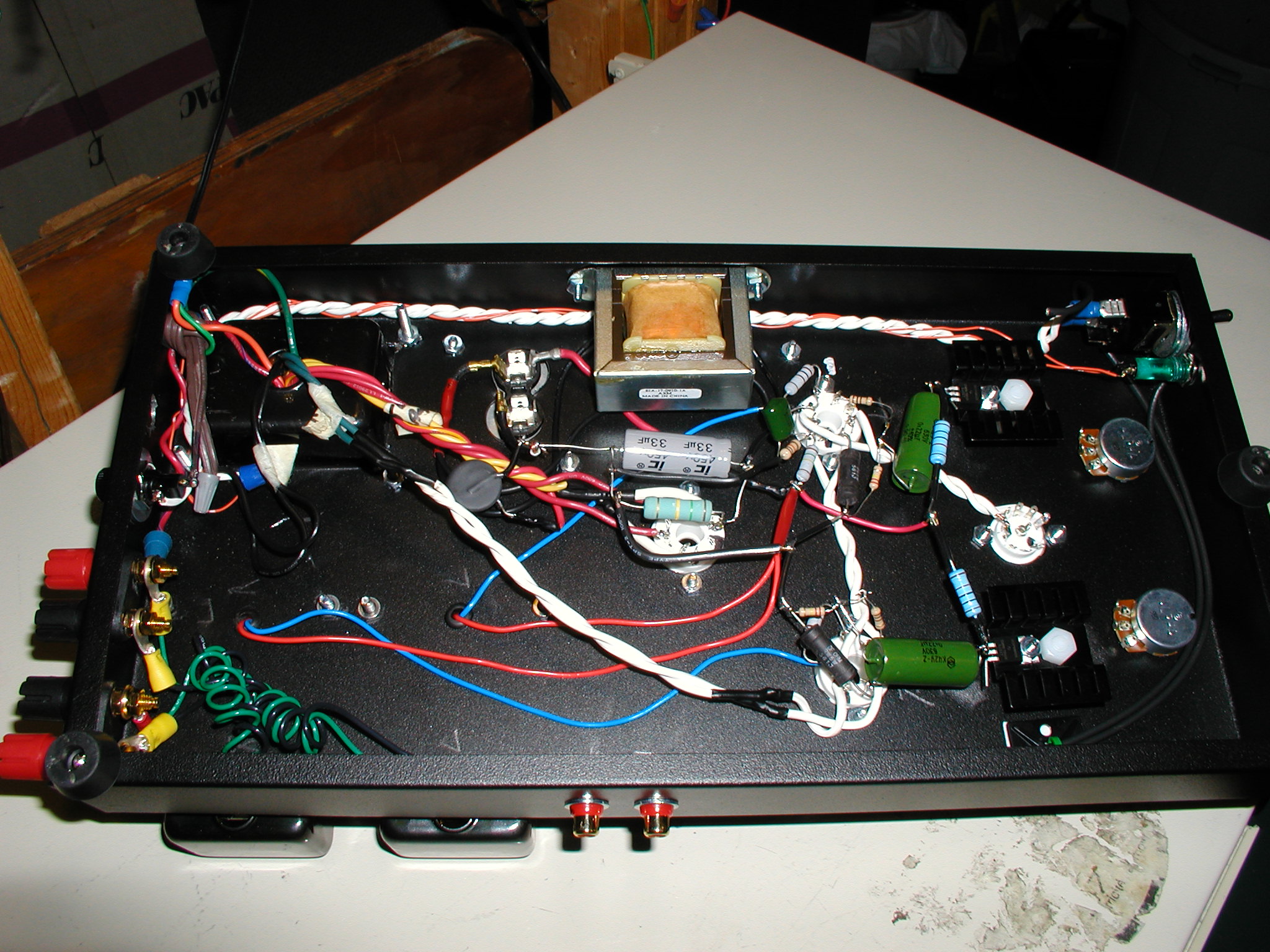

1. Did you do point to point connection instead of board?
2. Shouldn't PT and OPT be rotated 90d from each other?
3. Those 2 knobs in front, are they volume pots?
In my experience transformer orientation only matters sometimes oddly enough. sometimes what seems like transformer orientation is really a problem with your cabling picking up some nasty noise, so twist it together in the amp.
I believe the 2 knobs are volume and source select being that there are 3 sets of RCAs on the back.

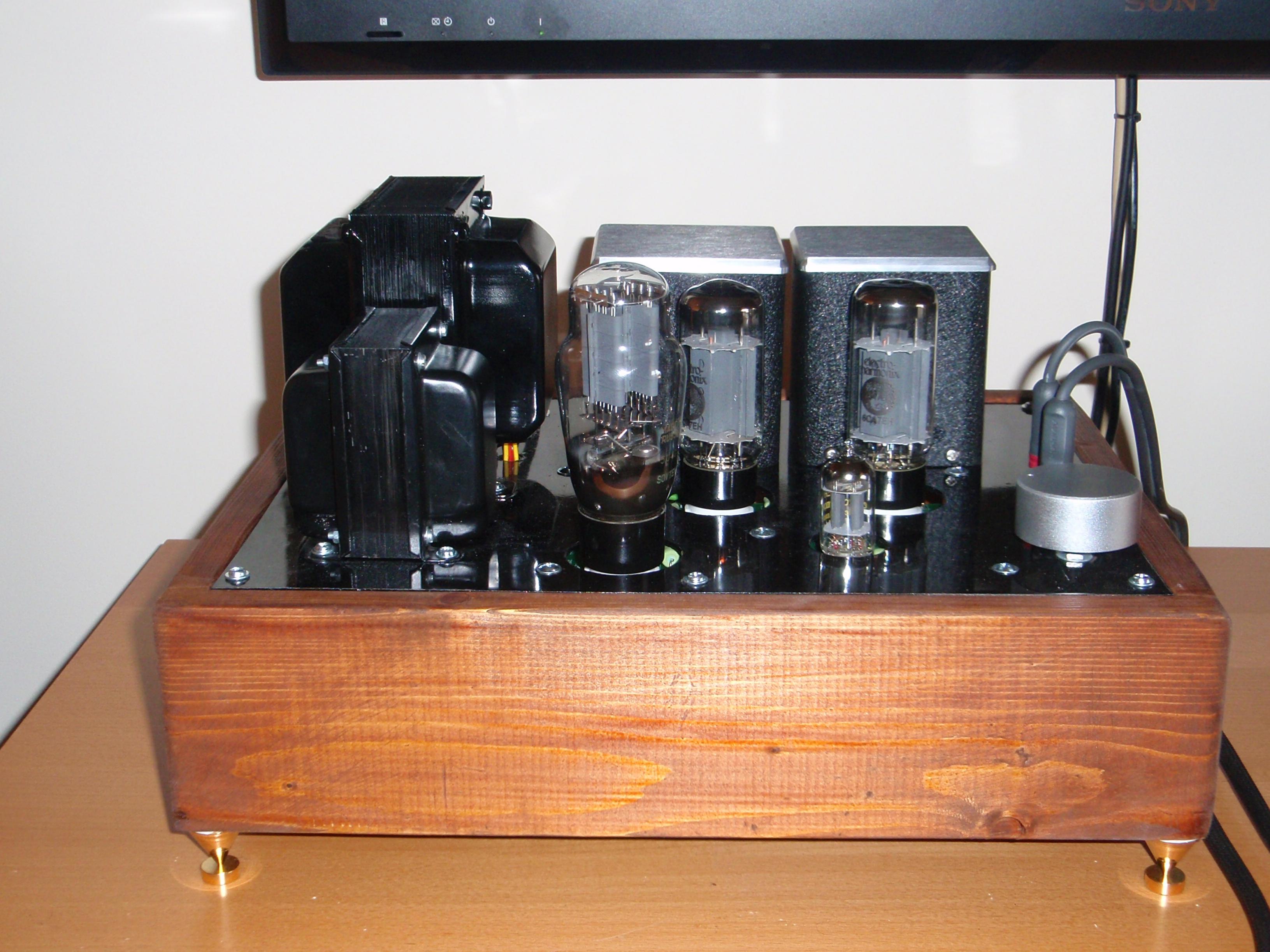

This is my Tubelab SE. It has separate PSU and it does not have a final enclosure. I plan to play with it a bit more. The audio part is very stable.
It sound very good, I like it much more than the KT88 based amps.
