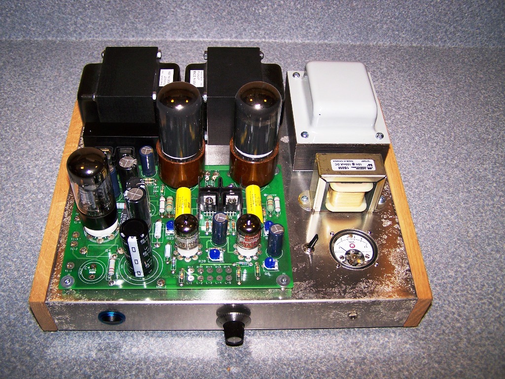

My Tubelab SE.
I don't use this much - it resides at our secondary (lake) house, and I don't get to spend much time there 🙁. It was built on a 10x12 Hammond chassis. The clear paint had some kind of reaction with something on the chassis in places. I am not much of a metal or wood worker and have no real desire to get better at it.
The meter is a 0-1ma device scaled to read 0-100ma and can be switched to read plate current at the right tube, left tube, or off. It is pictured with 5930 (2A3W) tubes, but I usually run 45 or 46 in it (46 and 47 are not drop in - they require an adapter). A lot of the parts are hamfest scrounges. The OPT's are 5K Transcendars.
The little phone jack on the front is parelled with the RCA's on the rear to conveniently plug in ipod and mp3 devices. The on/off switch lights blue when the amp is energized (my wife likes that!)
I have some vague plans to drop a Simple SE board into this chassis optimized for just the little tubes, and build the Tubelab SE onto a larger chassis with a cage. Since this picture was taken, I did install a small fan on the regulator heatsink.

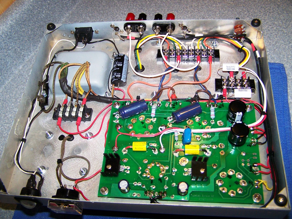

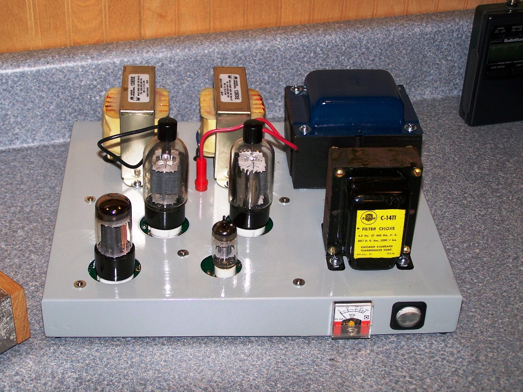

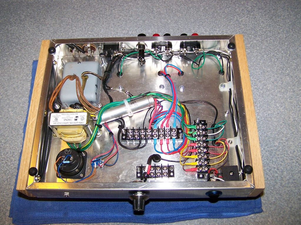

My Simple SE.
This is the workhorse at our primary home and the board has at least 10K hours on it at this point - it is on whenever someone is home as the home audio/video plays through it. It's seen a few trips through the dishwasher and its share of kerblamo'd components.
The chassis is an LMB 11x13x1.5 piece that started life as a homebrew 75 meter SSB/CW transceiver I built about fifteen years ago. All the holes, slots, cutouts, etc., were epoxy filled and sanded flush and then the chassis was painted a light Collins grey. A lot of the parts are hamfest scrounges or recycled from other projects. I recycle my parts whenever possible.
The meter reads total current from the power supply. The volume control on the rear was an afterthought. This is setup for tinkering - I can change the B+ taps, plate load, degree of cathode feedback, and cathode resistors with a screwdriver. The anode connectors are just ordinary banana jacks and plugs to make for easy disconnect. The on/off switch is red when the amp is off but connected to power, and green when energized.
I have used ( with suitable adapters ) tubes from 6AQ5 up to 6889 in this amp. The picture shows 6DQ6B.
I tend to wire amps like I am wiring a radio, which may not be optimal, but is just the way I do it.
I really like this amp. I have a couple more Simple SE boards and plan on building some amps that are better optimized with better components at some point in the future.

Yes w5jag, I'm still trying to figure this replay thing out, new at this. I tried out some WSE15's that I had kicking around and was quite impressed with the way the picked up the bass. The WSE15's are Hammond clones rated at 15w. They look the same as yours. The big Edcors do sound better to my ears but these WSE15's are very nice sounding and about 1/2 the price.
