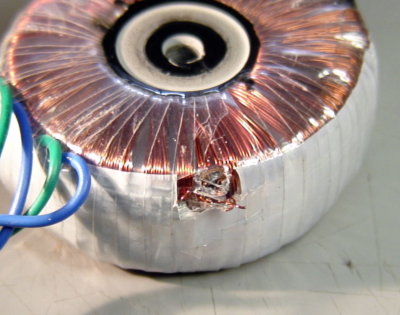

I probably know the answer, but is there any way to salvage a toroid?
You know the story - " I should remove that toroid in case the drill grabs and........ :cuss:". The outer three layers are cut or distorted.
Not expensive to replace but I thought I'd ask the question anyway. Isn't quite the picture I had planned to post this weekend.:violin:

Drill out the core filling.
tape up the insulation both sides of the damage.
cut and remove the insulation to reveal the windings.
cut and count the turns that you remove. Try to just remove the outer layer/s.
If a deeper layer is damged then remove that as well.
You will have to be sure which windings you have exposed by measuring back to the original lead outs. Sometimes the manufacturer uses slightly different colours of enamel on the bi-fillar windings.
Now wind back on the required "patch" turns to repair each layer in turn.
Insulate the soldered joints very thoroughly.
