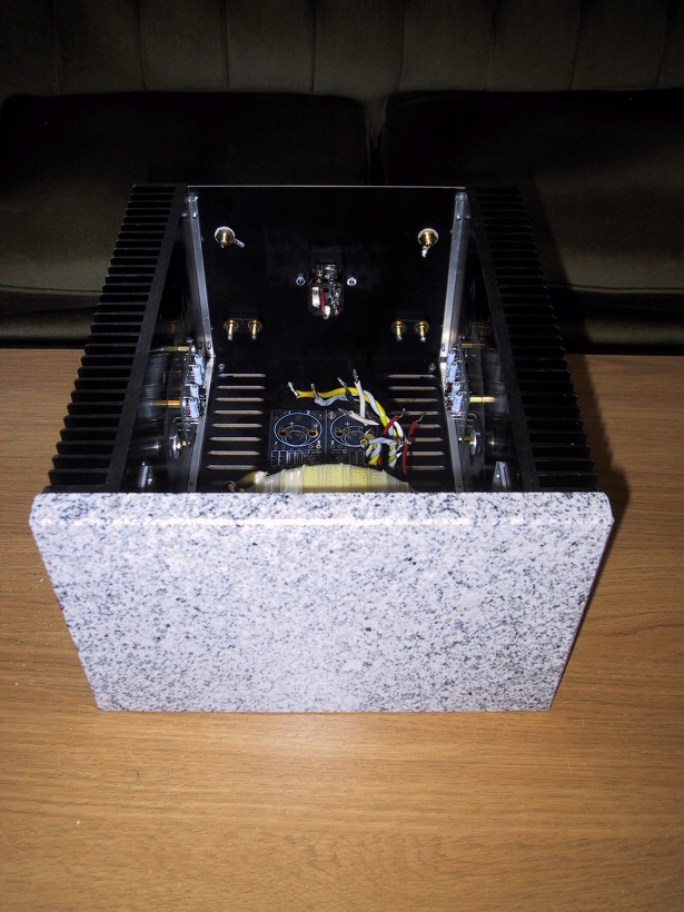

It's fischer elektronik SK41
They were like 15-20Euro a peace, rated at 0.28K/W for 150mm...by they spreadsheet..but it turns out to be more like 0.5 😉...but still it was good buy
I buy them localy,in Croatia

Nice, Yoke! How did you finish the metal case?
I don't know is this the right word on english - eloksation / anodization ?
Heatsinks in black the rest of case in some sort of gray 🙂

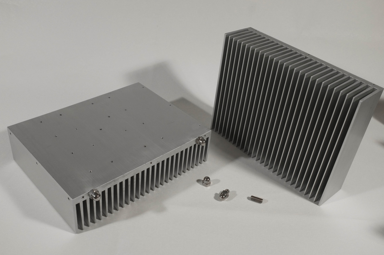

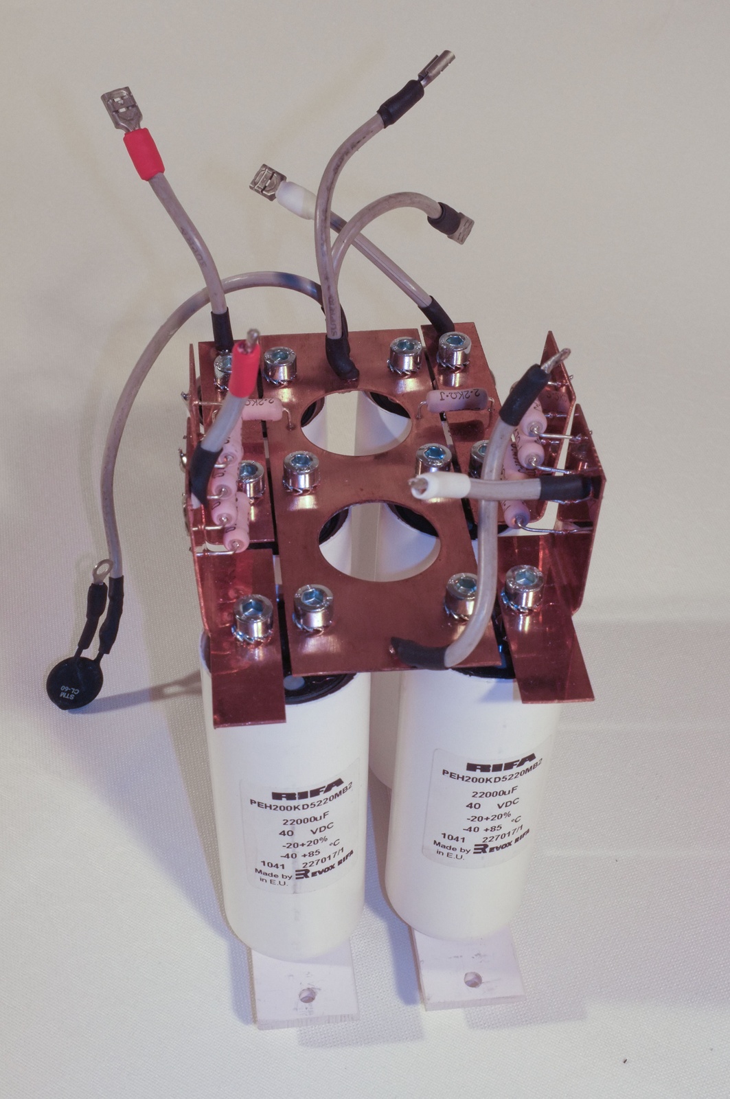

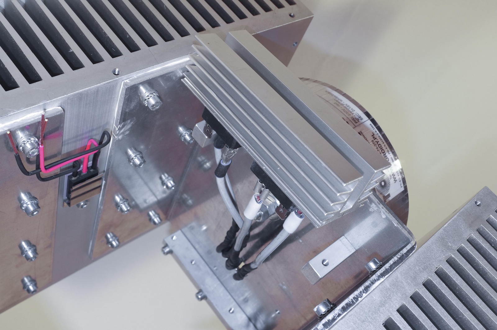

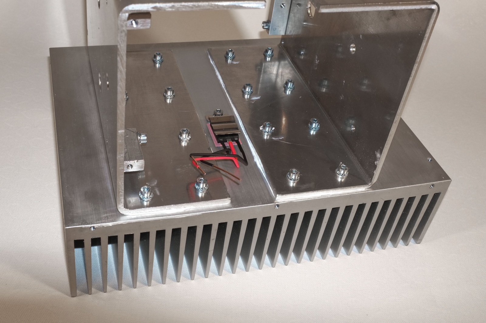

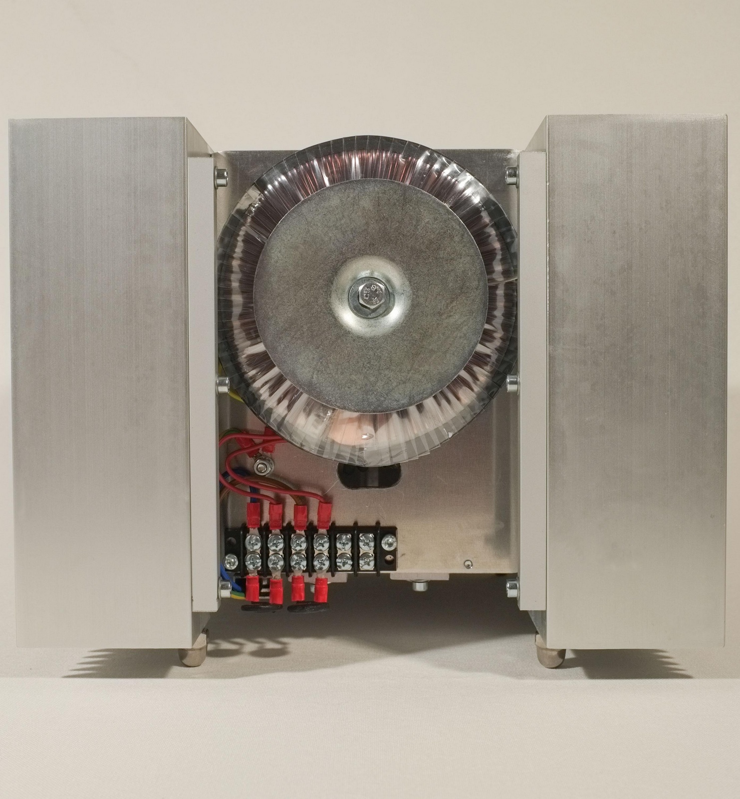

My F5 monos

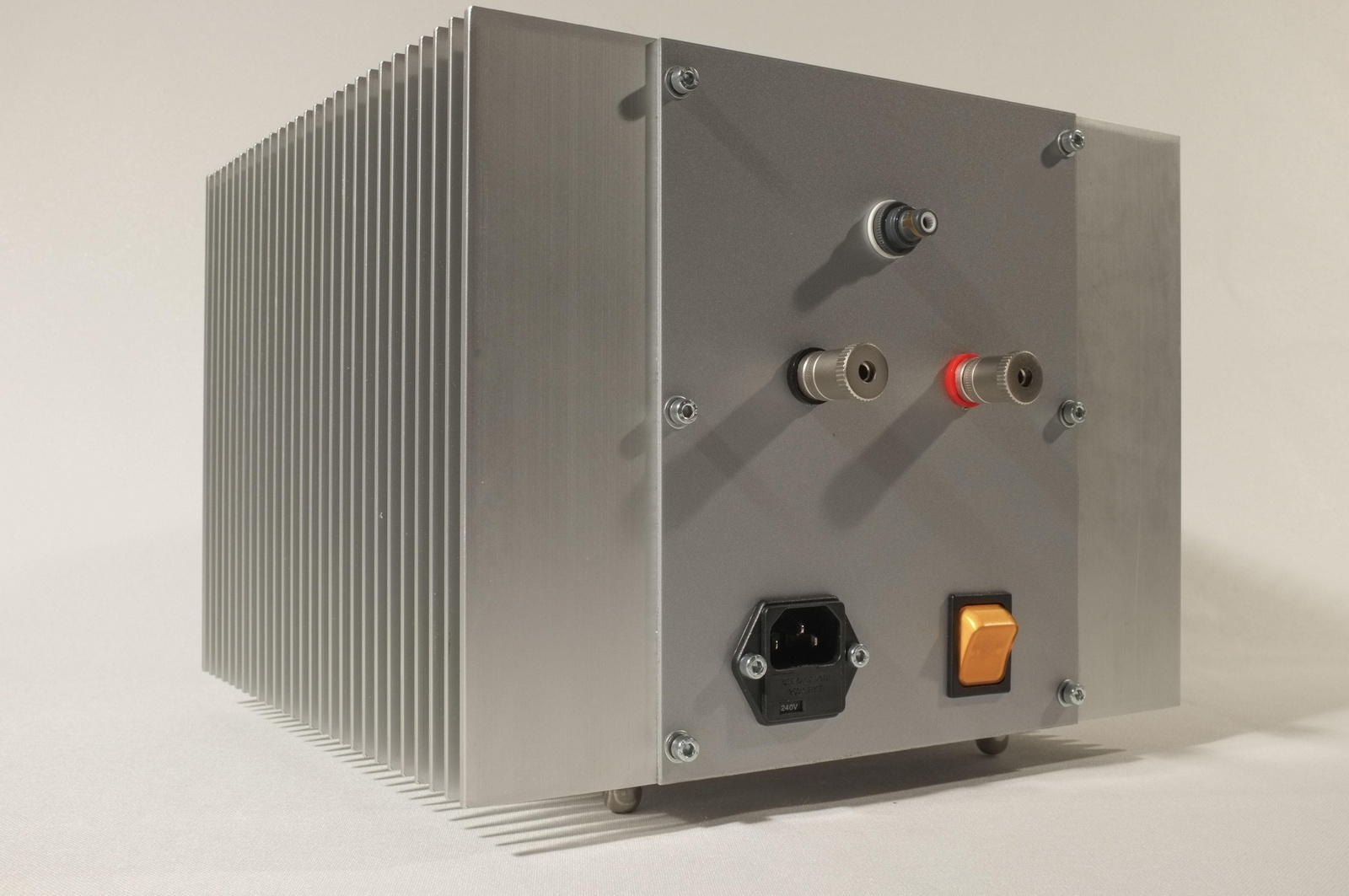

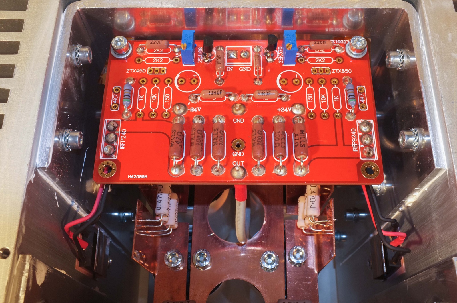

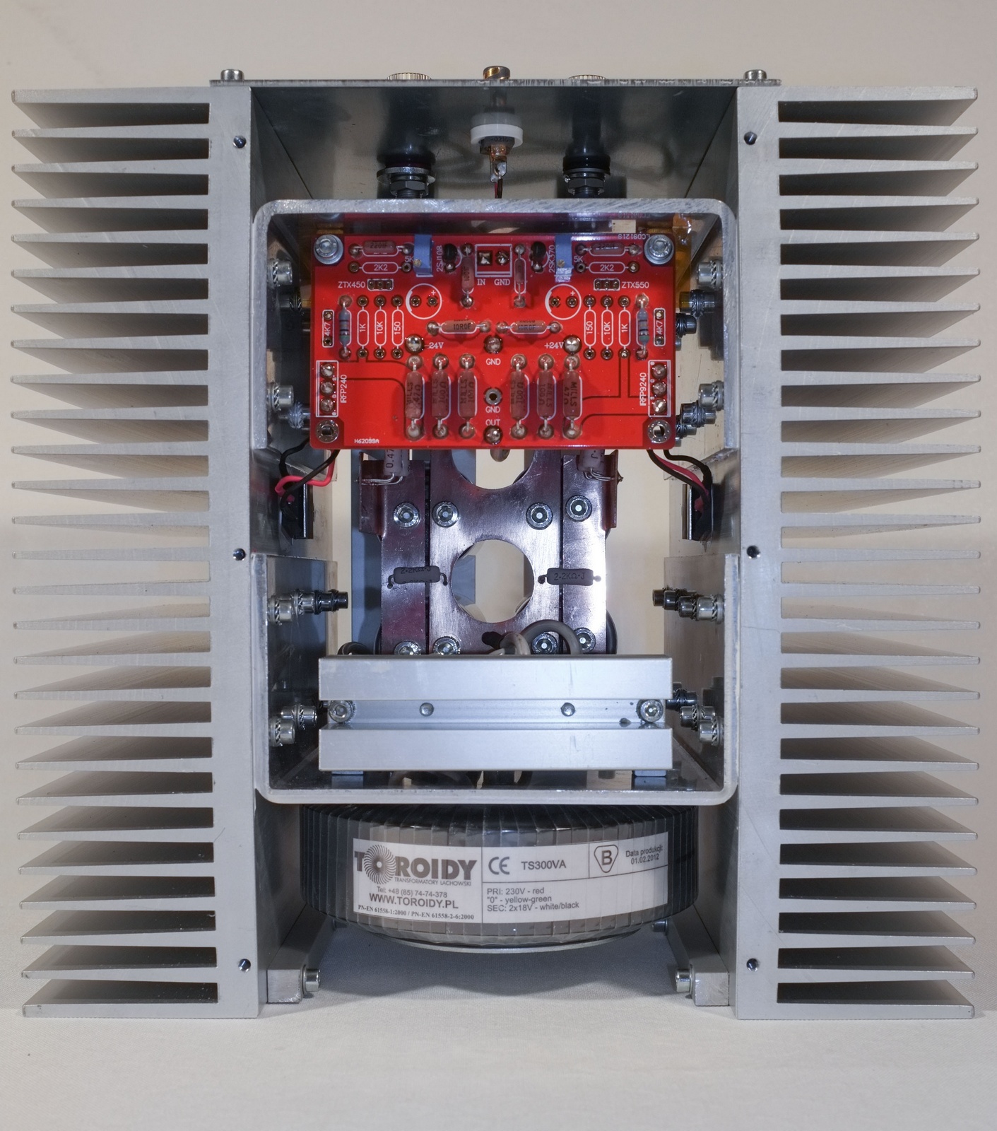

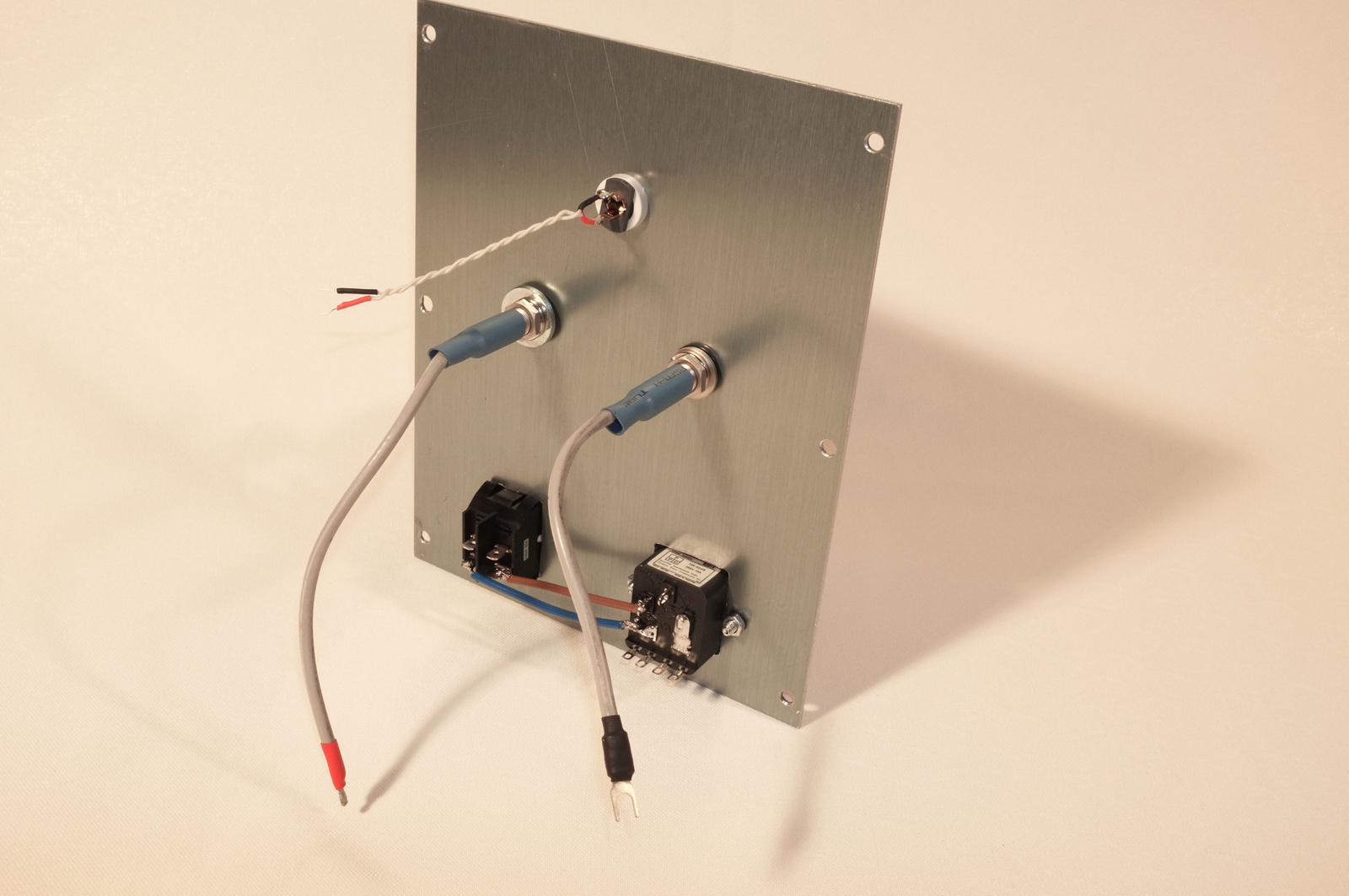

Hello,
here you go the pictures of my F5 monoblocks.

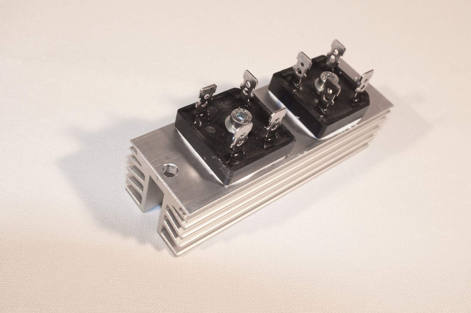

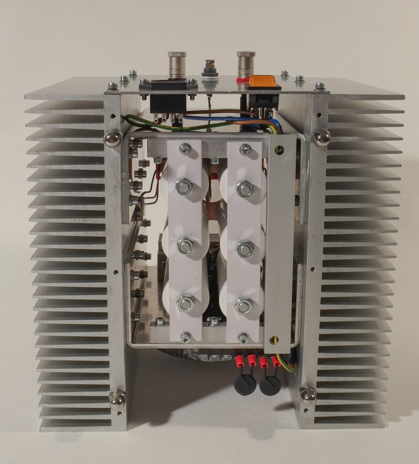

Heatsinks by Gorini Dissipatori. Model 7078/200, and 5306/100 for the diode bridges.
Copper and alu parts from a local locksmith, very unexpensive.
Trafos by Toroidy.pl. 300VA audio grade.

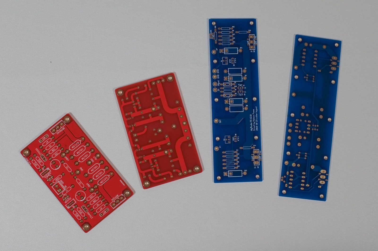

Had to use an unofficial PCB because of the form factor.
Mosfets matched by Hannes (h_a on this forum). Thanks Hannes ! 🙂

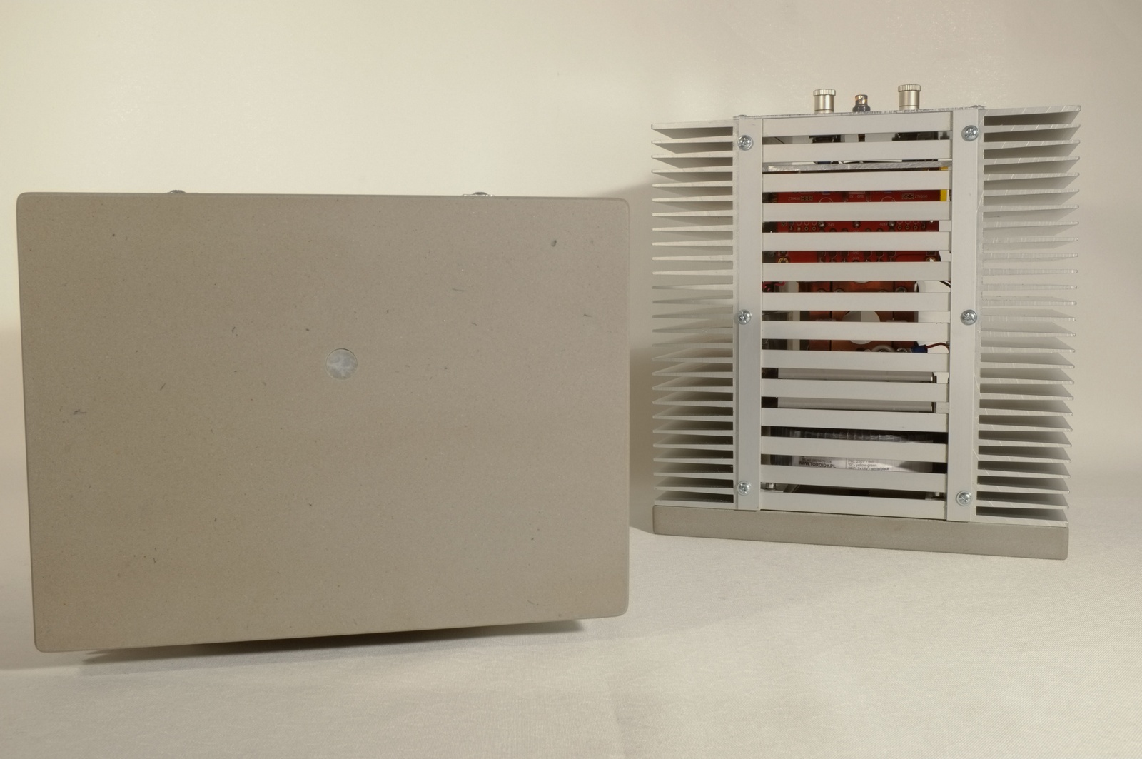

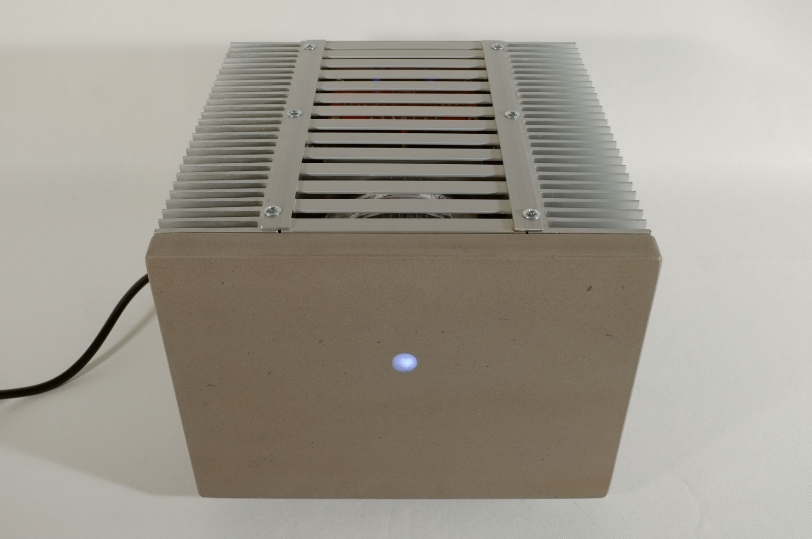

Front panel is a stone slab with a onyx eye, backlighted by a led.
Mills and Holco resistors from hificollective, other stuff from Mouser.
With two CL60 thermistors in series with the trafo's primary, I don't get any bump at power on.
The signal path is very short. The amplifiers run dead quiet, with no hum or buzz. Temperature of the heatsinks is about 42C with a 0,590V bias.
A perfect match for my pair of Troels Gravesen's DTQWTs .
Many thanks to diyaudio for all the info, and to mr. Pass, the one and only.
Cheers. Carlo

6L6, the only "fancy" tool was my small bandsaw, equipped with a blade for cutting metals.
Plus a cheap drill press and the usual manual tools.
All the tapping made by hand.
This way, I didn't buy any chassis. The stone panels are way cheaper than a thick aluminum equivalent. The monoblocks weigh about 17 kilos each.
