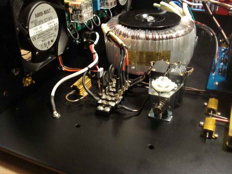

Thanks Mixon1, evanc - and Thanks EUVL for pointing the temp of the 'gnd plate' - I have checked it this morning, run the amp with lid closed and after 2hrs checked the temp of the ' power resistor' and gnd plate - and yes, its quite warm; close to the temp of the heat sink!! - I'm sure it's not the ambient temp. inside the chassis that's causing it to get warm; very bad for those caps. Because of the limited space I decided to put it there thinking the power resistor ( 50w printed on the body ) would handle the heat pretty easy, and the gnd plate would not be affected by heat coming from the resistors. The resistor in parallel ( 0.5 ohms 100w ) has a voltage drop of 1v and would pass, say 1.5 amps. P=IV - 1.5 W ?? Am I missing something ? I might isolate the power resistors from the gnd plate - will post pix once completed. - By the way the Amp sound really good!! one word to describe it is " SPECIAL "

I don't think you're missing anything in your power calculation of the resistors. "Quite warm" is not "hot," so you should be OK as far as the caps go (unless you're drawing power much beyond the 1.3A class A 'limit'). And it appears you have good ventilation in the top cover. But perhaps more or larger vent holes in the bottom might be a future option if you're still concerned?
I might consider putting a fan; if I find a space in the chassis or drilling a ventilation holes on the chassis just above the capacitor banks, what puzzles me is the whole power resistors 4 in total , 1 ohm 50w each , 2 pcs. in parallel for each +- supply rail. drawing 1.5 watts each approx, 6w total for the 4 resistors can generate so much heat. or I may be wrong and the heat is probably coming from the convection effect inside the chassis. I can touch the resistor for 5-10 sec after 2 hour of operation. I am concern that the capacitor connected to the gnd plate would cook. This is really a "HOT amplifier"

Let me perhaps explain why I spotted your problem straight away.
And what Andrew said is true is any case.
The power dissipated by the MOSFETs are taken care of by the large heatsinks. That's fine.
For the CRC, you calculated 1.5W per resistor, or 6W in total. That is also quite OK.
Had you used normal metal film power resistors, or ceramic resistors as I suggested, you would have had NO problems.
These are not thermally coupled to anything, and they give off their heat to the ambient.
The problem is that you used metal cased power resistors which are normally thermally coupled to heatsinks.
By mounting them onto a metal plate, you now coupled them thermally to that plate, and thus the plate becomes the heatsink.
Which it can for 6W, but it will still get quite warm.
Still OK if you do not use that at the same time as your Gnd bus bar and connect it to the capacitors.
I presume you don't want your caps too warm.
So the easiest thing you can do is to thermally decouple those resistors from the Gnd bus bar.
And the easiest way to do so is , as I suggested, use free-standing 5~10W ceramic resistors.

Thanks for all the inputs, much appreciated. I kind of like the look and feel of these power resistors it matches the " heavy duty" feel of the whole amplifier. What i'll do is thermally decouple the resistors from the gnd plate - but before that i want to listen to the F5 some more - to lazy to go back to the bench.

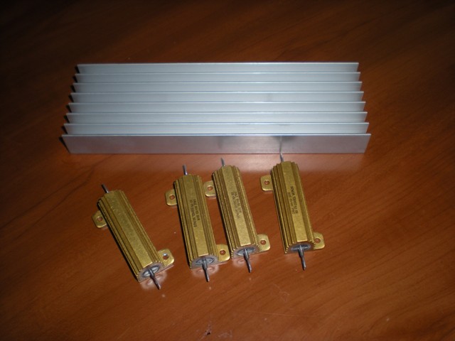

Yep. Those "metal jacket" power resistors are intended for heat sink mounting, and should be significantly derated if not used that way. In my F5, I added another RC stage to the RCR PSU, and used power resistors (photo). What's obvious, is that I have both the bridge rectifiers and power resistors firmly mounted to the 3/16" chassis base plate. What's less ovbious is that I had masked off pads for the rectifiers and power resistors on the base plate, prior to powdwercoating and used thermal grease between the rectifiers and the resistors and the base plate when I mounted them. (And the entire internal chassis is actually a forced-air plenum that gets circulation from two low-speed, low-noise fans.)
Bottom line..... Don't go for the "industrial look", if you circumvent the proper engineering to make practical use of it.
Ceramic resistors are a better choice, unless you want to "go the distance" with the finned metal jackets.
CanAm Man, that's not how I remember it on several metal Dale's like this. The 50W (on mine) rating is in free air I believe, and at 50W they're hella hot, but I have added additional hs and gone way above 50W.
Andersonix....... Yeah..... You've got me wondering about that, and I think you're right. I know in my case, after my PSU calculations, I decided that using the chassis plate as a heatsink was a very good "safety margin" for my resistors. Let me dig out some Dale spec sheets and convince myself..... In any case, my resistors run a little warm, as is the chassis plate surrounding them......
