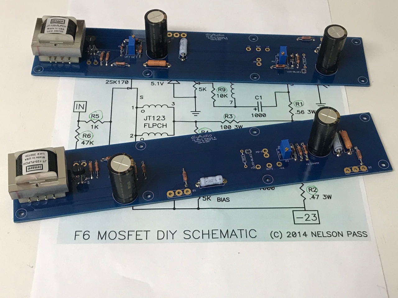

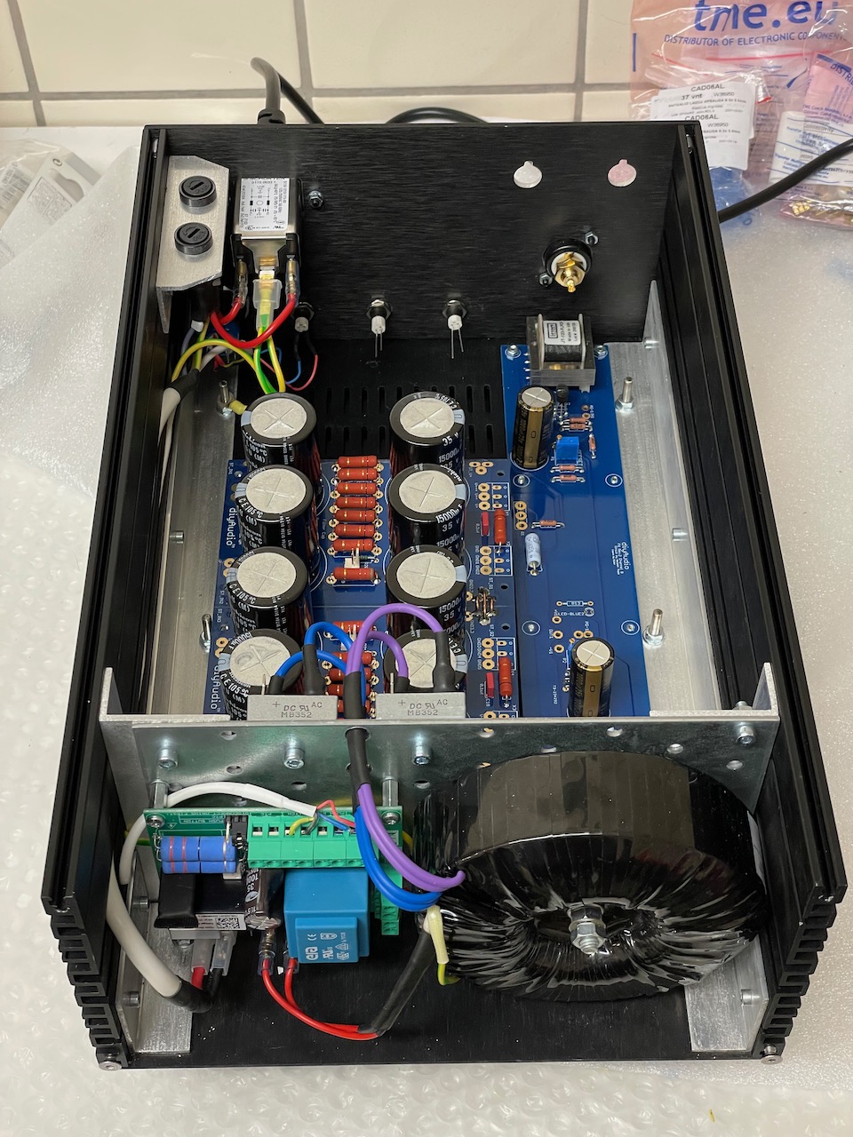

F6 Clone Monoblocks

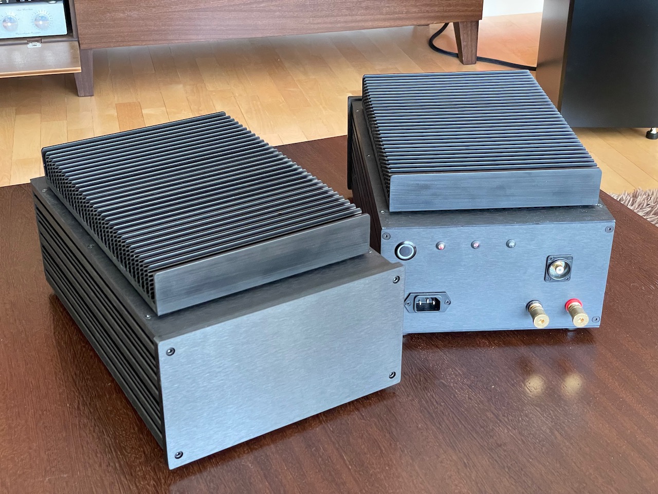

My recently completed F6 clone monoblocks.

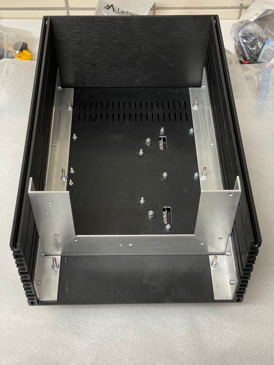

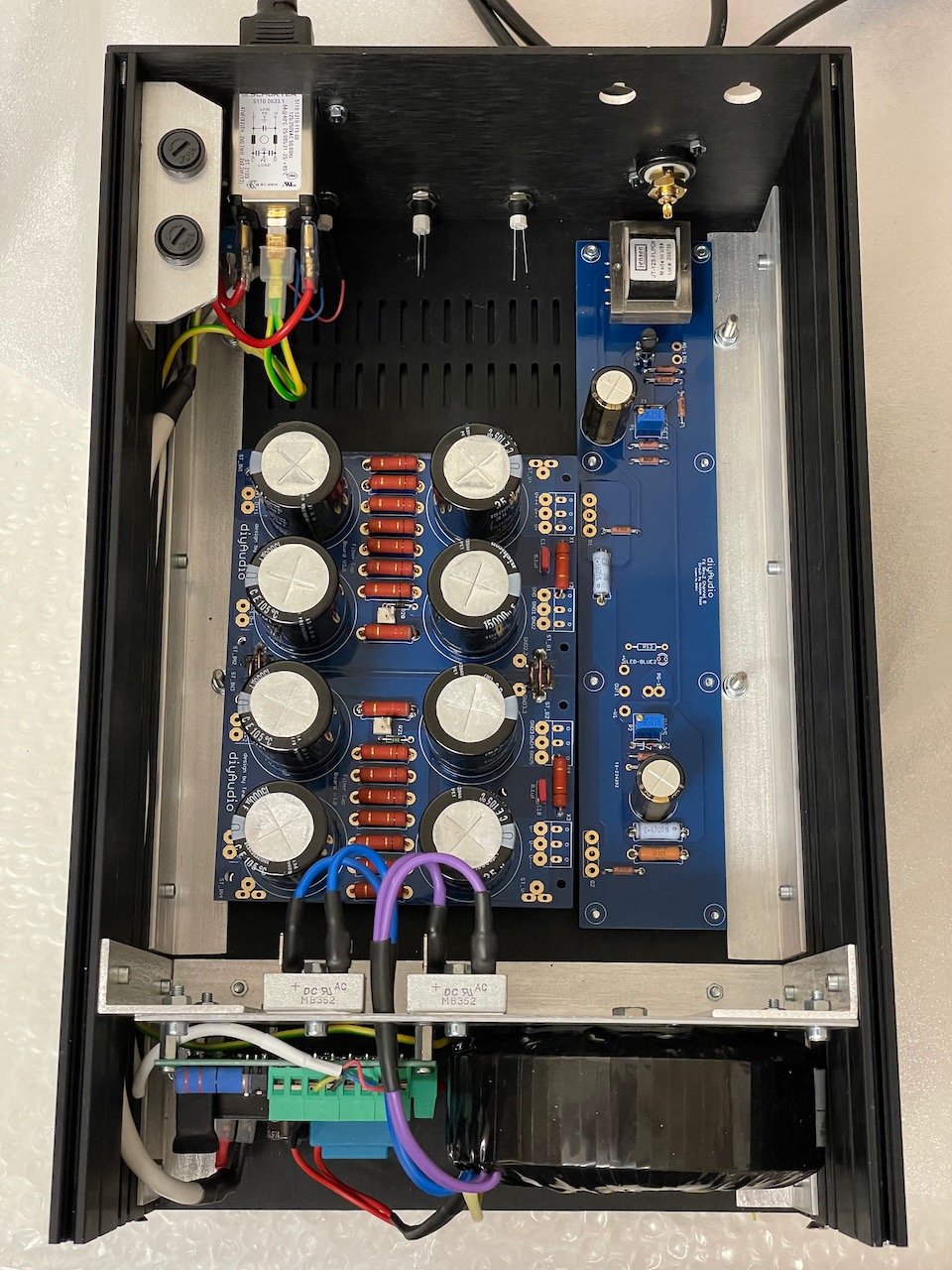

Heatsinks are fitted slightly elevated on top of cases (which is of course thermally suboptimal, but allows to use standard Galaxy cases and heatsinks from Modushop). Power transistors are sandwiched between heatsink and case. F6 and PSU PSBs are fitted upside down on the top panel of the case. The power transformer and soft-start is placed in front of the case in a separate compartment.

zman01,
+1 mgb1965.

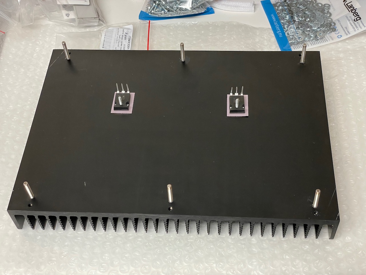

Are you using flying leads to connect the MOSFETs to the amplifier PCB?
No, I am not using extra wires to connect MOSFETs to PCB. Original transistor leads are just long enough to be soldered to PCB directly.
In 4th photo you can see assembled heatsink with MOSFETs already mounted to the case, but no PCBs yet. Transistors' leads are visible sticking through holes in the case. In the next photo amplifier PCB is already in place with transistor leads neatly in PCB holes (not yet soldered). Downside of this placement is that I will have to desolder MOSFETs if I ever need to take PCB out.
Note that all photos of build in progress show amplifier case turned upside down with heatsink below.
