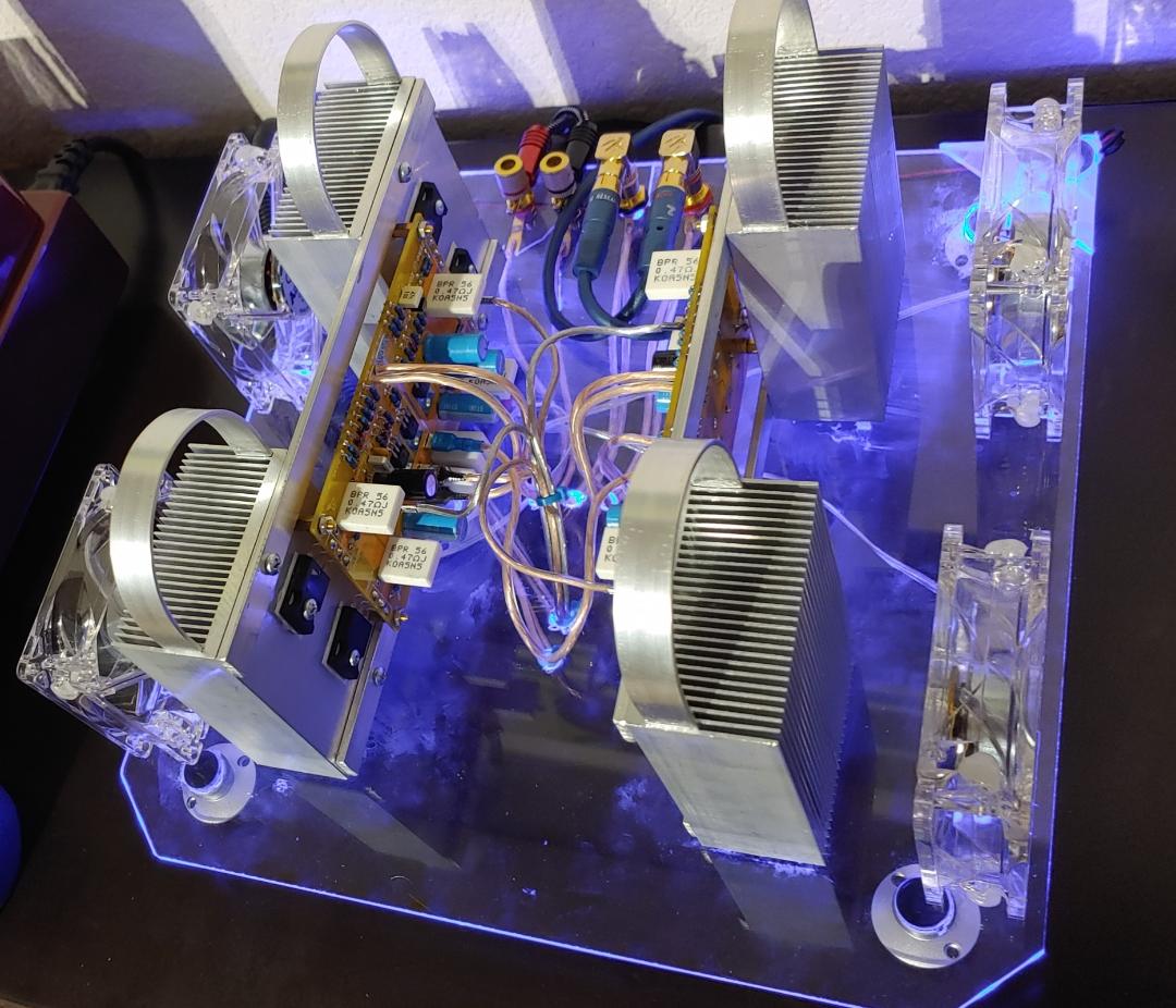

I agree with Zen, a surrounding case with shielding properties is not necessarily required (though proper grounding recommended) - My “exoskeleton” Aleph 3 build serves as one example...

that's damn Fugly!
:clown:
just one thing - when Big Donut is not surrounded with big Faraday Case, it'll maybe result in need of greater clearance to surrounding apparatuses ........ (sources,preamps)
but , that's manageable

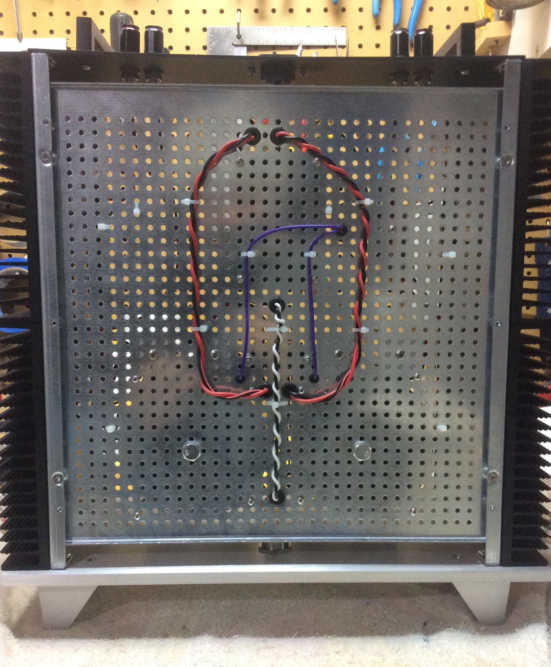

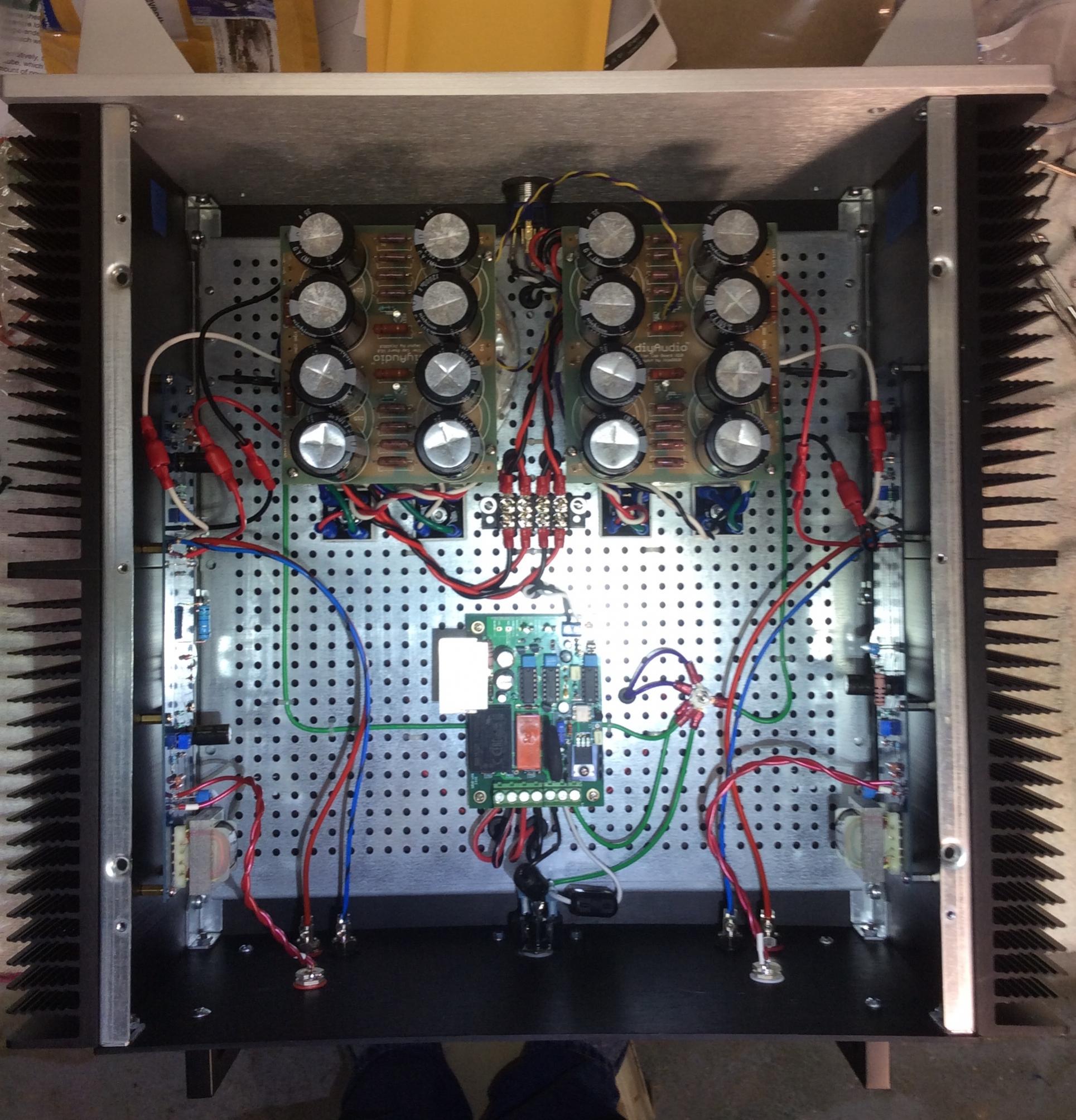

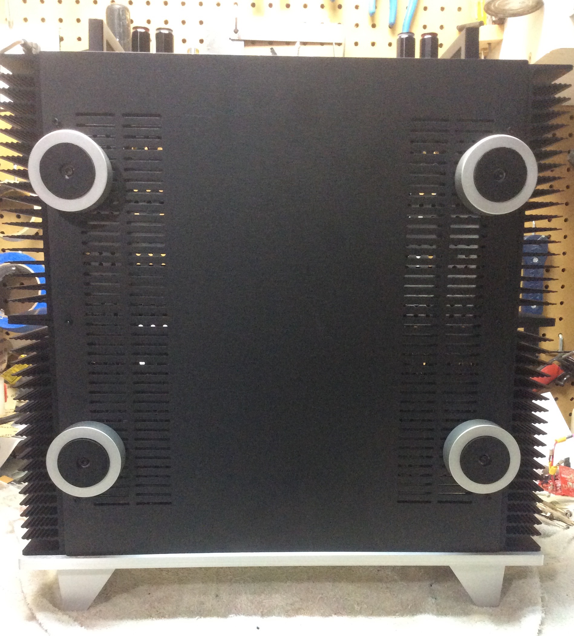

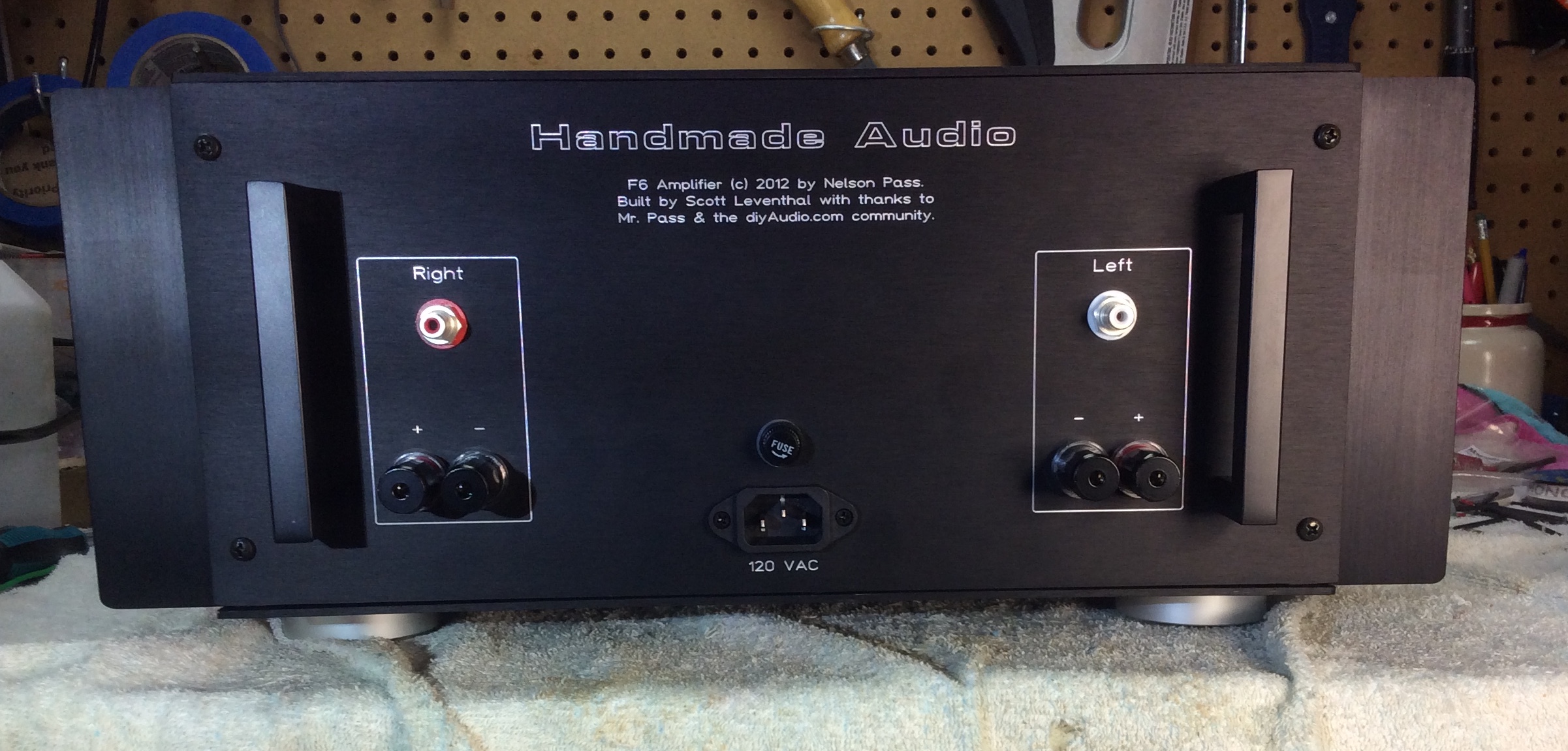

Folks:
This could have been completed in 2020, but I built plenty last year; better to start off the New Year with something fun.

Both 200VA toroids are fed by a single Mark Johnson H9KPXG soft start board. So yeah, only dual mono from the toroids forward.

to keep things safe, put one fuse per Donut, after soft start, holders in case
that way back plate should stay nice, and you'll have safety
