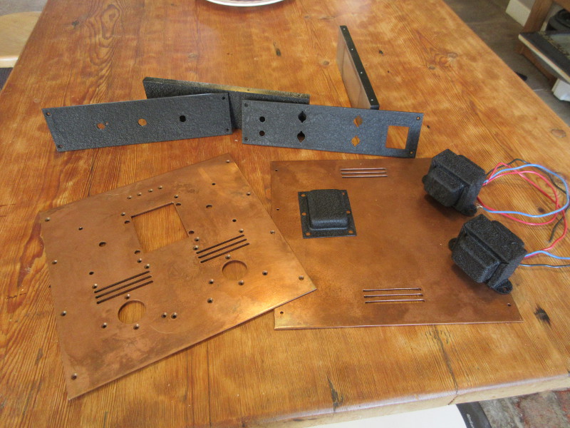

There are indeed a *lot* of hours in that casework.

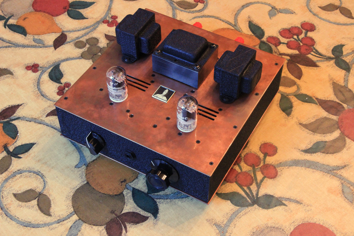

Pardon the non-Pass content, but here's another custom case I did for my Bottlehead S.E.X.:
attachment.php
attachment.php

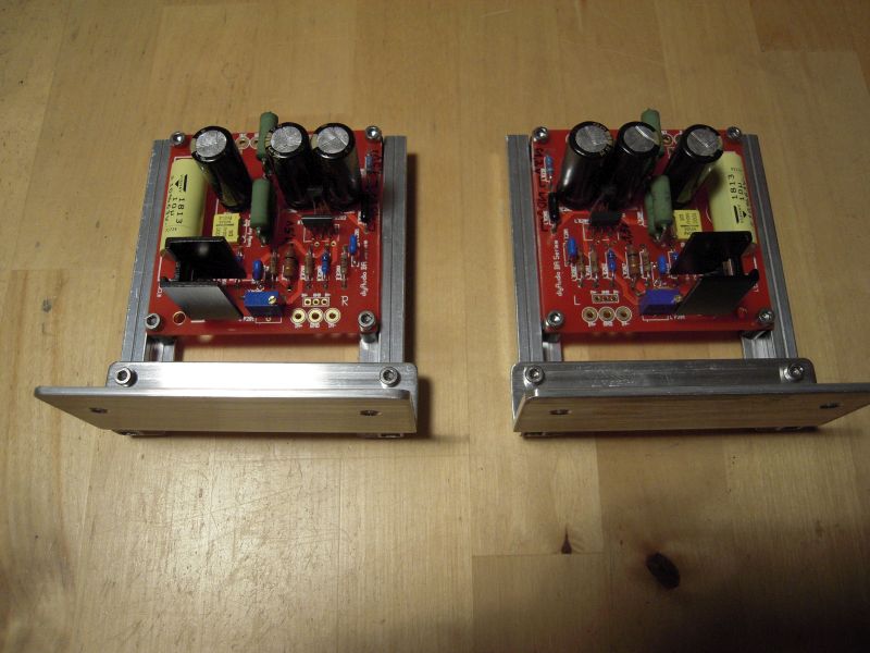

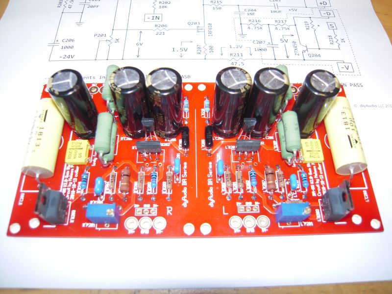

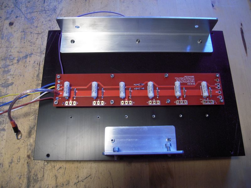

I found original (new old stock) TOSHIBA 2SJ109 and decided to build a BA-1 frontend.
Starting point of an amplifier build.....

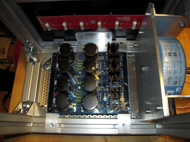

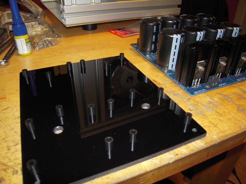

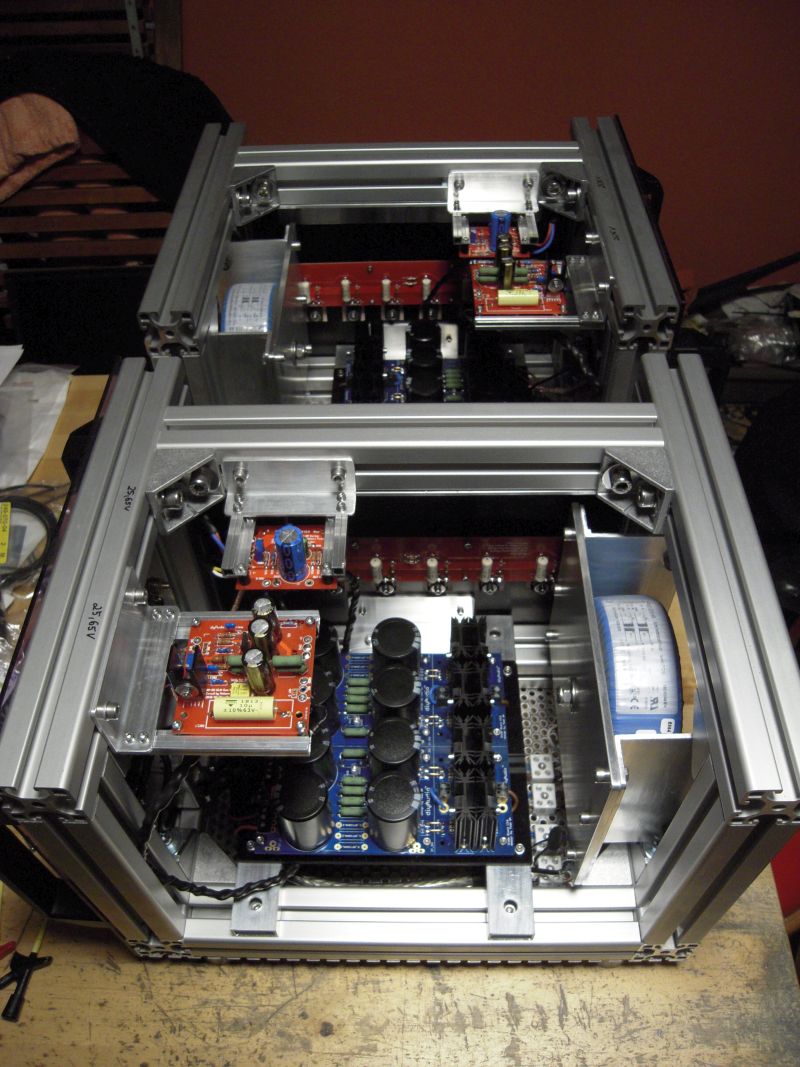

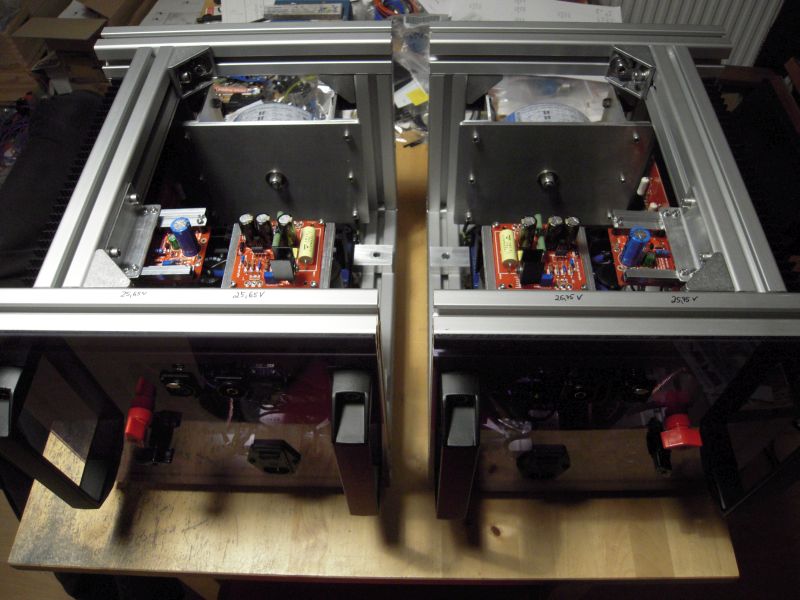

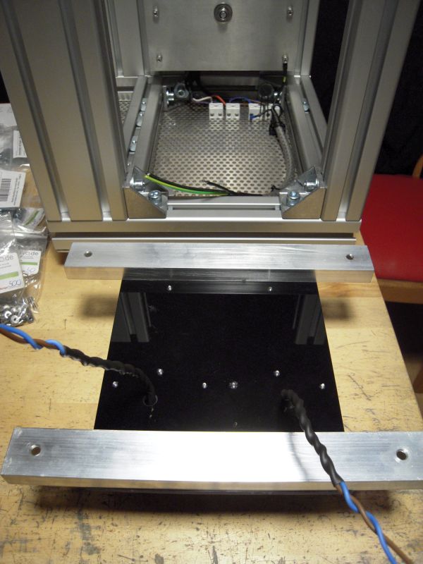

BA-1 Monoblocks

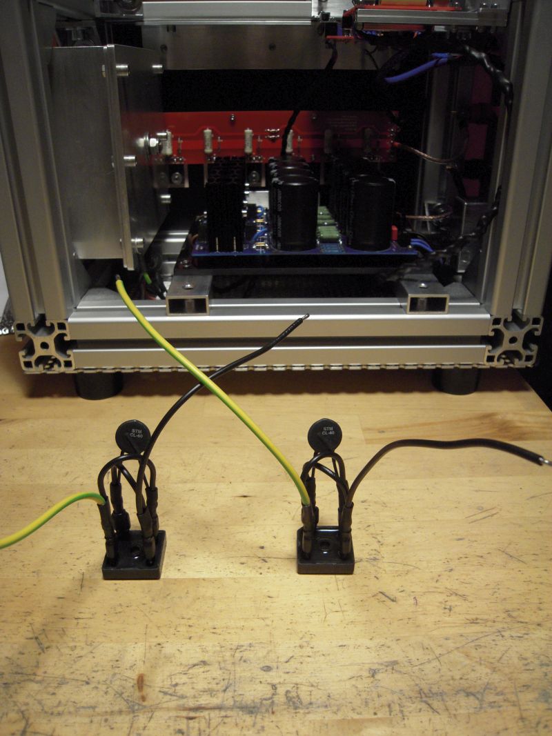

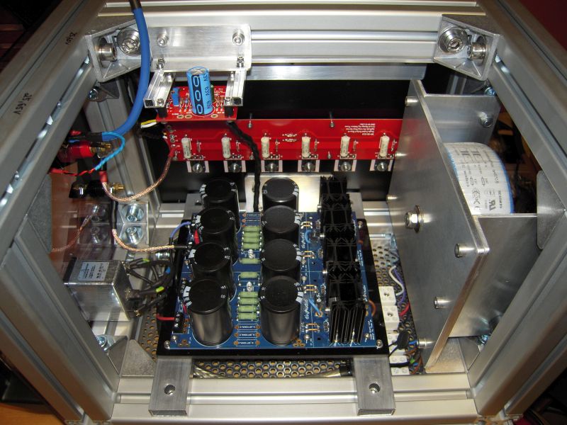

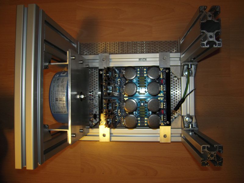

As with most of my amplifier builds - I started with an aluminum frame consruction and the PSU.

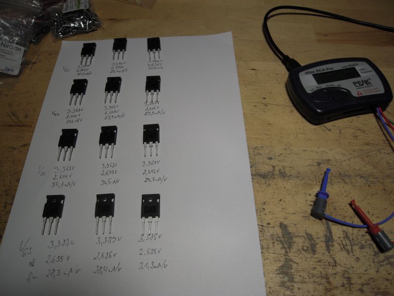

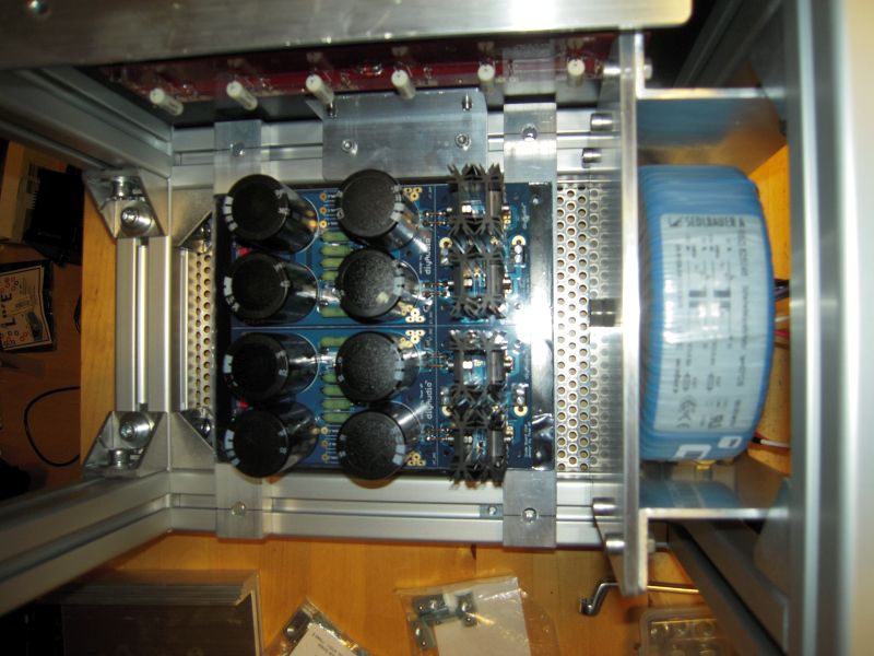

BA-1 Monoblocks
Prepairing the heatsinks - a lot of drilling and cutting lots of M3 threads.
Matching the MOSFETS.....

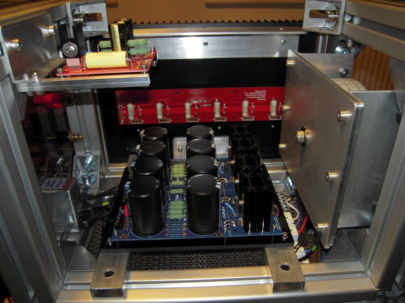

BA-1 Monoblocks

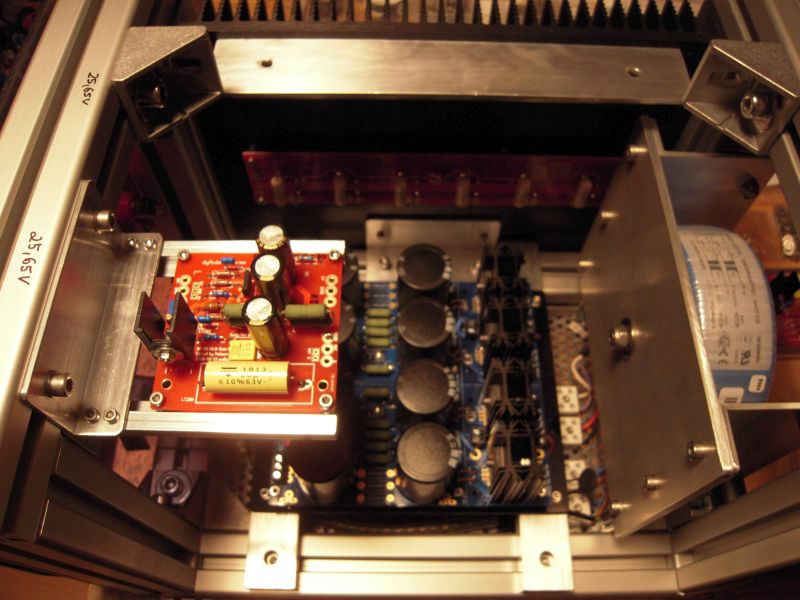

Then I mounted the frontend-pcb and bias-pcb.

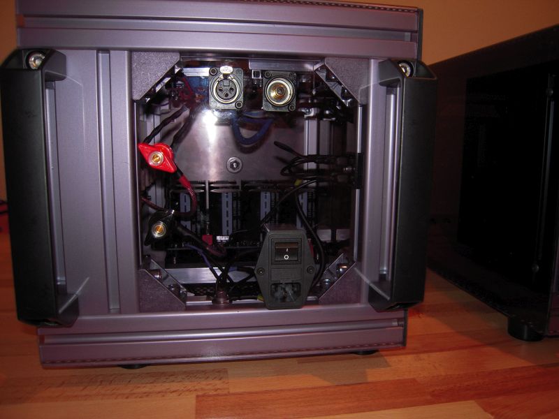

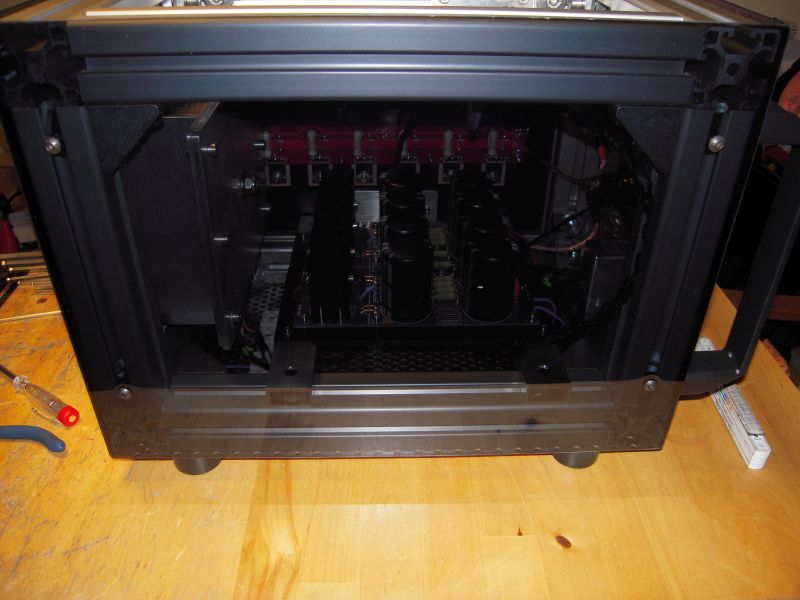

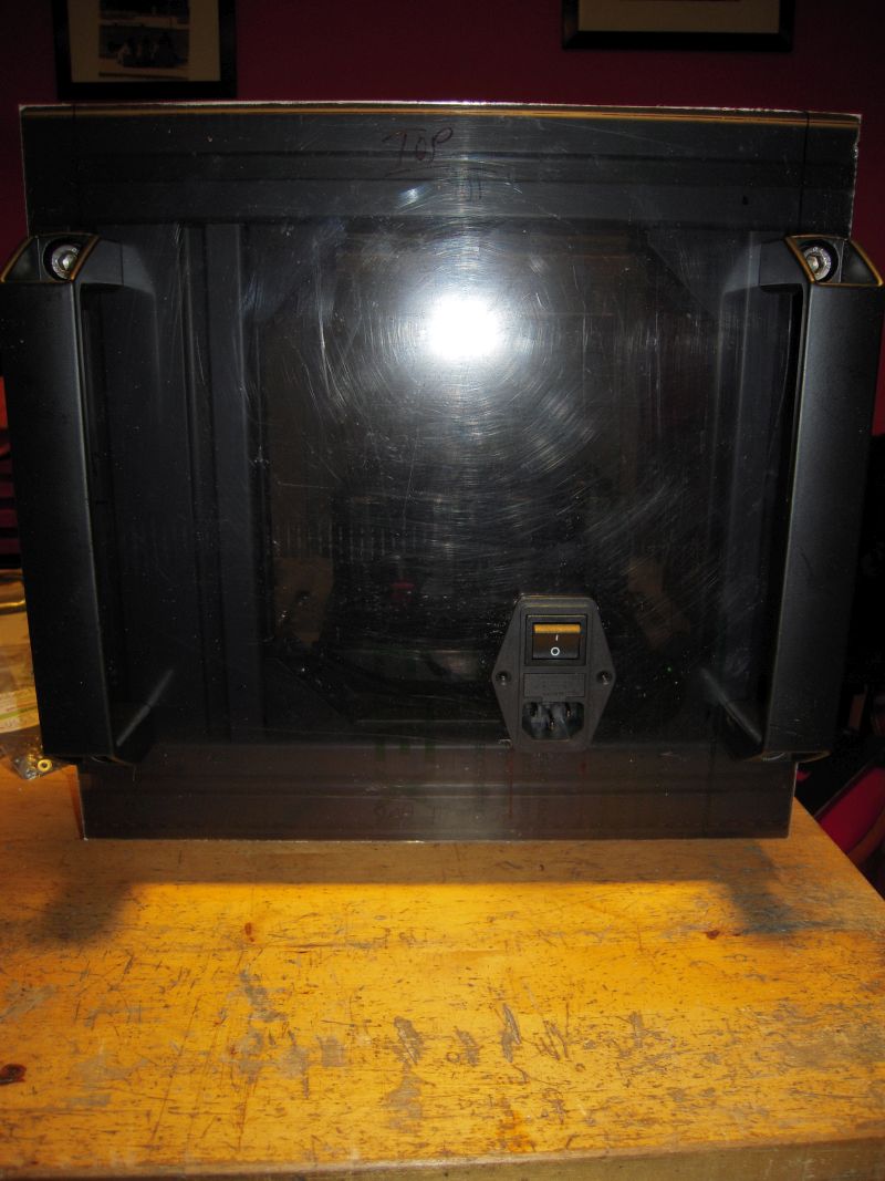

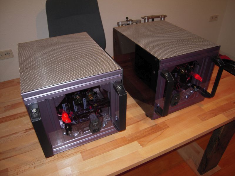

BA-1 Monoblocks
Added some plexiglas/acrylicglass in translucent dark grey.
Perhaps I will change some covers to aluminum?
Acrylglass doesn't shield...
I like the look. But this is a question of taste... :nod:

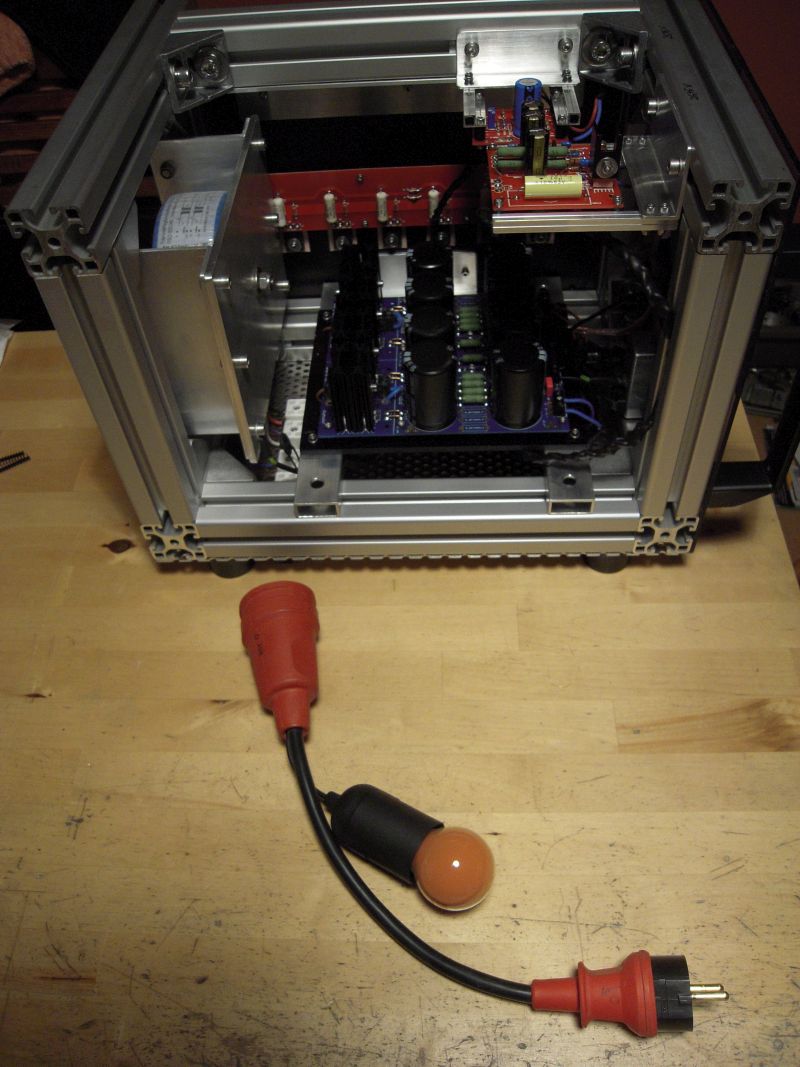

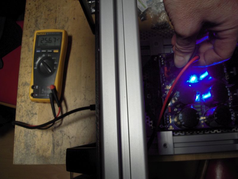

BA-1 Monoblocks

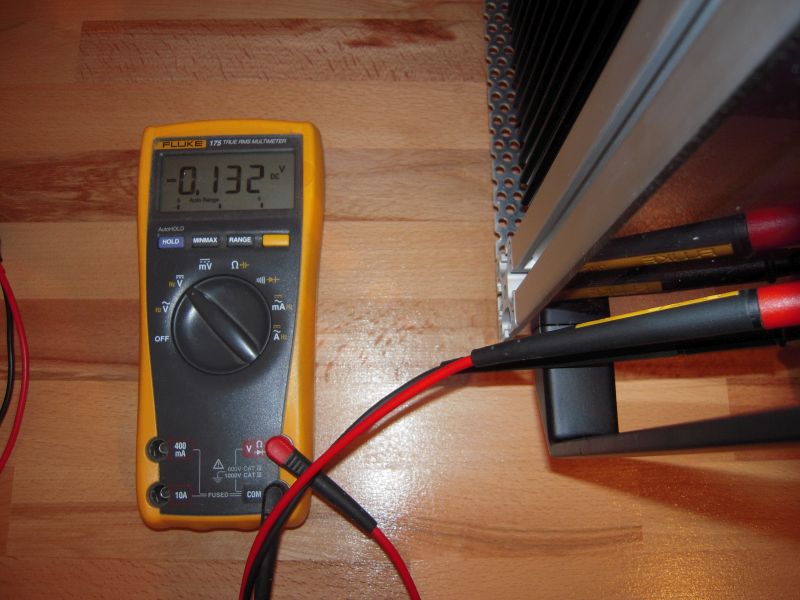

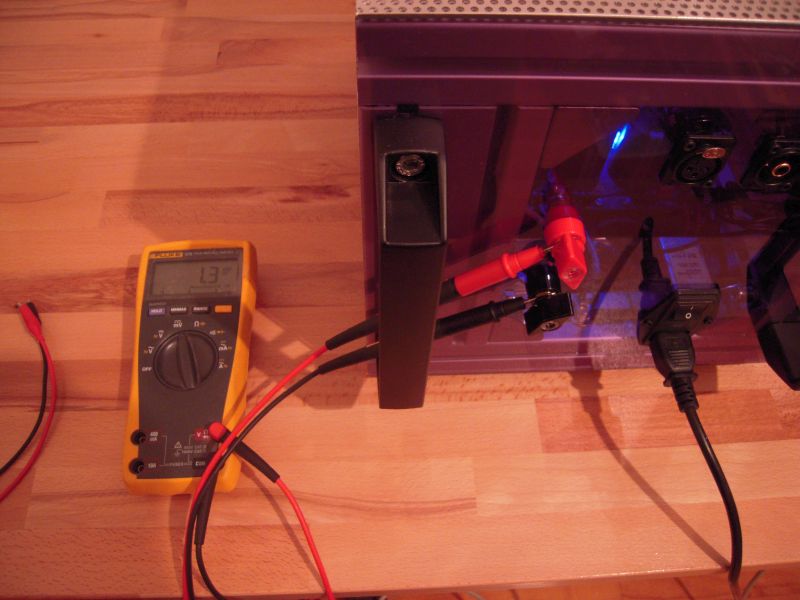

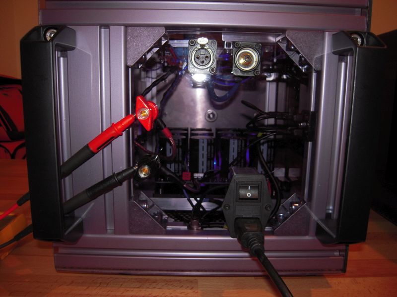

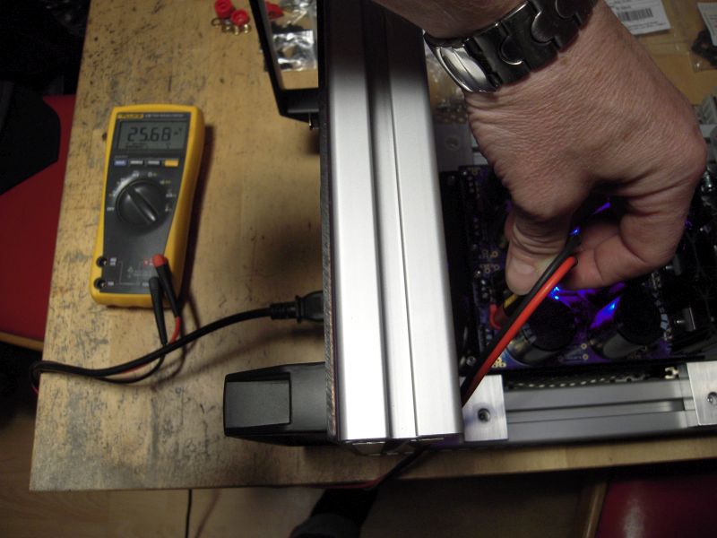

The first start up.
And the most important tool - the light bulb tester.
Some first measurements.

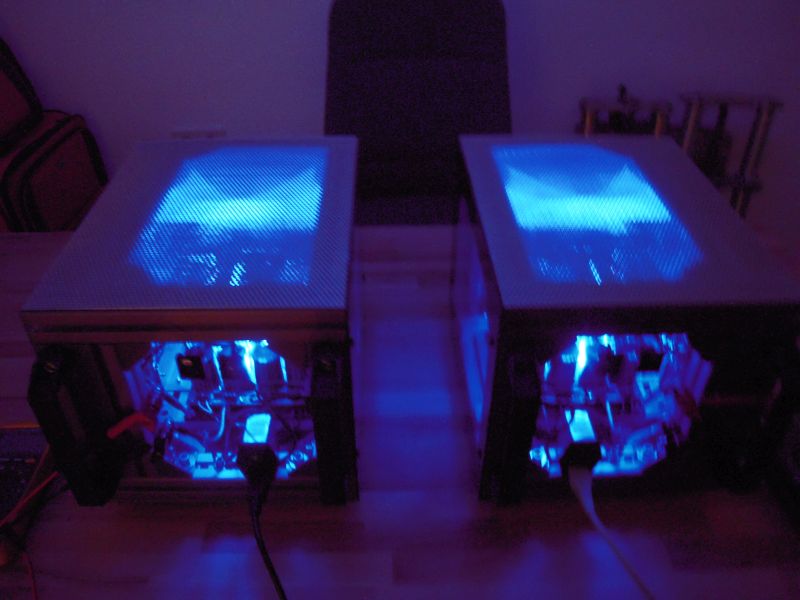

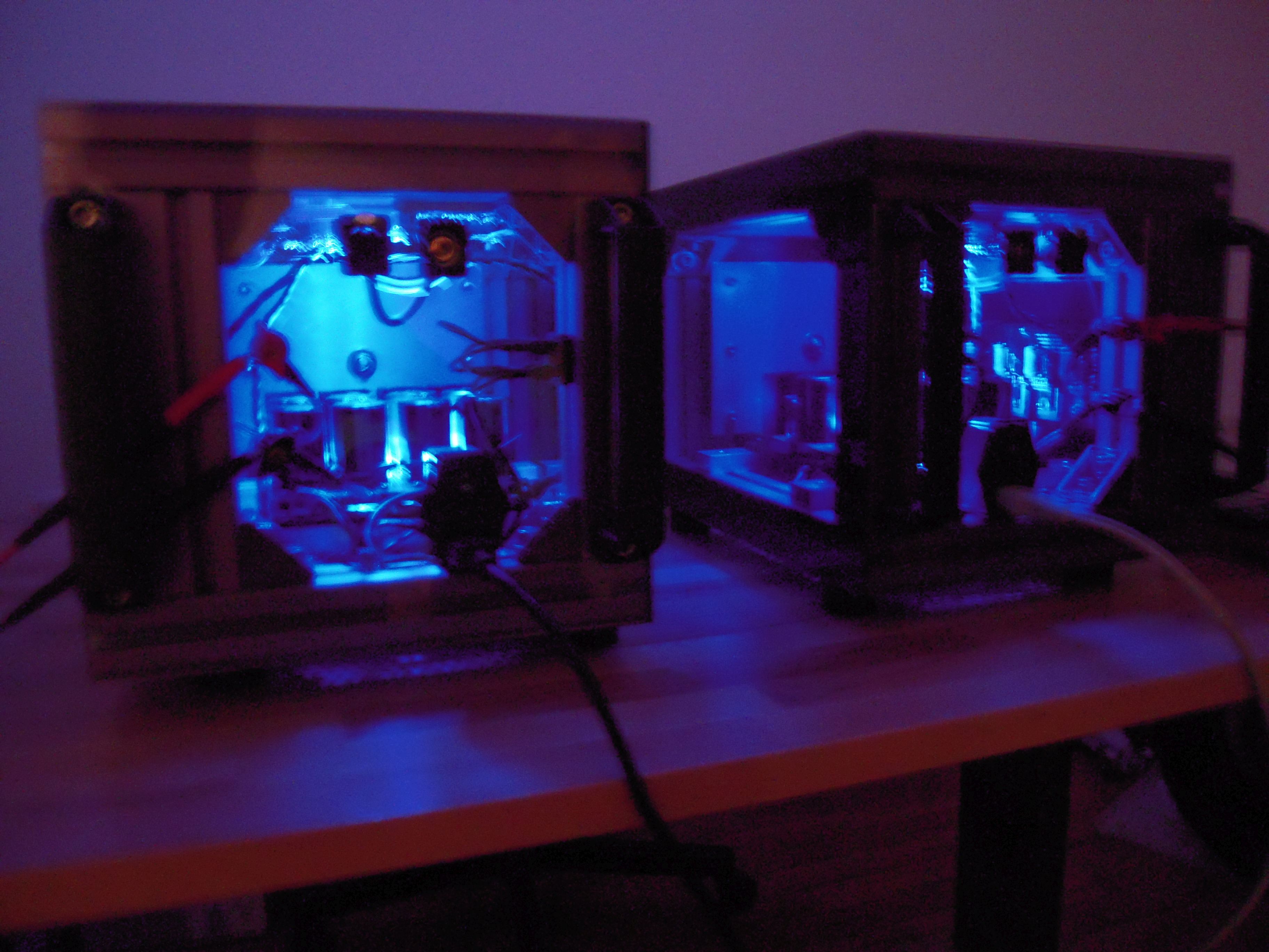

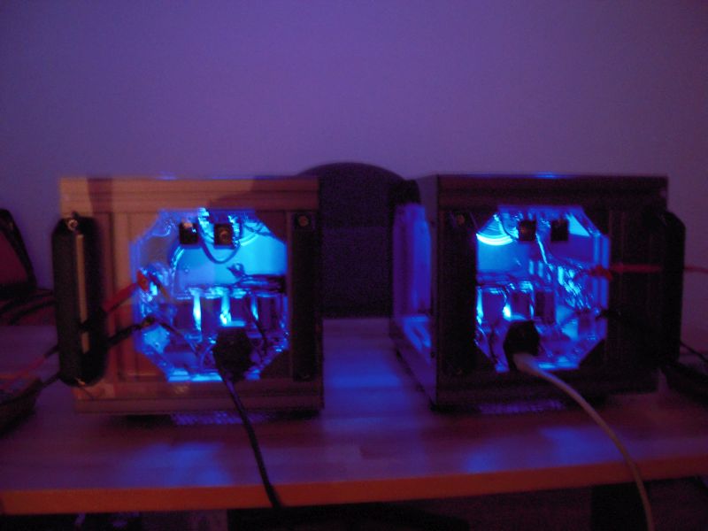

BA-1 Monoblocks
And if you like the colour 'blue'.
Should I listen to a recording from blue note records?...🙄
Greets
Dirk
BA-1 is a hot amp! :redhot:
- heatsinks after 60 minutes at 54 C temp...
