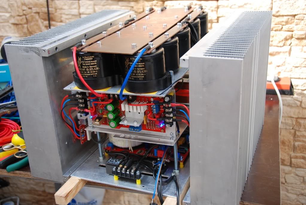

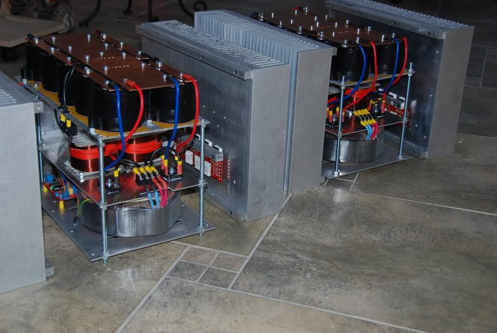

Under the capacitors you find the two 600VA transformers.
You can see it on the picture.
The complete weight is 51,4 kg
The torobars are cooled because the high current (7A).
They are thermally coupled with the U-shaped Heatsink. You see it grey between coils and the Heatsink.
The black heatsinks over the coils are for the softrecovery rectifiers. They need good cooling.
