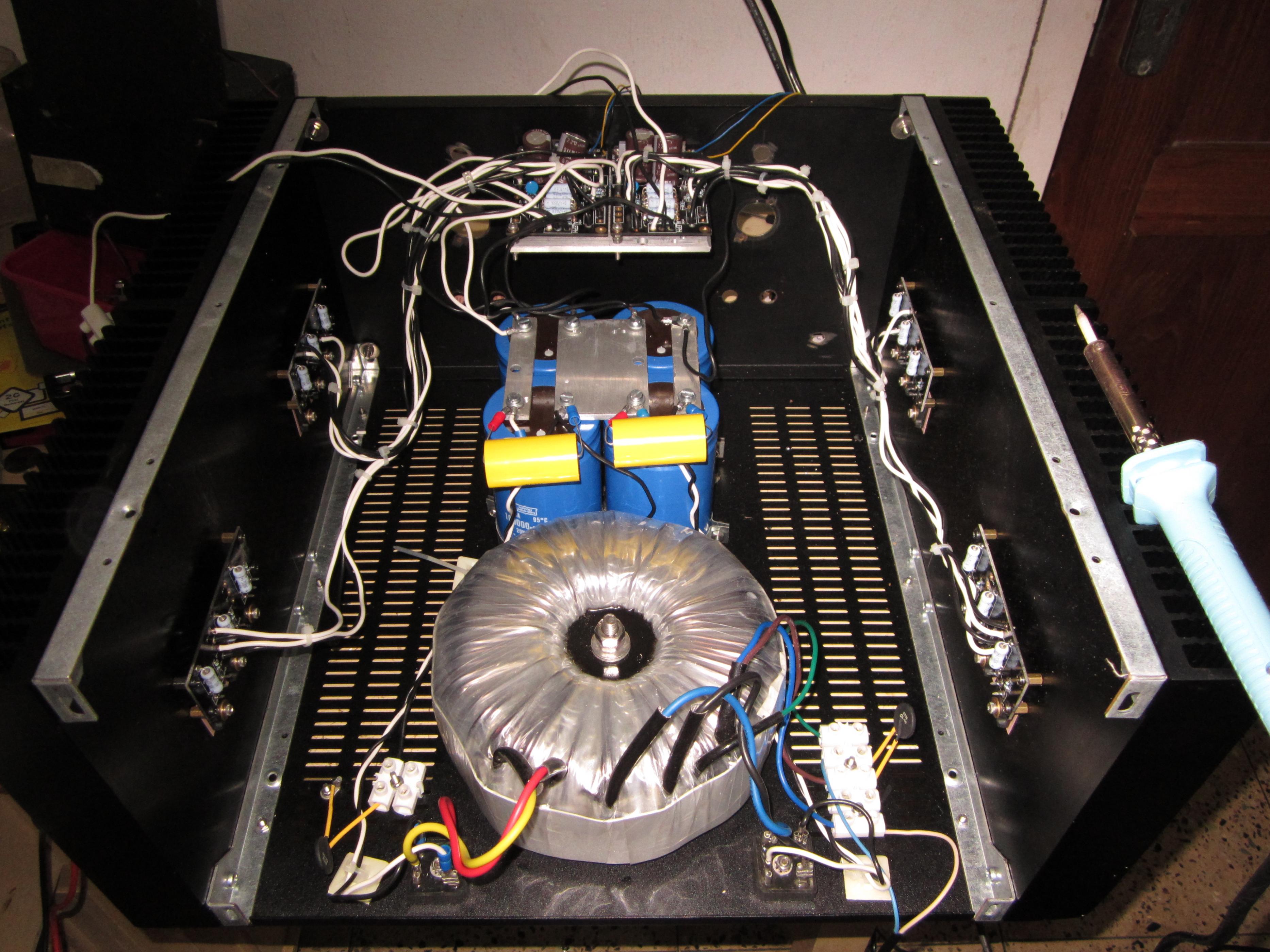

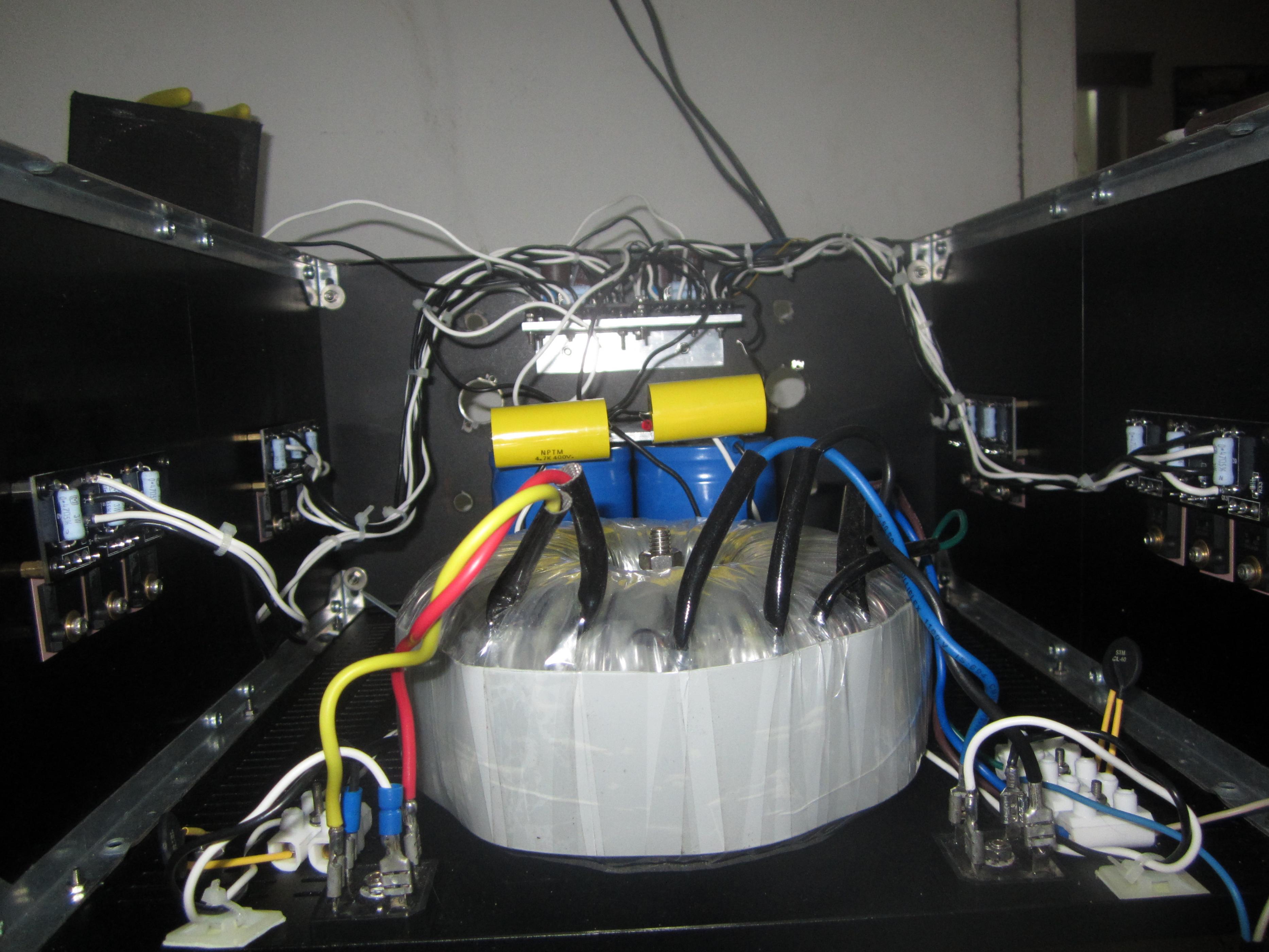

Remember to make the cables from the regulator board to the B1 as short as possible for best performance. Inductance of long cabling its no good at all for regulation.
What is the purpose of the smallest board placed between the softstart and the switch?
Smallest board
Hi regiregi22,
The power cable from the PSU to the B1 is only 8cm long.
That small pcb is just a tiny power supply for the input switch unit. It needs 12 to 15VDC and the big PSU is 22 VDC. So I needed a small one(Velleman) to reduce power from 22VDC to 15VDC.
Hi regiregi22,
yet, all standard wall plug extern power supplies work that way
but for best performance, I guess you are right

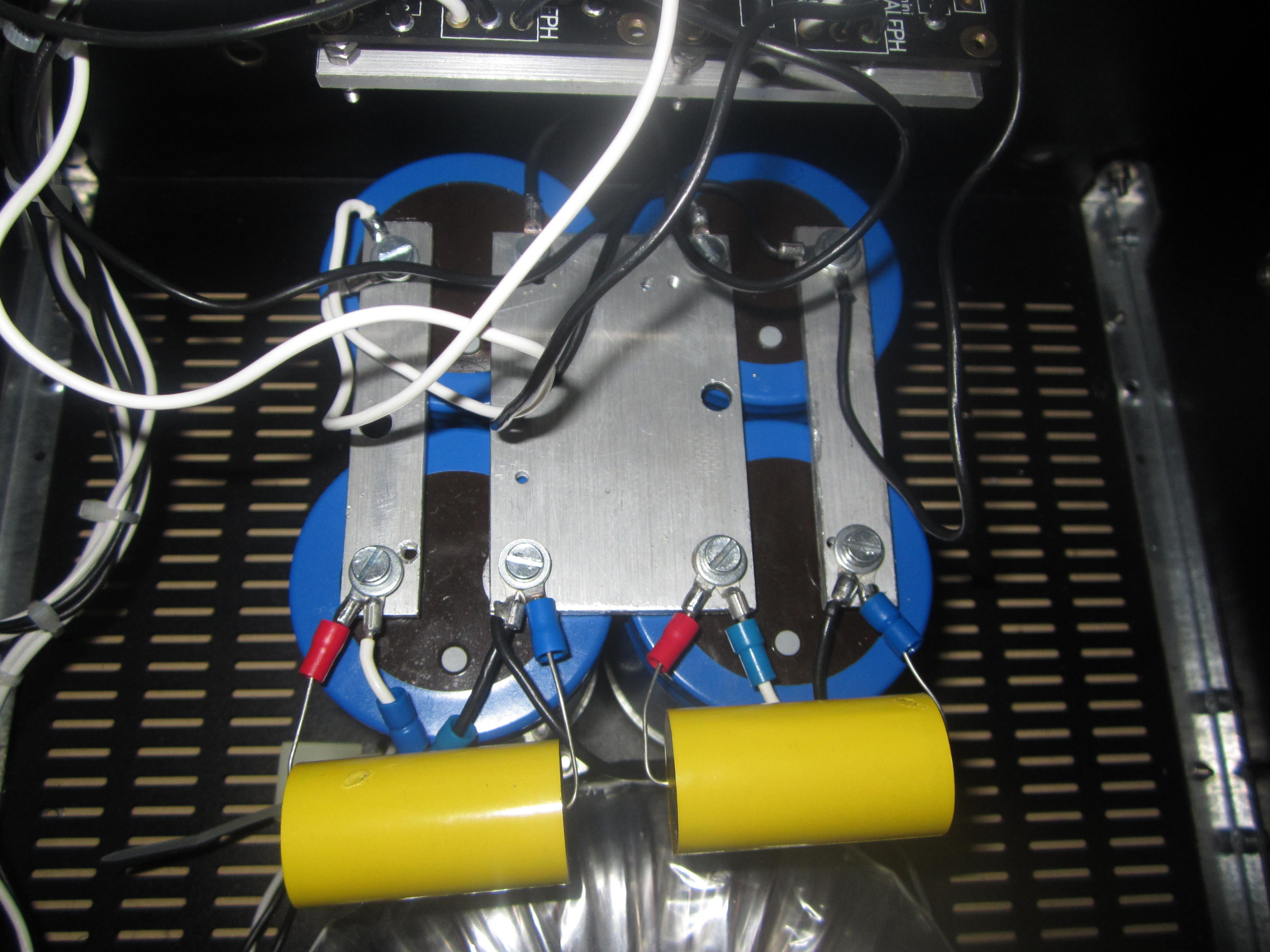

The B1 will operate without a regulated supply.
It does not need a regulated supply.
It does need a low mains ripple supply.
Unregulated can give a low ripple supply.
That is what the standard B1 shows. An enormous filter capacitor for a tiny quiescent current.

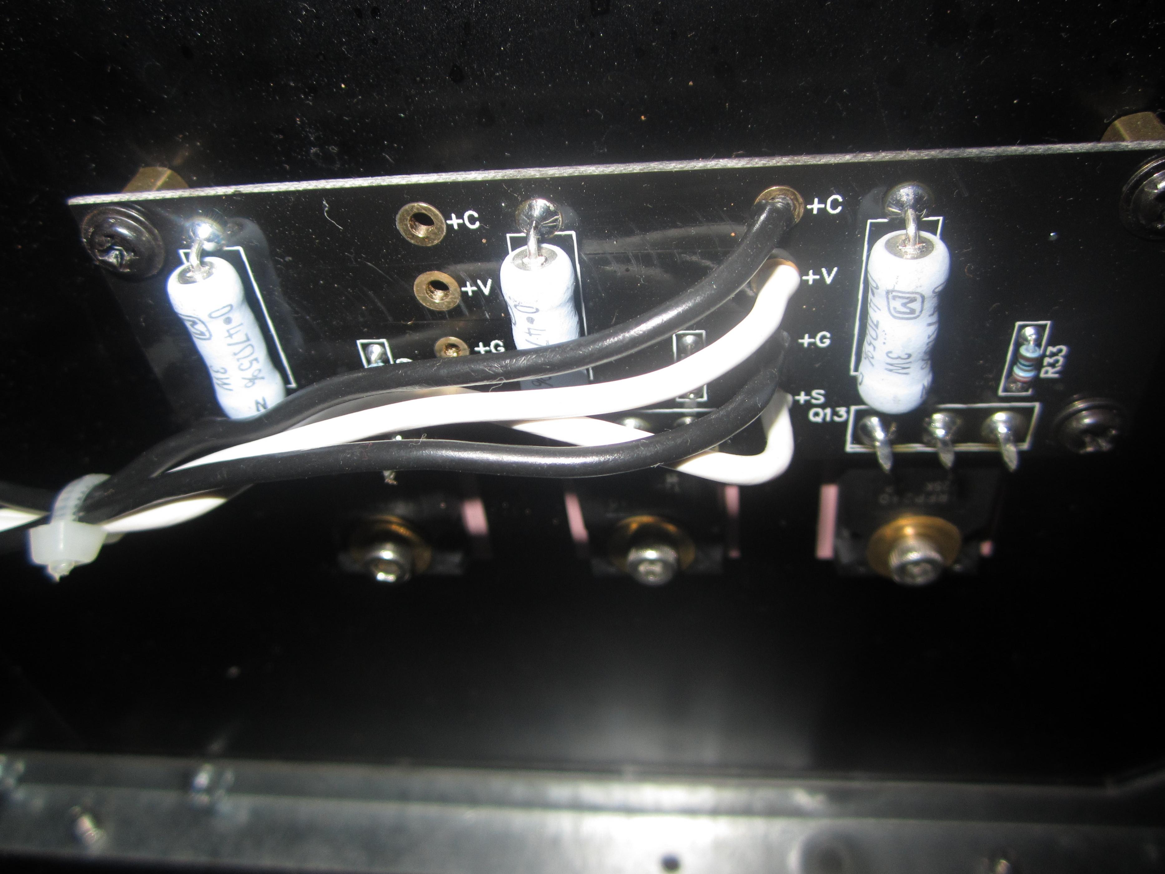

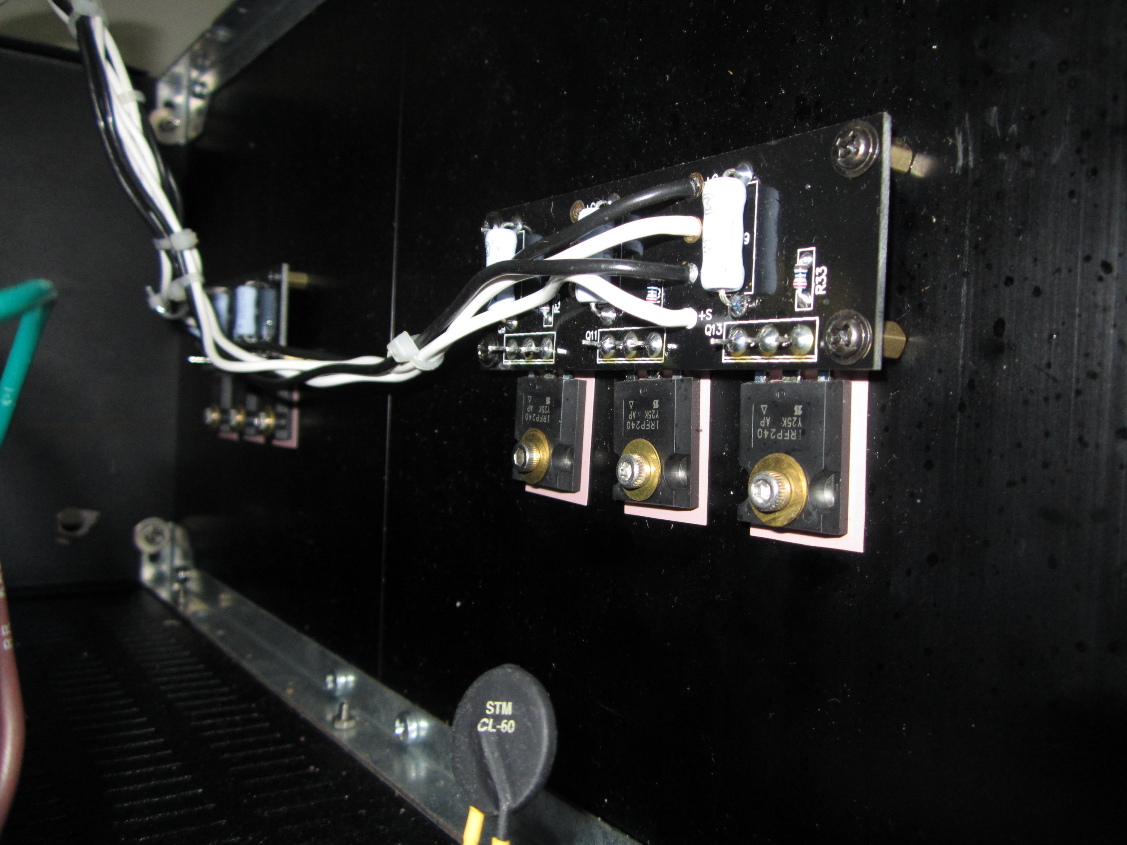

Does it work without oscillating? I wouldn't dare to connect my MOSFETs with such long wires.
Hmm, then I must probably give up my fear!
I was thinking of extending the MOSFETs wires for my AlephJ with 7 cm, so I can place them optimal at the heatsinks I bought.
Walter
Walter
