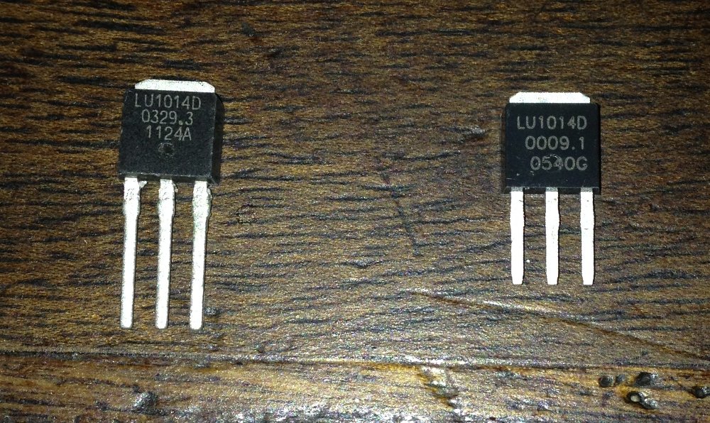

It sounded like some people were having luck buying LD1014s off eBay, so I ordered a batch and got these instead. Funny, I didn't know IR made power jfets.
I did a mini-curve trace: I measured ID at 4 different Vgs. IIRC the threshold Vgs didn't match so I didn't really have to determine if the curves matched or not.
