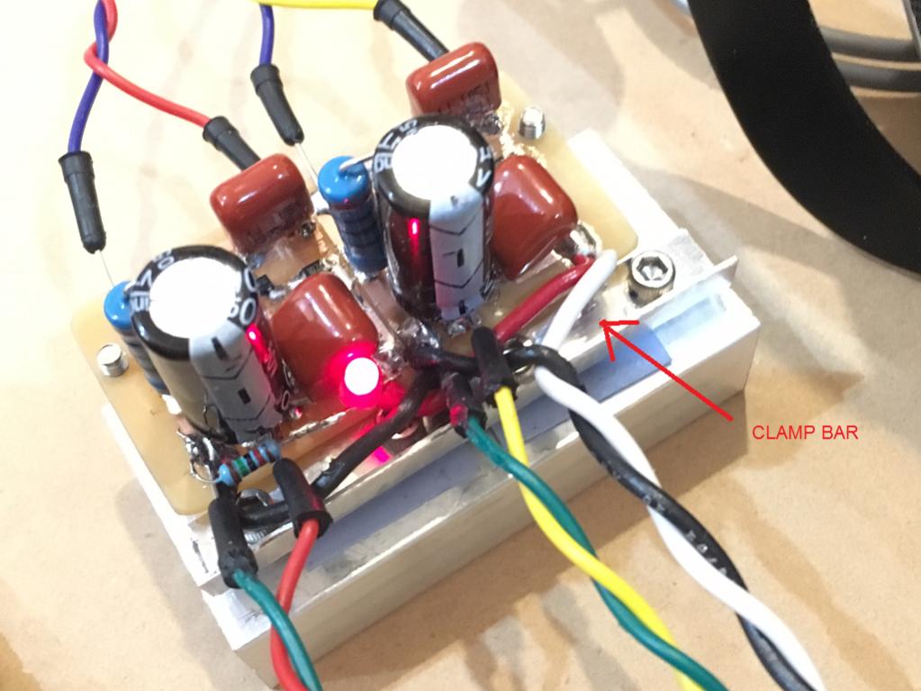

Here is a photo of one of mine (it has been used and removed from an older project so looks a little beat up). These are a pain to make a heatsink mount as you need a two-bolt arrangement and a metal clamp bar across to press it down.
I do not know if mine are real but they sound quite nice. Thanks for mentioning the Aksa HA - it is certainly a worthwhile project, simplicity aside, as it sounds great.
Here is the 4 bolt "L" bracket clamp bar I made out of a small strip of sheet aluminum. I made the L cross section by bending it in a vise with a hammer. Then drilled 4 holes to match screw locations on heatsink. Be sure to use a silicone heat pad for best heat transfer and to insulate electrically.
I suppose in production these are soldered directly to a copper plate for heat transfer.

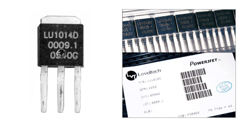

Deep Surplus has an image of the parts on their page. Forum members have trusted their stock to be genuine for some time now.

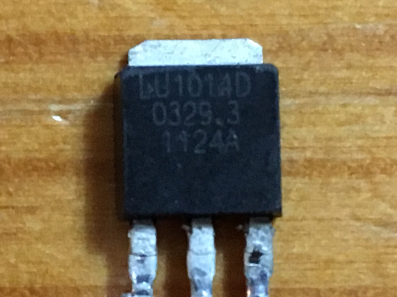

These are genuine, bought them from steenoe back in 2006:

@X thanks for the pictures, if possible, could you perhaps take just one more picture of the back side of it as the pattern of the metal-flange is quite valuable to know in order to discern a genuine from others.

Interesting thing though is that, your transistor 2nd and 3rd row have the same data as these ones from this link (attached as 1st picture):
https://www.aliexpress.com/item/LU1014D-FAGOR-TO-251/32517128837.html?spm=2114.43010208.4.16.fmvSjz
One of them should be manufacturing date, I guess it is the 3rd row, where 1124 would be year 2011, week 24.
EDIT: Yes indeed 3rd row is the date, D/C means Date Code, see the 2nd picture sticker saying D/C: 0540G, same as transistor marking.
Does anyone know for how long time LU1014D have been out of production?
2nd picture attached (from Deep Surplus) reveals that the 2nd row is the LOT number, look carefully where it says LOT: 0009.1 on the sticker.

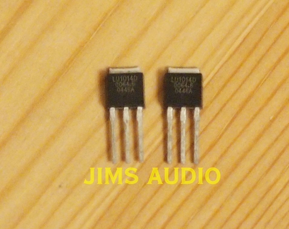

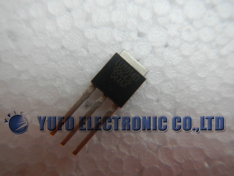

I will attach 2 more pictures for future reference, they were found on eBay and AliExpress.

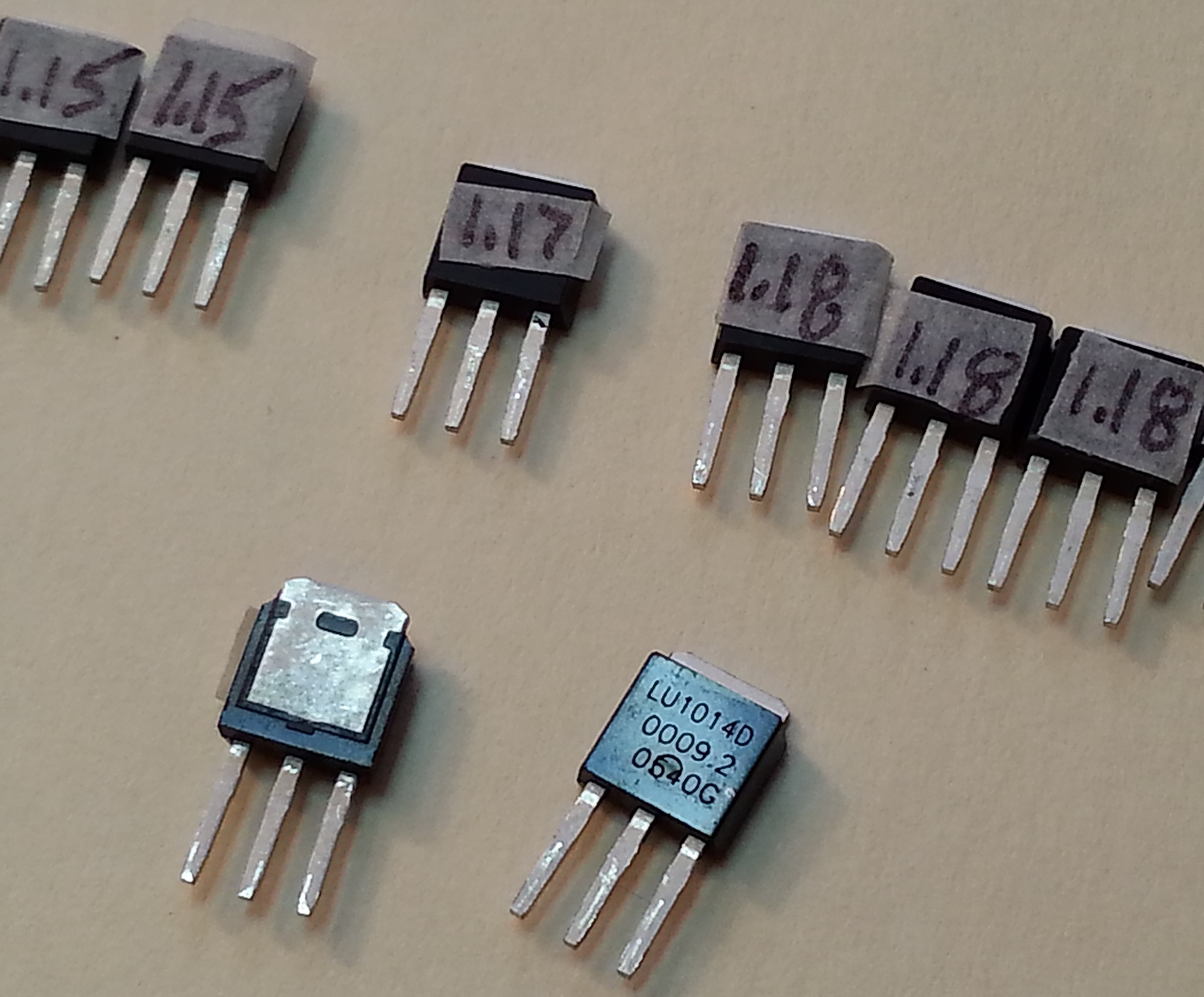

Here's a picture front and back
Thanks BDP for a great picture, it's worth to note yours are the only ones next to the picture from Deep Surplus web page which have the 3 rows of text marking right aligned, as can also be seen in Lovoltech's datasheet technical drawing, and there's more space in between the rows, all the other ones have their text center oriented and more tightly squeezed together.
Thanks also N.P.!

Looking at a previous post, this photo exactly matches mine, numbers and all.
