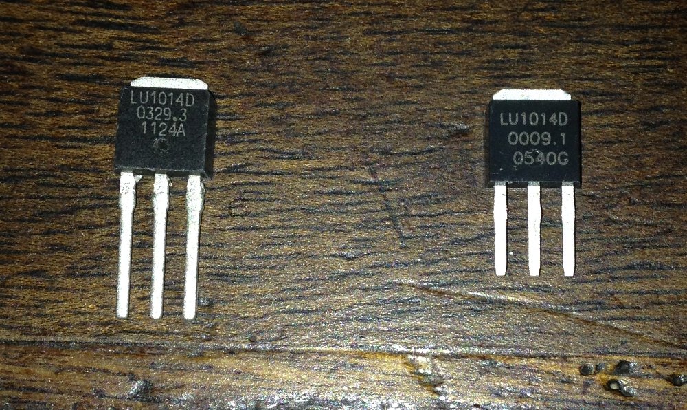

Well, I finally got the parts from China to compare with the ones Nelson graciously sent me. Chinese versions on left; genuine NOS on right.
Note the round dent in the cases; the Chinese part is a bit shallower, and the rest of the face a bit rougher. The lettering font doesn't quite match. I'd bet money that they're genuine parts, removed from old equipment, new legs welded on, and the fronts sanded and re-lettered.
I guess their "New" claim refers only to the legs and lettering.

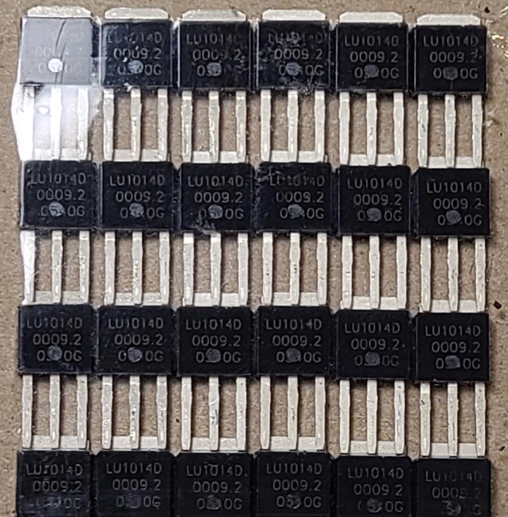

Make sure to test for gate leakage before proceeding too far.How about 'Beast of a Dozen Power JFETS'
Maybe even a beast of two dozen Js. LOL

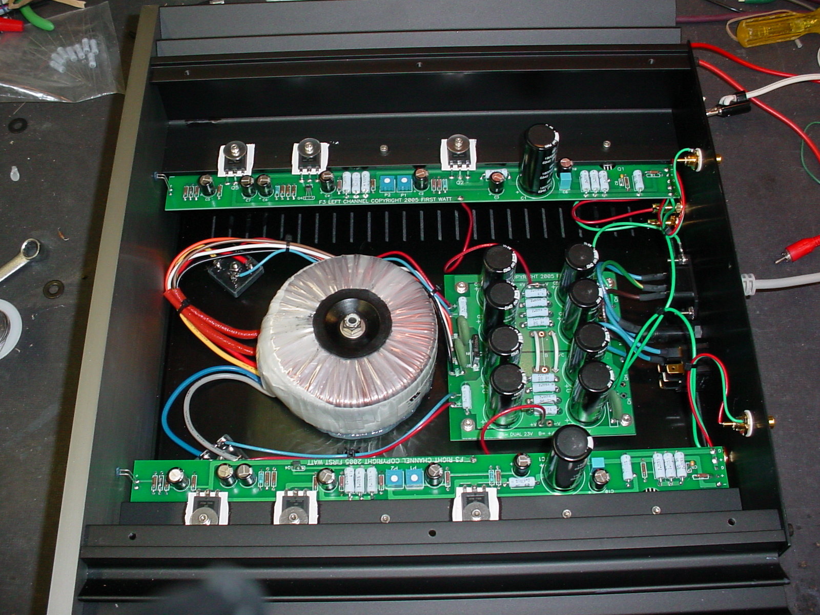

But seriously I wonder what the F3 is like compared to the M2x.
Greedy Boy, you already know how to answer that
I bought a batch of 100 from eBay China. Curve traced every one. The price was attractive and the results a true bargain.
These are not just JFETs. They are SITs at low current. The datasheet max continuous current is 50A. At 50A, the behavior is more like a garden variety JFET with pentode-ish curves. At 1A and below, they are SIT triode-ish curves.
I have ideas, most of them wrong, and I lack the knowledge to implement or test new circuits. So every bit helps...
The F3 does look rather complicated and involves tweaking the circuit to fit the part characteristics. I read some of the files NP posted earlier.
