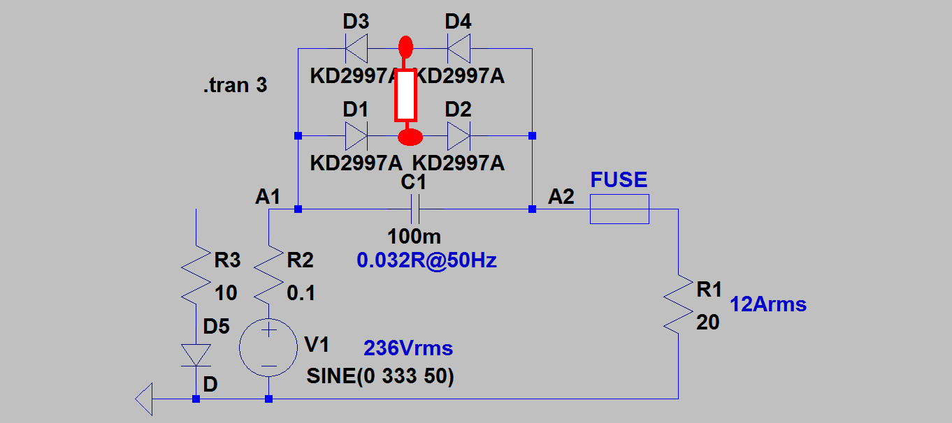

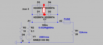

If a diode fails short, then not too much really happens. The dc passes, so the blocker no longer works. But the cap isn't affected, as it's "protected" by a short across it.
So in case of one of the diodes failing short, all that happens is the dc blocker no longer blocks dc, that's all. The toroid will complain if dc is present, which hopefully will prompt the "tech" to investigate and root out the culprit.
It can happen. Things can go wrong in various ways. I have spent some time investigating incidents and defects. I count on every part to possibly fail and what may occur if it happens. Had too many thyristors, IGBTs and other parts blown to pieces without no apparent cause (at first).
To illustrate, if a bridge is used this way, with the + & - shorted, as it's usually done, and also both ~ ends shorted as well, we get 2+2 diodes worth..
Only a single drop instead of 2, and double the current capacity.
Requires a larger cap though, to keep things proper, but still very low voltage.

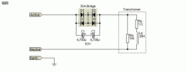

It is NOT usually done like that. They are normally used in anti parallel config in series with another set of anti parallel diodes.

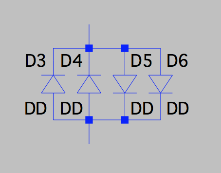

If all four diodes were equal (identical device characteristic, same temperature, same current, etc.) the current through Rred would be zero. In reality the diodes won't be identical - even if they're all part of the same diode bridge - so some current will flow in Rred.
It wouldn't surprise me if you could find an optimal value for Rred that would compensate for the imbalance in the bridge. I would be surprised it the difference was large, though.

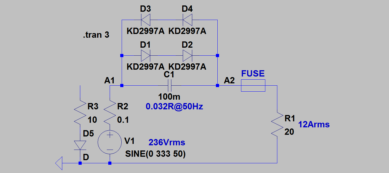

What do you put in front of amplifier input to remove DC ? Capacitor or diodes ?
Simulation run 30 sec
NO DC component, SINE(0 333 50)
Fourier components of V(a1)
DC component:0.0297197
Fourier components of V(a2)
DC component:0.0103036

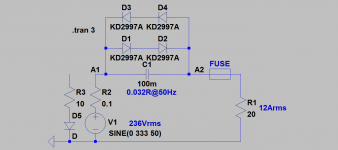

Then I add "normal" DC +10V, SINE(10 333 50)
DC component:10.4661
DC component:9.68967

I completely agreeIf one of the diodes fails and becomes an open circuit, then the capacitor is unprotected in one direction, and the capacitor will explode.
Besides, how does a diode usually fail? Rarely anything other than a short.. So high voltage isn't what happens then, but rather nearly nothing. And it still fails regardless.
As a rule, semi's rarely fail open; there are some exceptions though: if the current is high enough, some parts of the diode may act as a fuse, especially the bonding wire if present. For that reason, epoxy encapsulated diodes are more reliable than metal types, because the bonding wire surrounded by the molding compound doesn't melt as easily, but even better is the metallurgical bond where there is no wire at all.How often does a diode fail open rather than a short?
Epoxy-encapsulated devices can suffer from other problems: the thermally-induced stress can make the bonding fail open, thus metallurgical types are the best option (never 100.000% safe though)
In general, for current-sharing yes, but here the supplementary device acts as a safety net for the first one: if it happens to fail, the second one will prevent an open circuit.The paralleling of diodes for higher current rating is a bad idea.
If the current is sufficient to vaporize the first diode, it could also do the same with the second, but in fact this is not true: under gross overload conditions, the Vbe mismatches completely vanish and Vf is determined solely by the purely ohmic resistances which normally match rather well between identical devices, meaning the effective surge current will be ~doubled.
Of course, doubling the diodes will also square the natural failure rate of a single diode: if the the failure rate is 0.1% under certain conditions for one diode, it will fall to 1ppm for two diodes, thus it is beneficial

now asymmetric load, dc in ac
R3=10ohm
DC component:-0.624333
DC component:-0.120614
R3=3ohm
DC component:-2.85073
DC component:-2.18409
Put 4 diodes in series and large cap (low imp) then can help.
or use big cap for mains voltage and no diodes at all ��
