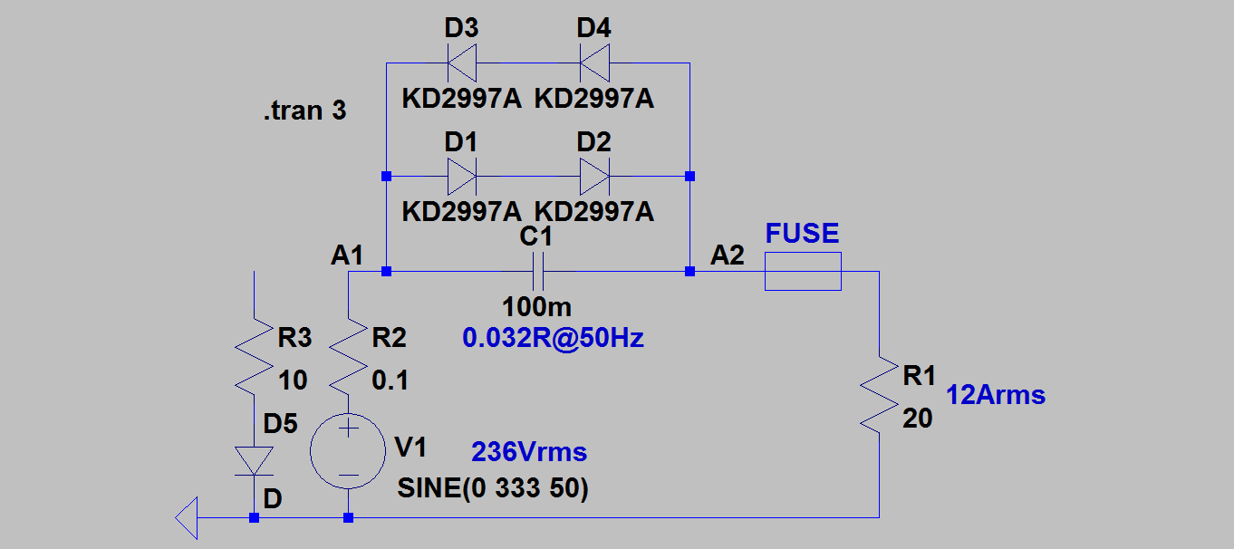

Let's take a 2kVA toroid, which would draw something like 8.5A at full load (rms). Why would it have to be done so all of that flows only through the caps and not through the diodes, and only fault currents would ever pass through the diodes???
I see nothing wrong with having at least some of the normal current going through the diodes, which at the same time puts a limit to how much goes through the caps, which limits their stress.
I was only referring to what many have been calculating for, thinking it MUST be done that way, but I just don't see the valid reason behind it.
100mF is the value I had calculated earlier, aiming for supercaps use, if that could be done, and making sure all the normal current would flow through the caps and only anything beyond would go through the diodes.
But that's not necessarily the goal to reach. There is no need to make sure that ALL of the normal current goes through only the caps. The diodes can also pass some of it in normal condition. There is no good reason that I can see against that.
The real goal is to remove as much as possible of the DC from the mains, to keep the toroids happy and silent.
And that is why I was looking at only one diode's drop and not 2 to introduce, and even make use of schottky to reduce that drop.

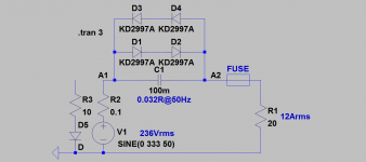

I've been doing sims like this too. Trying various values, but I'm putting only one diode, not 2 in series.
And I didn't insert any R2 res in the mains. I don't think the mains impedance plays that much of a role there anyway.
The fuse should be the very first thing in line for sure.

For diodes, since they are in reverse parallel, they never ever "see" anything beyond their drops, both ways, so not only the cap is never exposed to anything harmful, the diodes also never see any significant voltage, so thinking about the mains voltage and trying to size them up for that, with extra margin, looks pointless.
And I'm also referring to the current passing through them which does need to be taken into account, while the voltage isn't an issue for them.

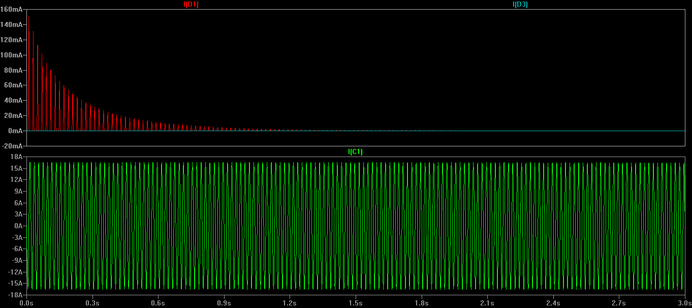

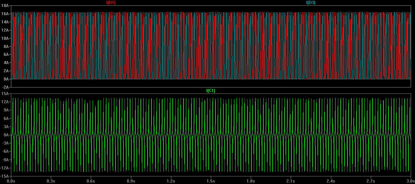

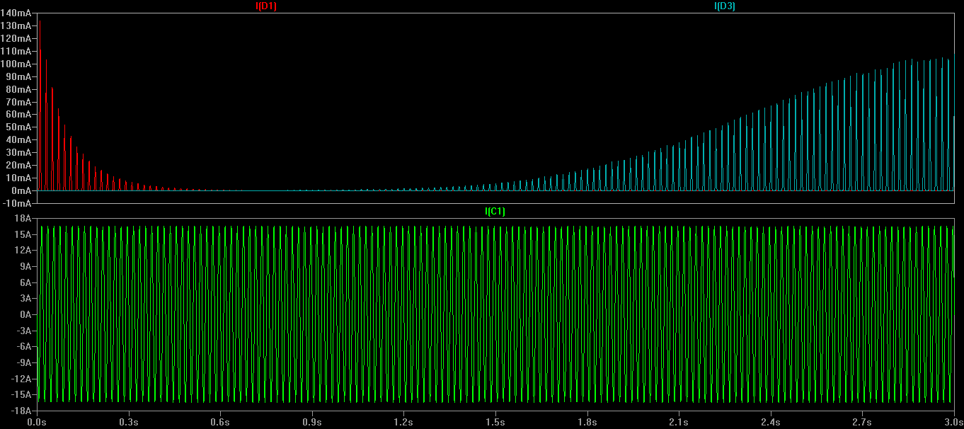

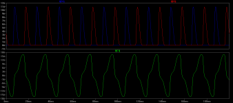

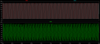

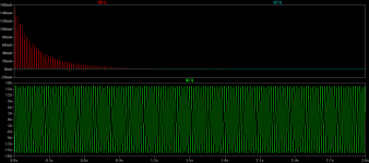

LKA, can you please show simulation for 30mF? For both normal operation and one half of sine wave loaded by 10R to create DC.
Thank you in advance.

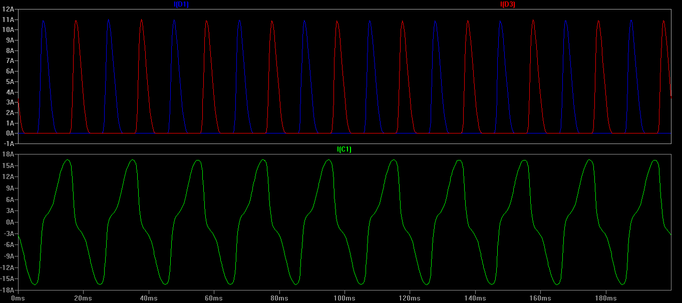

C1=30mF (imp 0.1R at 50Hz), in both cases traces look similar
12Arms is cc 16.5Apeak, the voltage drop across a cap is 16.5*0.1=1.56Vpeak, greater than two diode drops 2*0.6V=1.2V, so diodes will conduct for some preriod
of course, 30mF is good value when less current flows
- capacitor filters the dc, not diodes
- diodes protect the capacitor, handles transients and a portion of a flowing current when voltage drop across the capacitor exceeds diodes forward voltage
- capacitor should be high-current type
- diodes should have 35A/400V rating

35A / 20V rating is perfectly adequate since the none of the diodes is ever reverse biased by 3 volts, never mind 400 volts.
D3+D4 protect D1+D2 from reverse bias.
D1+D2 protect D3+D4 from reverse bias.

They are mutually clamping the voltage, at all times, even when currents are very high, although the drop will climb with the high currents, it will never be more than a few volts at the very worst. No need for any high voltage diodes at all. Only good current carrying types.
And I was experimenting (sim) with the usage of a bridge that would have not just the + and - shorted to put the diodes in antiparallel, but also both ~ sides could be shorted as well, putting all 4 diodes in the bridge in parallel, 2 by 2 in antiparallel. Doubling the current capacity while cutting in half the total drop.
